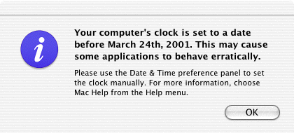

Well I got my Pismo running...
Hi folks;
After a few months I finally replaced all the major components from the MB up. Even the Pram battery. It works but still a bit of a funk. Sometimes after closing the book, and then reopening, the comp shuts itself down?? When rebooting, I will get the clock error, (see attachment) even though I have replaced the PRAM battery and the clock is keeping accurate time?? And sometimes, a get a black rectangle while at the grey screen then it shuts down. Hmm...otherwise the PB runs fine, although my main batt is getting over the hill.😕

Dead battery- not so dead
I stumbled onto this thread and it inspired me to grab my old Pismo and see if it would still fire-up. It hadn't been used for over 4 years.
Sure enough the main battery was dead flat and I didn't get any sign of life when I tried to power-up with the power supply plugged in. I was pretty sure the battery had died. I went through the usual reset routines and nothing worked until I did the following:
Disconnected the power
Removed the battery
Disconnected the PRAM battery (under the keyboard)
Pressed and held the reset button for 5 seconds
Then I reconnected everything and to my amazement the little beauty fired up! Not only did it start but it's sitting beside me on the desk right now and the battery is showing it is 3/4 charged after about 3 hours. 🙂
Now I'm trying to remember where to reset all the parameters in OS 9! It took some time to recall having to go through the Chooser to access shared drives on my network. Ahh, the joys of OS 9....
