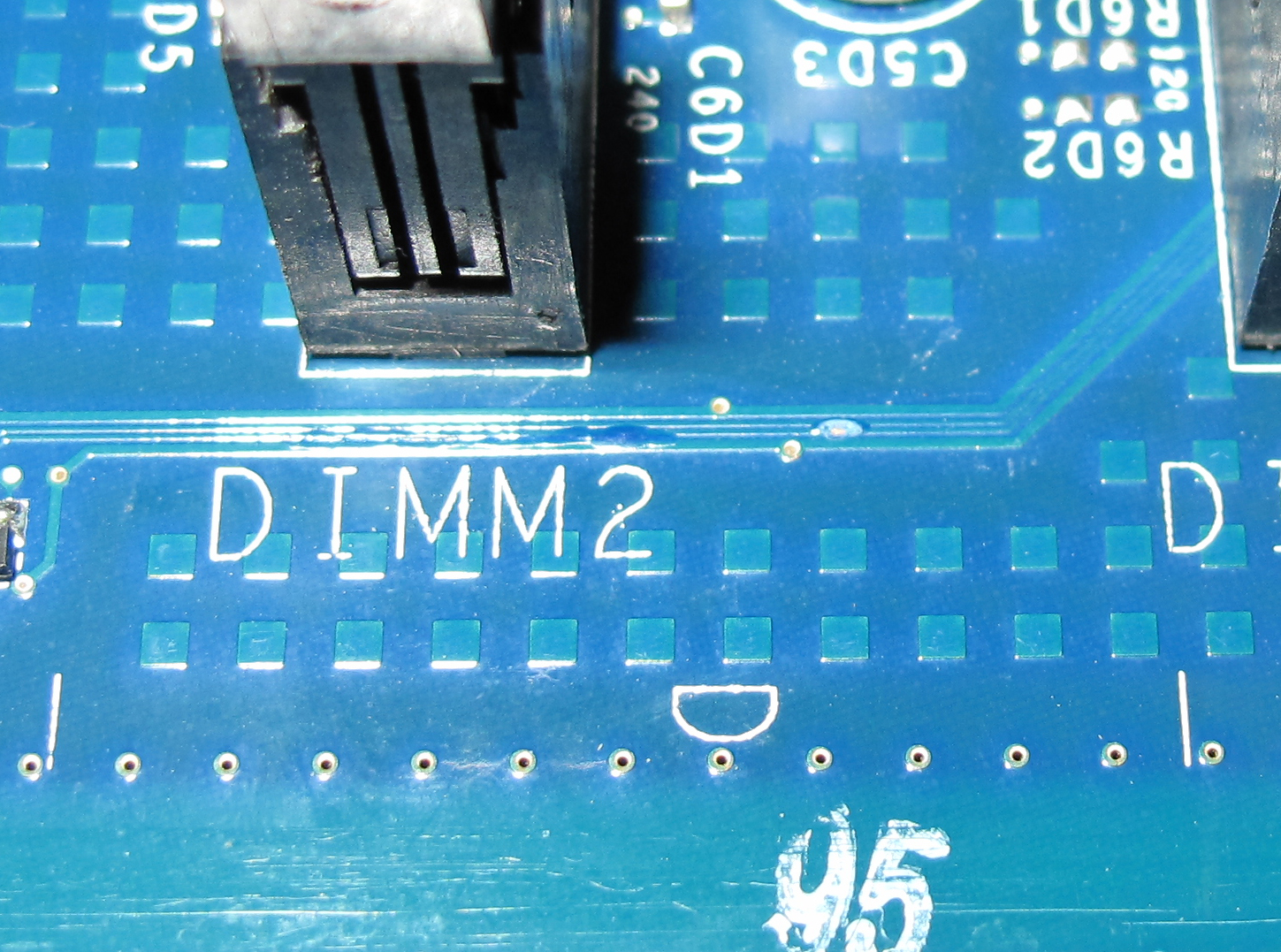

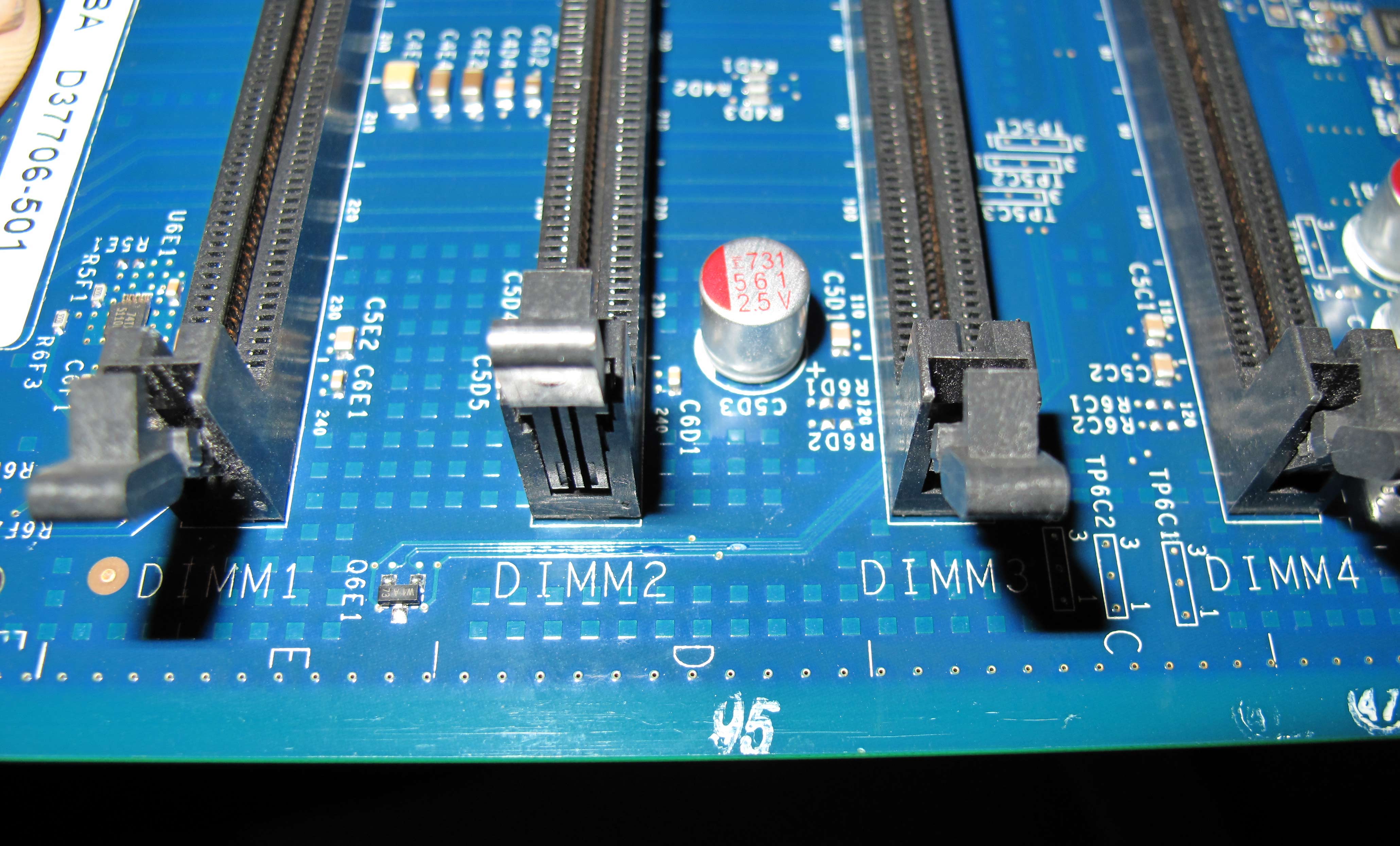

The Mac was dead to the world, not a glimmer of an LED to give away trickle current, no response whatsoever to pushing the "on" button, etc.
I started yanking the RAM boards and noticed when I pulled the lower one a red LED lit briefly on the logicboard.
First sign of life in hours.
Turns out that Mac will boot and run normally as long as RAM riser is out.
If I insert it and try to start....back to DOA. So something on riser seems to be a dead short.
I yanked it out and in the darkness it appears some traces have melted/lifted /shorted. There is also a choke coil that looks a little dodgy but I am fairly certain these are bad traces in pic.

Ouch! It looks like the finish may have been HASL (Hot Air Solder Leveling), got too hot, and bridged. 😱
Have you tested the memory on the dead riser to make sure they didn't get taken out?
