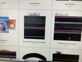

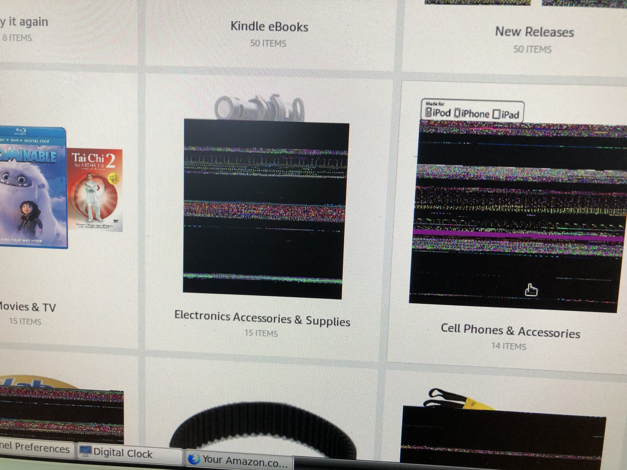

I am getting a an issue with the display it’s kind of like white pixels randomly racing across the screen. Kind of like over the air tv back in the day with an antenna where it skips a scan line or an old vcr tape with tracking issues. And if I leave it in for a long time the display screws up. Even the text characters get garbled. I will take some photos and video. In the meantime any ideas what that is? If I was to guess it’s either the video card is going bad or I don’t have the right drivers?
I'd rule out video card failure. I'm guessing it's a kernel/module bug in newer kernels. My G4 macmini doesn't have this oddity at all, and can even use the 5.4 kernel w/out issue, but i noticed my dual G5 does. It doesn't always happen, but more often than not it does "screen tear" sooner or later. Logging out, then back in solves it for a little longer. I never experienced this with kernel 4.4 on Lubuntu. It might be the same problem that @sparty411 mentioned with AGP gfx cards.

So here is the the video of the screen. Its like flickering noise. Video URL
I've attached a shot of the screen just browsing.
I'm also noticing some lag in the input from keyboard and mouse. Both are USB wired so its not a wireless issue.
Any thoughts?

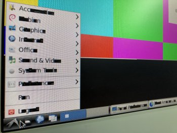

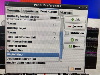

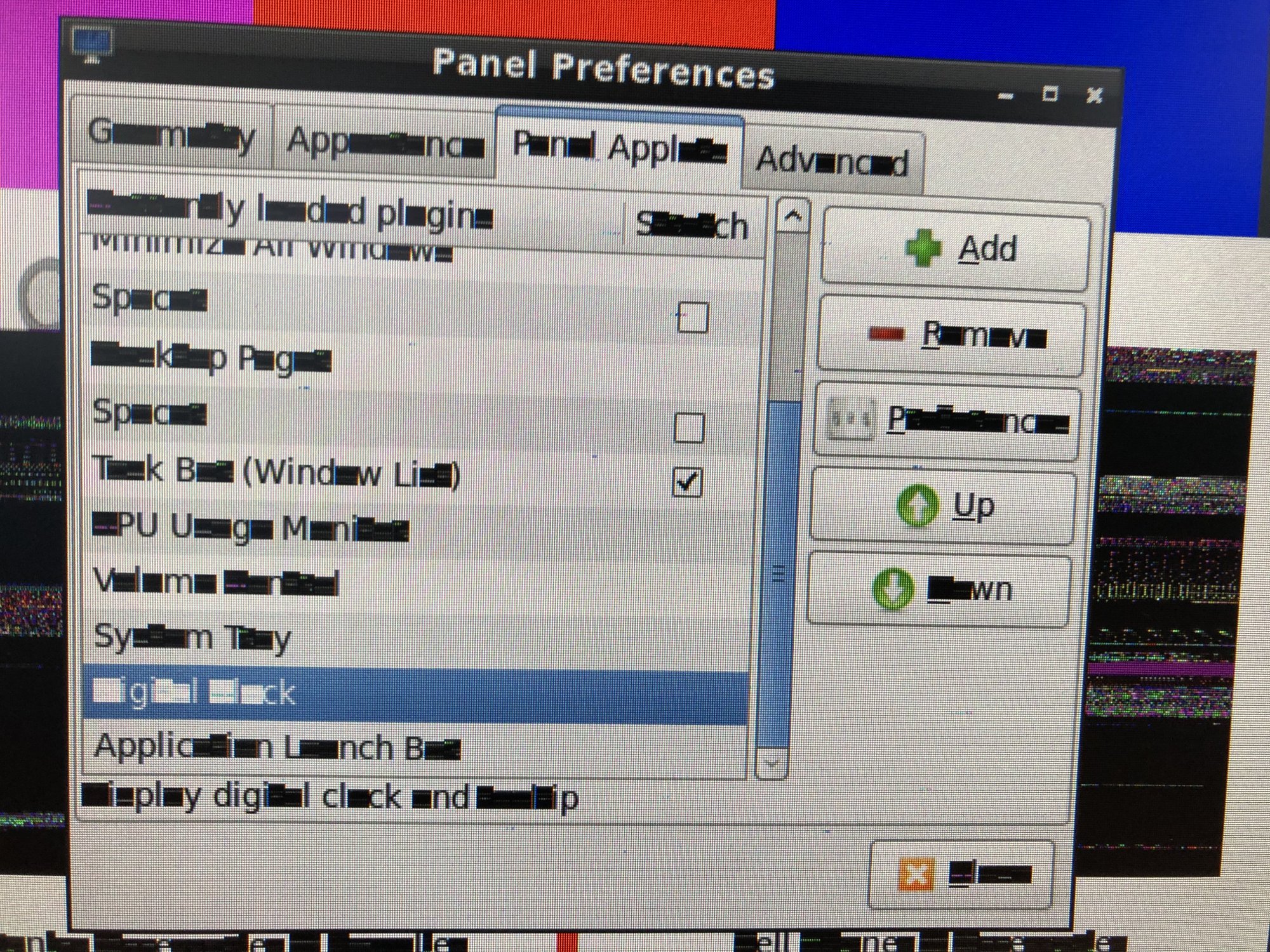

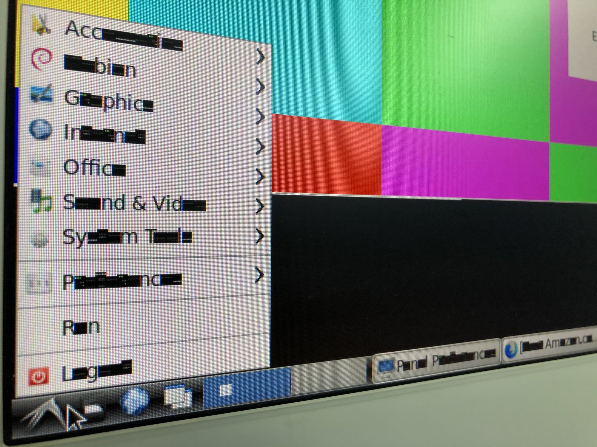

Here is what happens when it sits for awhile. It seems to be running hot too. I downloaded 16.04 iso and will try your suggestion.

Yep, my G5 on Sid has that exact same gfx issue. I'm curious to see if using an older kernel fixes it. Let us know how it goes.
