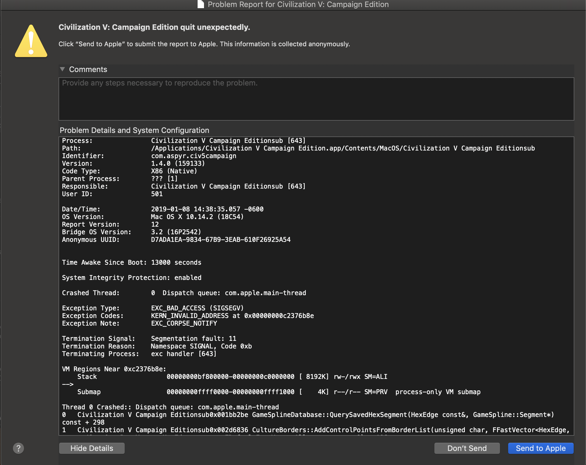

I was playing Civ V, minding my own business, and the game crashed with no warning. I was pretty far along in the game, lots going on. I cannot tell if this was because of a T2 / BridgeOS issue, or if it was just the game itself failing. Any input?
that looks like a normal OS crash. Well not normal, but not bridge os.
