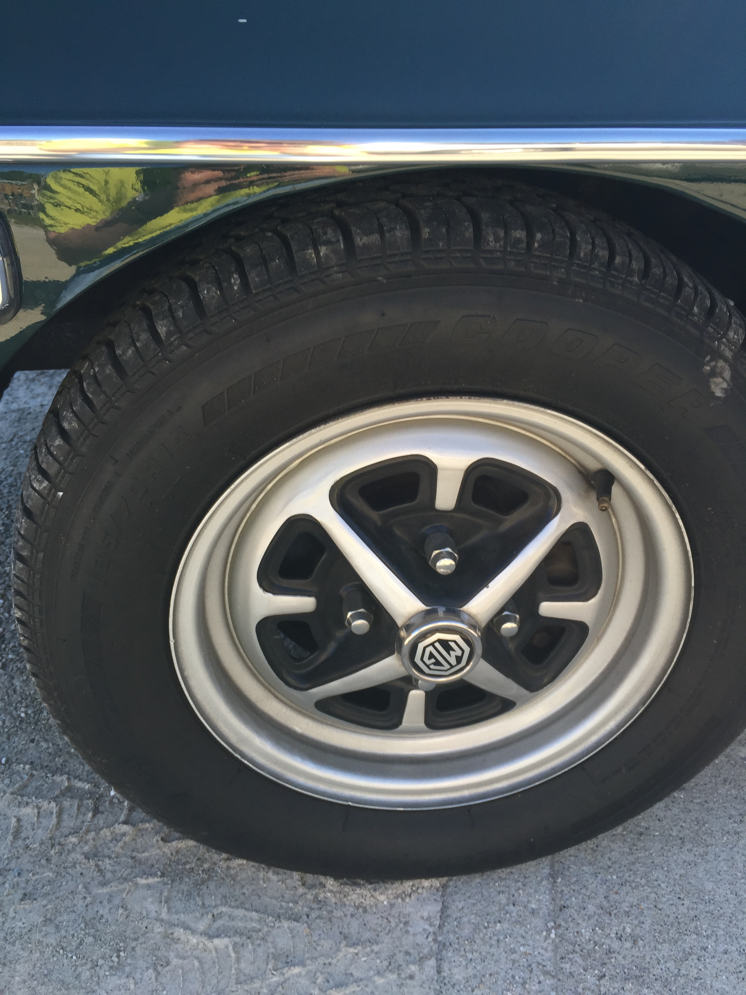

Get steel wheels, if you can. Rally wheels are nice. Wires look beautiful, but it's hard to keep them round.
MG

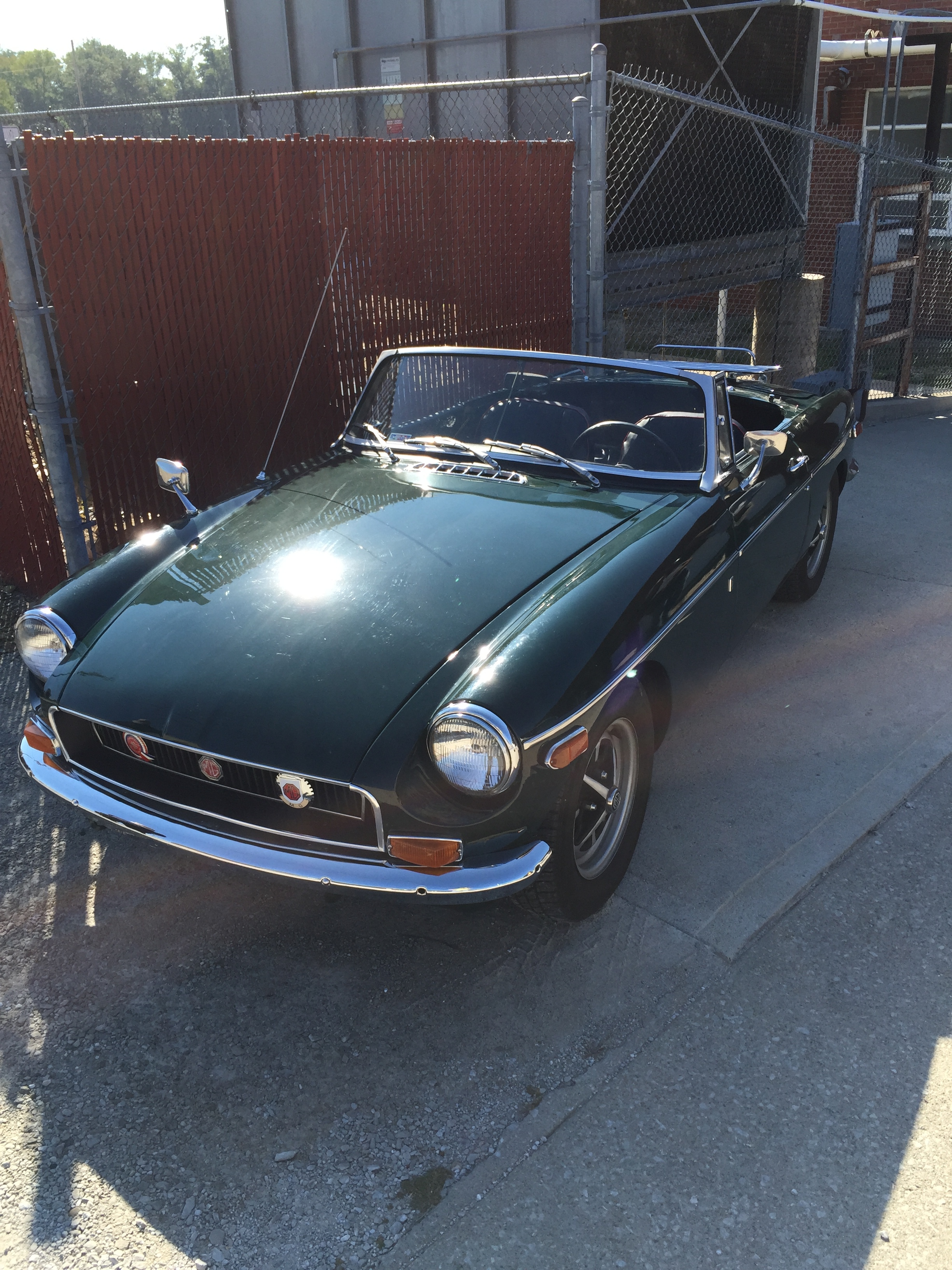

The one I'm buying has steel...although I'm really, really tempted to put wires on it. Unfortunately, the wire conversion is difficult and-from what I've read-if you want to run 185 width tires(which are about all you can find now) you really need a wire wheel rear axle and not a conversion kit.
Sweet. They look so much better without the bumper overriders. Looks restored, or well looked after. Do the curtains match the drapes? Is the British Racing Green inside the engine bay and trunk?
If you wanted to do the rear axle conversion, it wouldn't be that hard, given a decent lift and a friend. I'd drive it for a while, first, enjoy it, and after a time you might not want to mess with it. A lowering kit would be a better investment, in terms of handling, if you ask me, that and a coil-over conversion. The stock dampers are really stone age. You can even get disc brake kits. Then again, the stock car has a certain primitive charm I always liked.
Stainless steel exhaust!

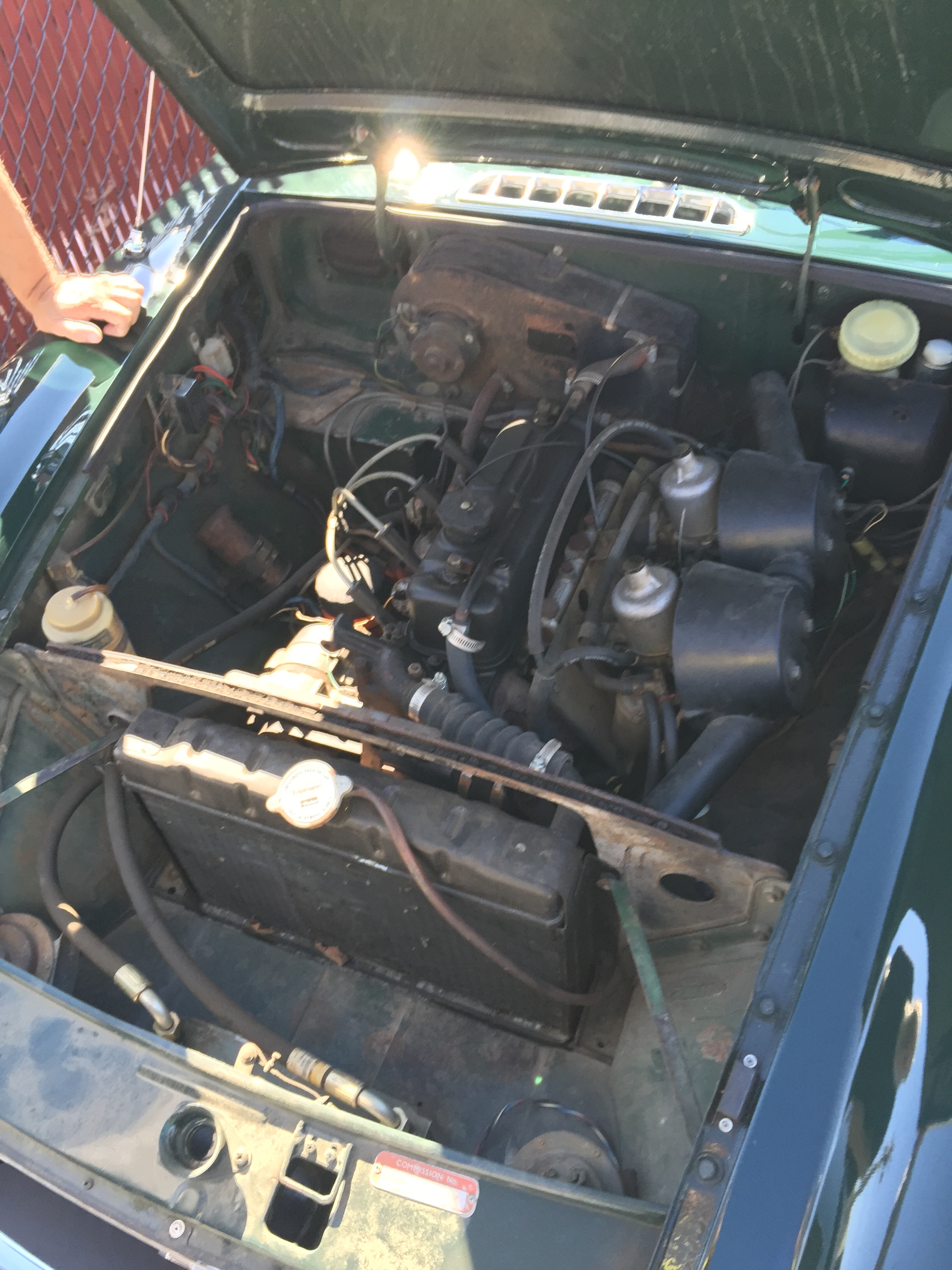

Yes, that one of the things I checked. The engine bay and trunk are all BRG, although the paint is almost too nice to be original and isn't a perfect match for the color in the engine bay. BRG was a mandatory color for me when shopping 🙂
It has a decent number of miles on it, and I really think that it's a car that has been driven/maintained over the years with things done on an "as needed" basis rather than a full all-out restoration. The guy who is selling it redid the seats a few years ago in black with red piping, and they look really nice. It needs a new soft top.
As for lowering-I thought 1970s were already stock "low height cars" aren't they? The car is already pretty darn low-I'm not sure I could drop it any lower without the tires scraping the wheel wells.
BTW, I may change my mind, but I'm pretty set on keeping the SUs for the time being. I know they can be cantankerous, but they are part of the charm for me.
As long as the throttle shafts are solid, then keeping the tune should be a labor of love. You'll need to get a Gunson ColorTune to do it right and in a lesser amount of time (as well as a couple of specialized carb tools mentioned in the official manual). It takes the guesswork out of it.
