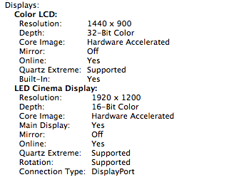

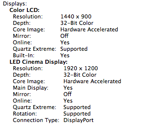

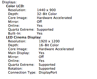

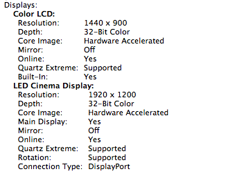

Jof, you can also look at the Graphics/Displays area of System Profiler:
Left is millions; right is thousands.
Yes, I already looked at that. The Intel HD claims to be 32bit. That is absolutely not the case for me; definitely lower.
(Conversely, the 330M doesn't declare color depth, FYI)
[Edit: Fail moment; of course the 330M doesn't show a color depth... its "display" is actually the Intel HD]
Yes, I already looked at that. The Intel HD claims to be 32bit. That is absolutely not the case for me. It's 16bit-like.
