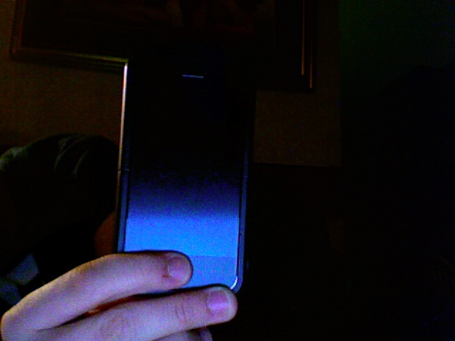

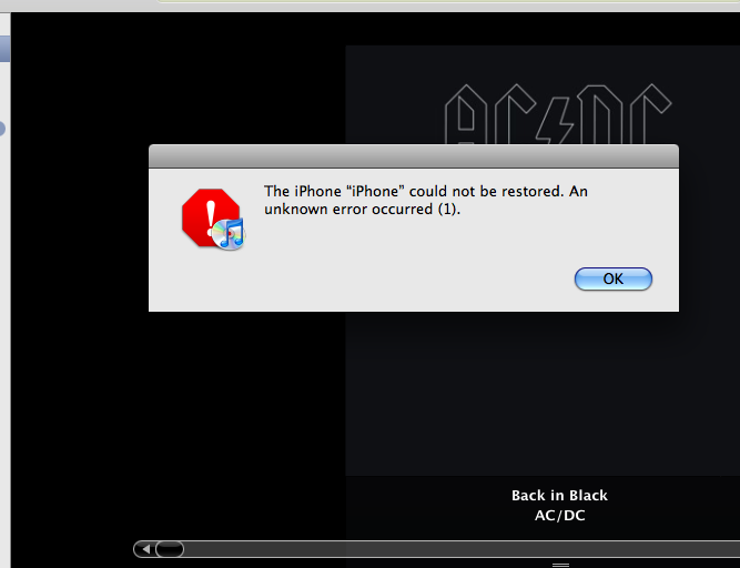

I am getting the black DFU screen... but im still getting error 1...(see pictures)
