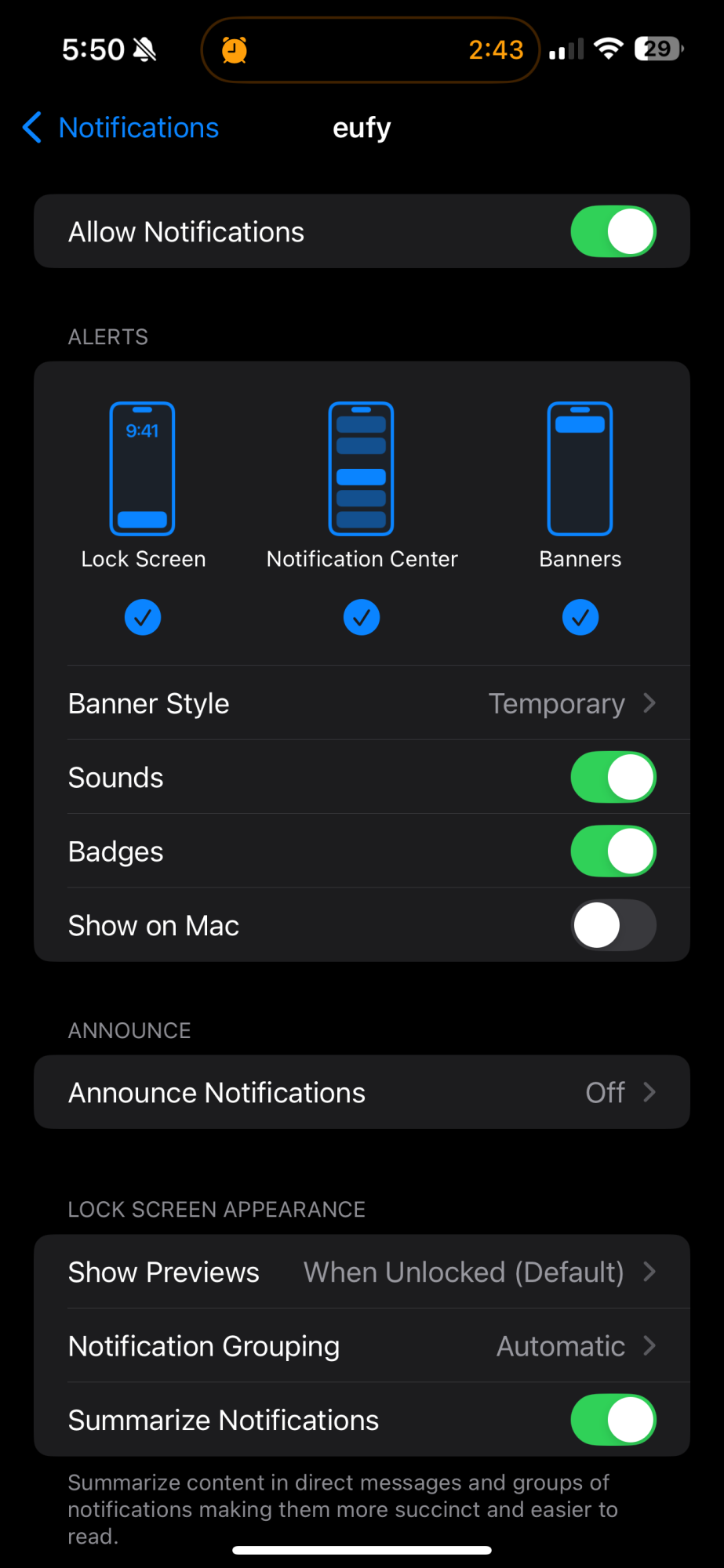

Turning off “show on Mac” in the notifications settings for an app in the iOS settings app did it for me
