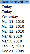

Then sort your mail by date received and use the arrows? Not sure what the problem is here.
I don't want to beat this topic to death, but the problem is that when you sort your mail by date received like you suggested, which is exactly the way I and my friends sort our mail, when you work your way down in the list, and delete an email, the cursor jumps back up to the previous email you just read, not down to the next unread. This is the crux of the whole problem I have with mail.
