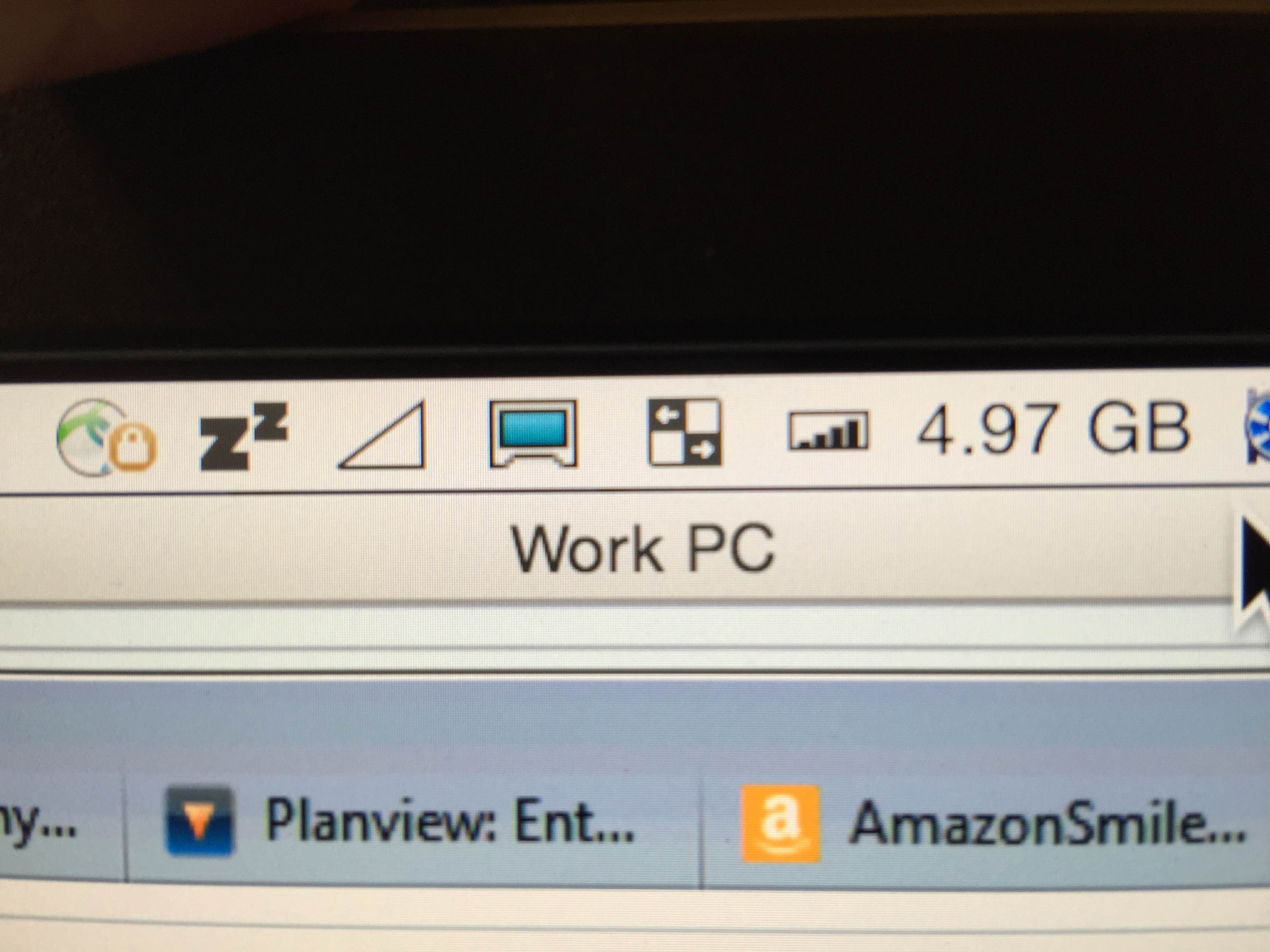

Tried to capture the high PPI/DPI on the P2715Q which I have scaled to 1920x1080 HiDPI. It's so very clear, almost as if looking at printed paper.
Here is the image, although I don't know if you can all see the detail enough. It looks way more grainy in this picture than it looks in person.
