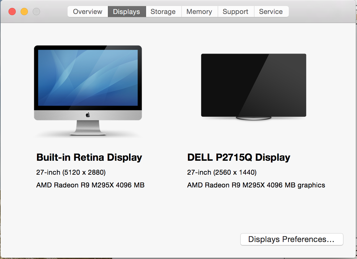

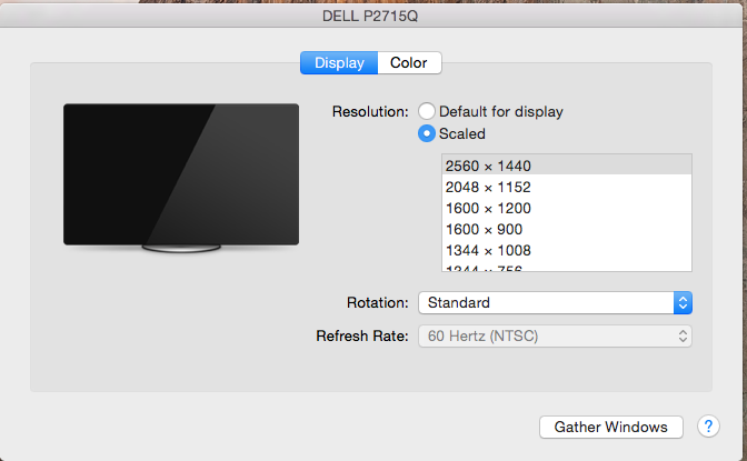

Help me with connecting P2715Q to RiMac...
I am getting confused about running the Dell 4K P2715Q monitor as a second display for a Retina iMac. I think when I first connected it up yesterday it was working in full resolution, but today it seems to be stuck in 2560 x 1440 (see screen shots). The "Default for display" selection is the same as the max scaled resolution.
It is connected via mDP-to-DP input with the iMac, and also connected as the primary display to a 2012 Mac Pro GTX 680 4GB via DP-to-mDP input. It seems to be working fine with the Mac Pro at 4K resolution.
What am I doing wrong ... or how can I fix this?
Thanks...
Thanks...
You won't like my first suggestion - send your riMac to me and I'll fix it. Note that I didn't write that I'll send it back... :D
I had the same issue with one of the several P2715Q monitors I recently ordered, and a similar issue as the one you're describing - it even showed up on my personal rMBP. The 4k option was showing up the first couple of times and, then, not. Vexing, that...
What's fixed it is first changing the EDID of the two monitors I'm using then downloading and installing SwitchResX. For some reason the Displays System Preference setting isn't "sticking", and I can't offer an explanation why. I edited the EDID to change the display from a "television" - which is how I was seeing the 4k options - to a DisplayPort device, but then 4k options weren't available, which is where SwitchResX came in to fix that. Both "hacks" are mentioned several times in this thread, and props to those posters - PM me if you need more info regarding the EDID hack. There are so many more resolution options available with SwitchResX.
