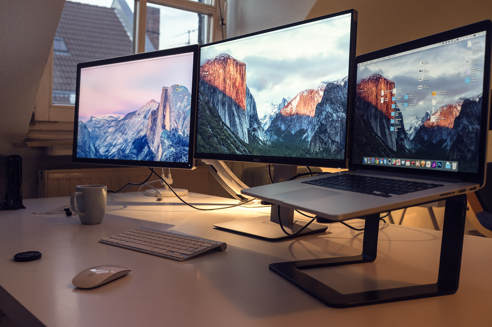

Just got my P2715Q. Amazing Panel, but very ugly design compared to the U2515H which i bought just a week before.
Best bang for buck U2515H, just amazing display. If you want retina quality, there is only one way.. :)
btw, I'm sending the U2515H back and will keep the 4k display. I'm running a late 2013 mbp with "just" iris pro.
