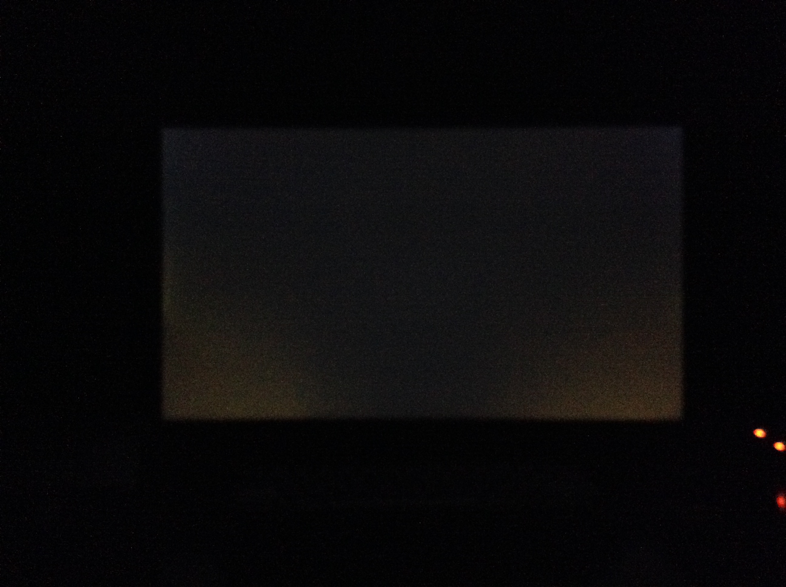

Edit: The cold wake up issue is unfortunately persistent, I'm doomed for 1-2 more years with another disturbing Dell issue, whenever the system wakes up from a long sleep the macbook monitor adopts the windows, shrinks them, the monitor kicks in, gets them back in shrinked form, I will probably try to program a keycap combo to use Moom to resize the windows back to full-size
Edit 2: Added the picture of the backlight bleeding, I like this monitor, I was expecting sleep/wake issues, yet I wish I didn't notice the backlight bleeding, especially the left-side is pretty disturbing during movies/tvshows as it's uneven and distracting
I don't want to go through an international return hassle, but I'm wondering whether it would be foolish not to

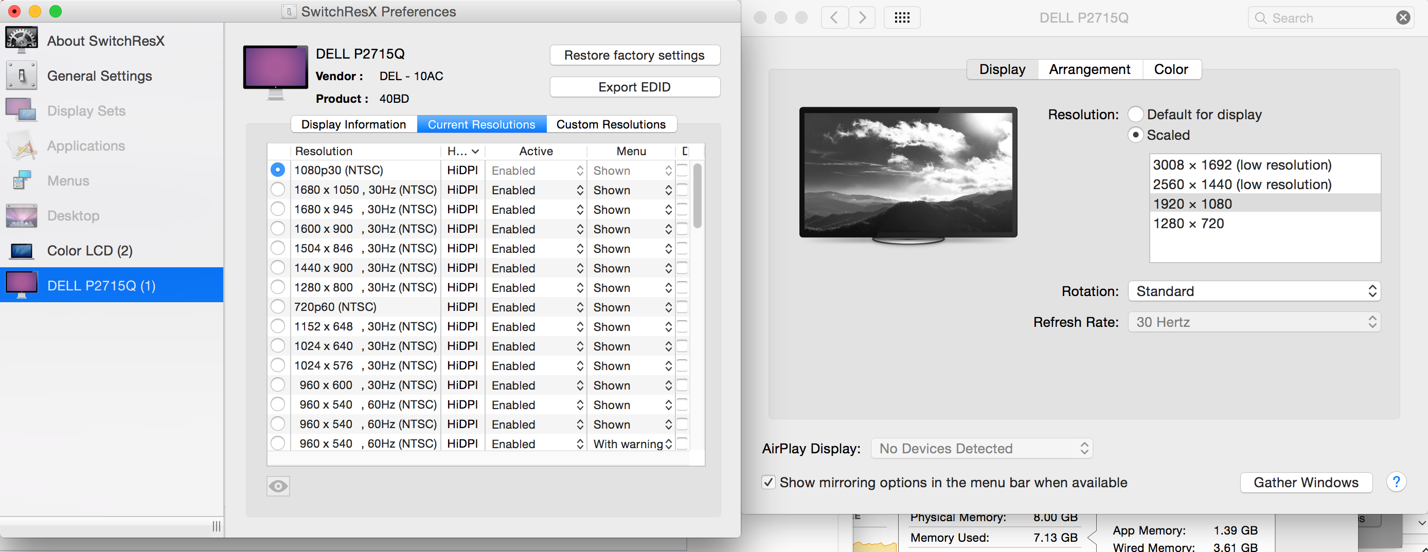

I've been using the P2715Q now on my 2013 13" rMBP (Iris 5100) and it can only push a max of 30Hz 1080p (HiDPI), though I've heard some people pushing it to 51Hz at 1080p (HiDPI) with a custom SwitchResX tweak/resolution config.
I'm interested in this workaround. Anyone have a link or more details on how to use SwitchResX to accomplish this?
I messed around with it a bit and was unable to get satisfactory results.
Thanks!
