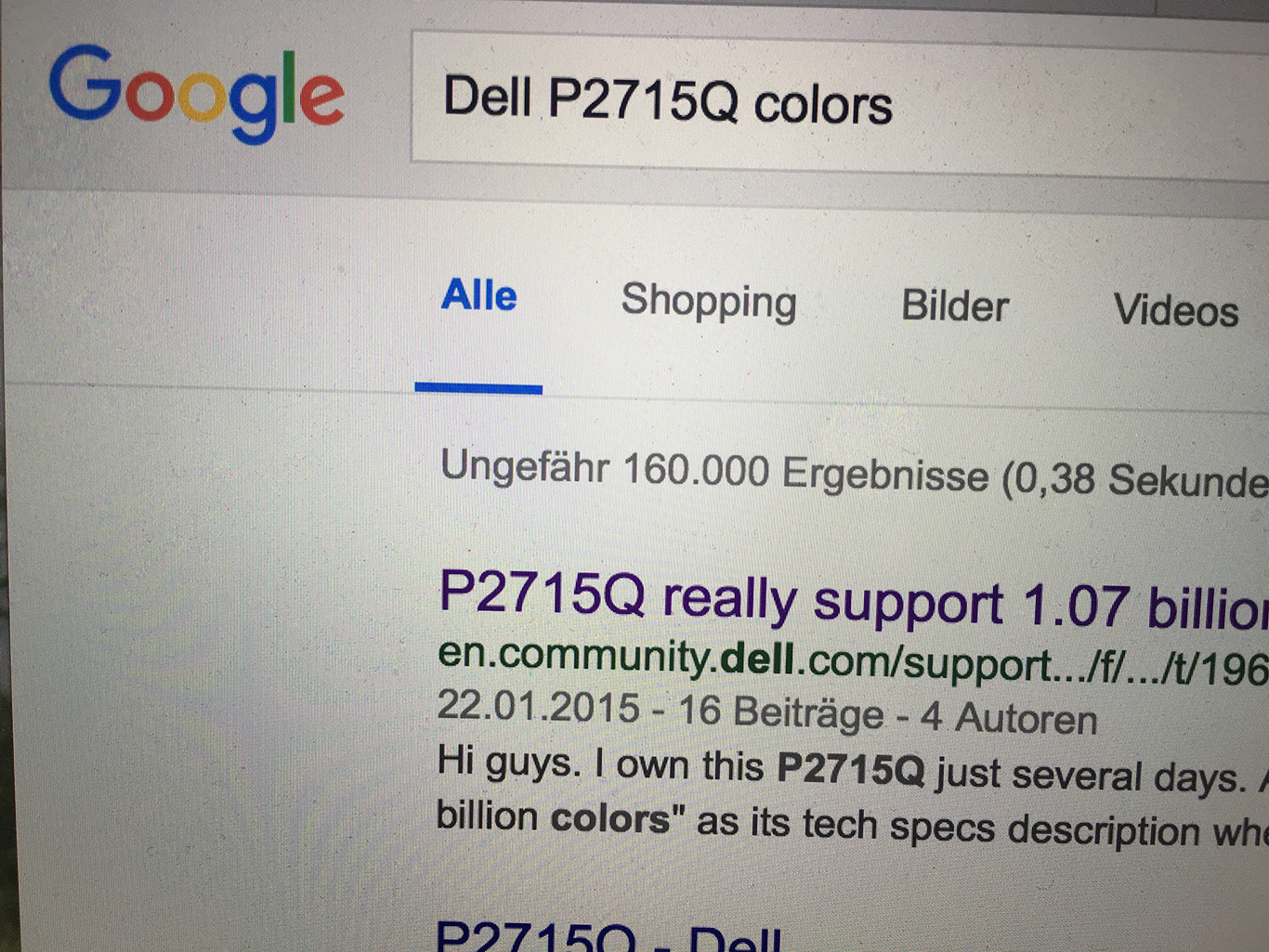

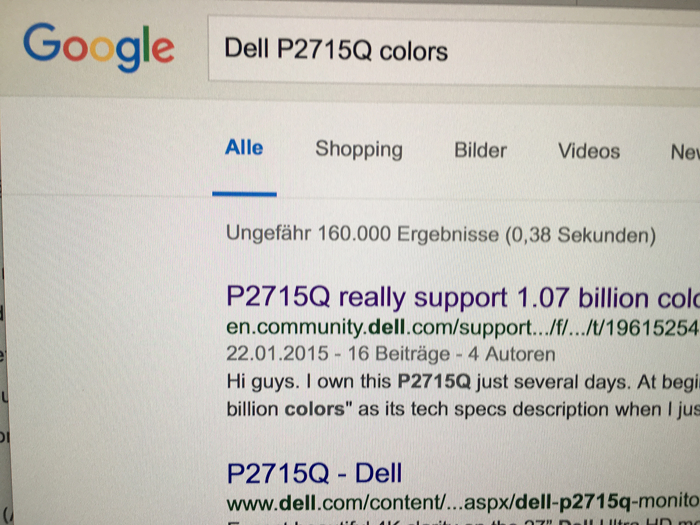

Hi,
i just got the Dell P2415Q today and I am not sure wether to keep it or not...
In comparison to my Macbook Retina 15 (Late 2013) the colors are just too "warm"
So it always seems a little yellowish. I tried different settings and the different modes. Even in the custom mode I only get it to be yellowish or too blue..
Attached you can see the difference, the first pic shows a picture of my MBPr and the second one the Dell. Do you notice that the google bar is grey on the mbps and yellow on the dell?
Do you have the same experiences? Did some of you get the same colors as your Retina MacBooks? If so, how? :)

I had the same, played around with custom color mode put in R:92 G:92 B:100 and the colours are now more or less identical to the colours of the Thunderbolt Display next to it (which I used as reference).

Hi, I noticed this yellow colour on my P2415Q when it arrived last week. To fix this I changed the custom colour to R - 87 G - 85 B - 96. Let me know what you think of this setting, regards.
Thank you, but wow, this turns out to be very blue with my display.
Thank you for that!
I put 92-92-97 that is very close to my retina. Especially, if uniformity compensation is turned to "calibrated" it looks quite good. But the problem is when I am working in the evening, then its just too bright...

Hmm yeah out of the box colors were noticeably warmer than Retina Display. I adjusted contrast to get rid of a lot of it, but the 92-92-97 just about finished the job.
I put the El Cap default wallpaper on both displays and tweaked settings to get the color as close as possible: 75 contrast, 90R 91G 100B.
