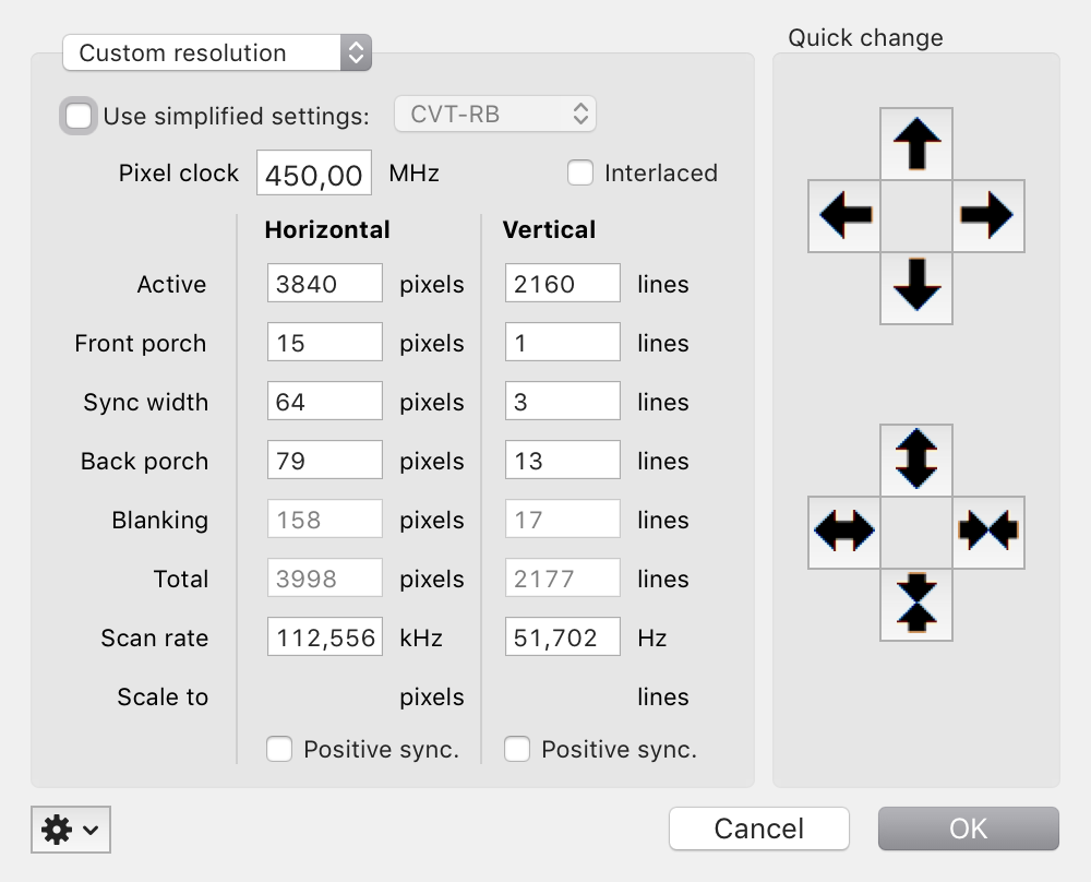

Could you provide further details of your custom resolution configuration (by double clicking on it?)?

Sure, here you go: http://cl.ly/3A3T102W3E3A
Not sure about the hardware problems you're having tough. The only "artifact" I have at 52Hz is in Safari, when playing videos it will sometimes be distorted for a few seconds.
EDIT: Nevermind, switchresx was staying at 40Hz even though I was switching it to 51,11Hz (the configuration you posted...)
Upon further trial I discovered mine does not post with your exact configuration. I have exactly the same laptop as you do. Same gpu, same ram, same year, 13".
The best I can get is 4k or 1080Hidpi @ 40Hz using the simplified settings (CVT-RB) function in switchresx. Any higher Hz and it is a no go.

This is my configuration:
http://cl.ly/431d2n2j3O1w
http://cl.ly/2f2E1m1e0S3B
