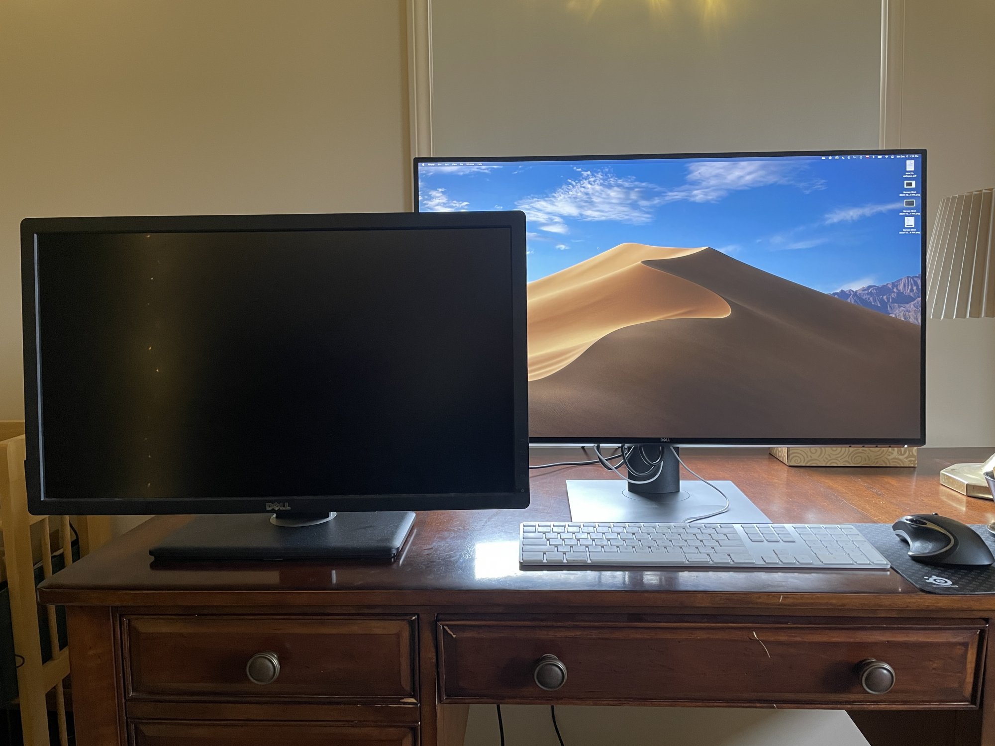

Size compared to U2713HM:

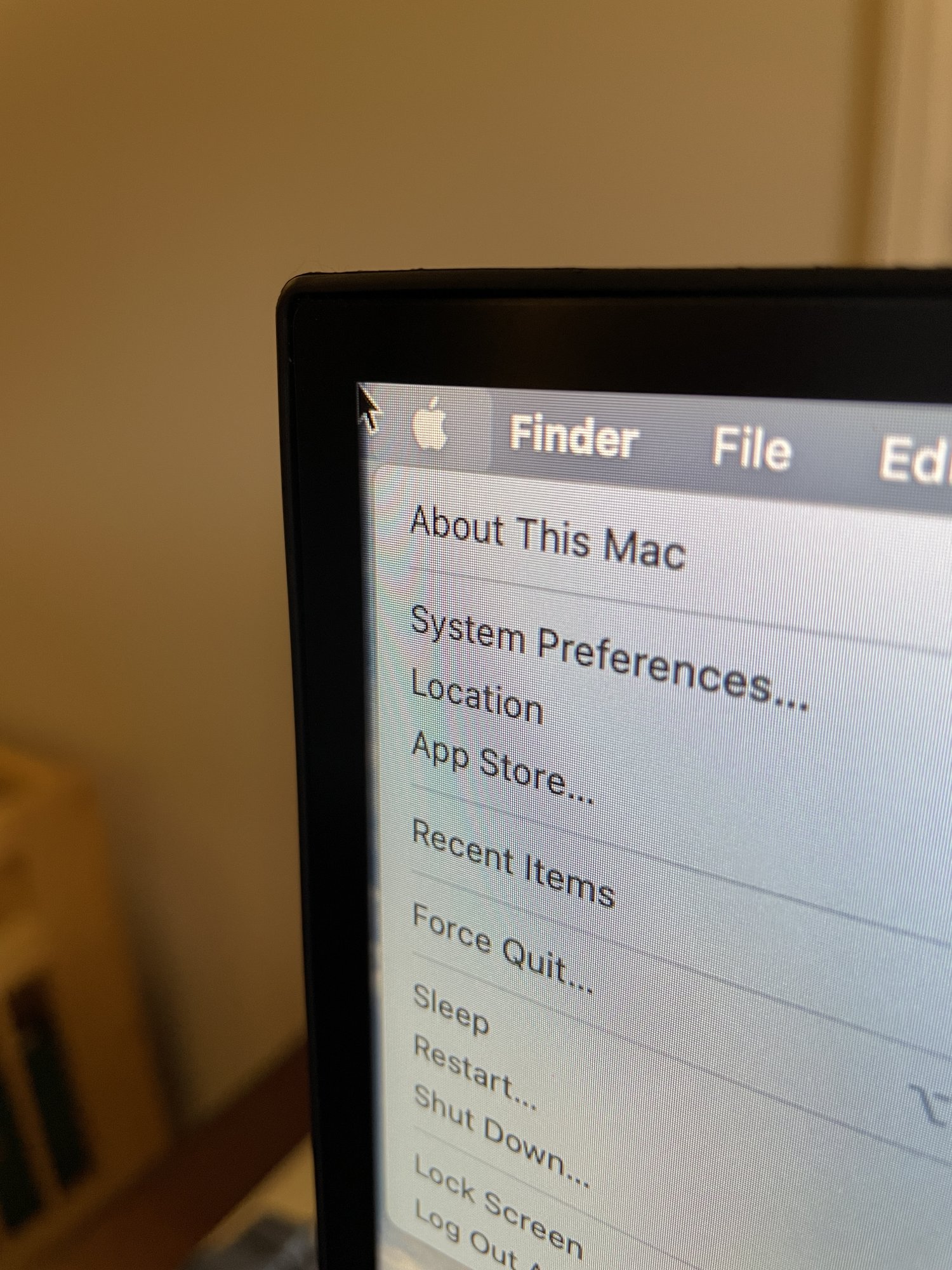

Annoying dim band at the sides:

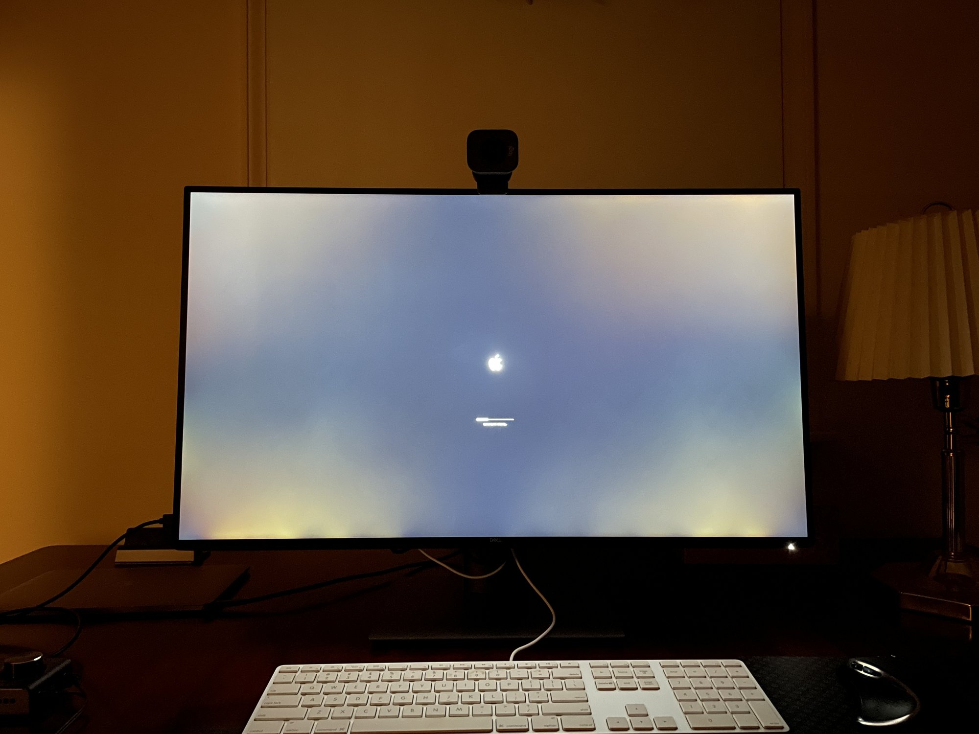

Backlight bleed is strong especially in the corners and bottom edge; the camera exaggerates compared to real life, but it's still quite noticeable:

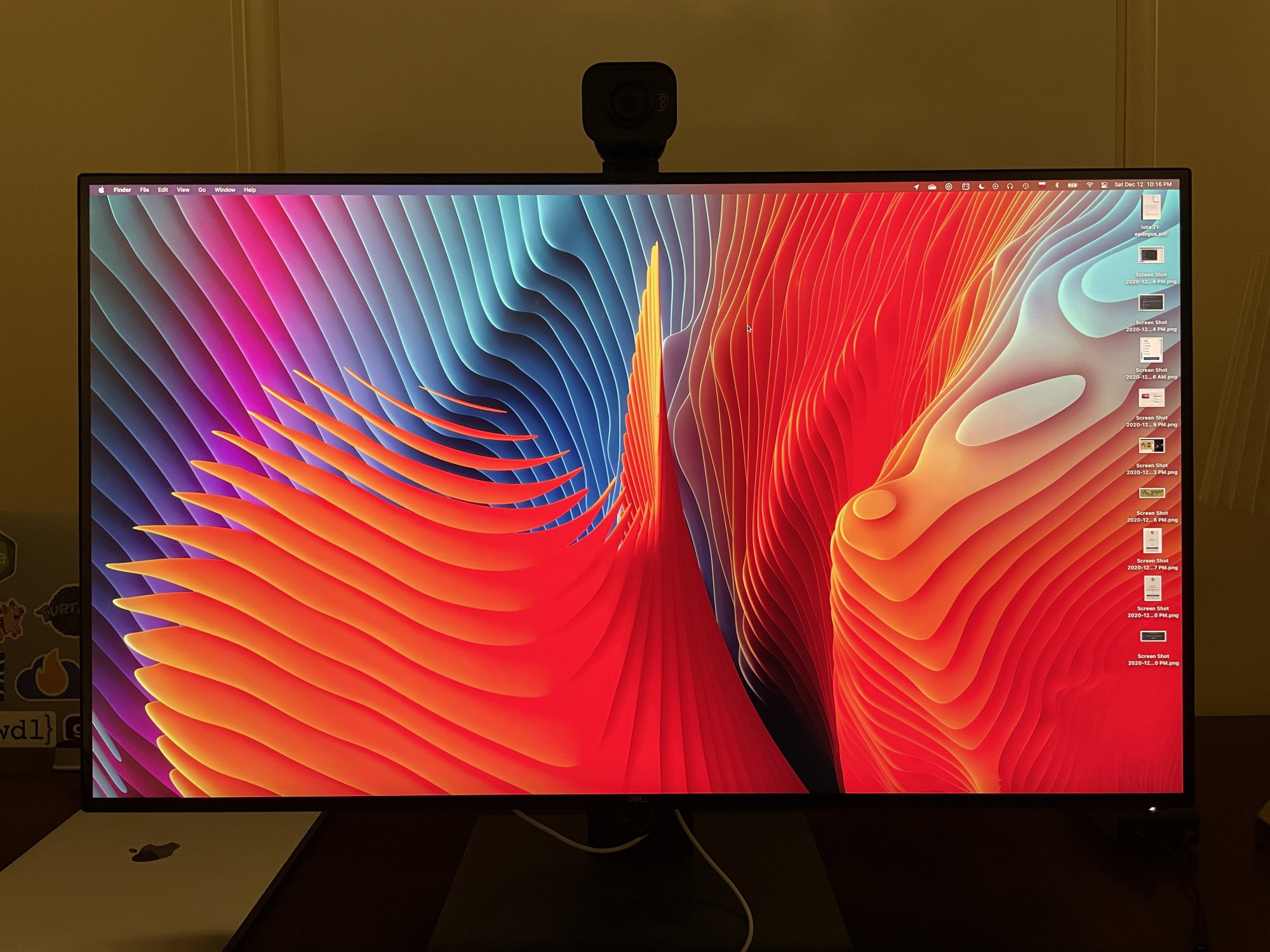

A more favorable panel shot: with one of Apple's P3 wallpapers, the colors really pop.
I previously owned the LG Ultrafine 4K 21.5" with P3 and I would say the color is very nearly as good.
