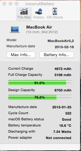

Coconut battery says my battery life is good. Ran that command in terminal as well and my values were max capacity of 5076 and design capacity of 6700. Looks like I have about 75% battery life left?
Not sure I totally believe this though as I have had this computer for about 7 years. I didn't use it daily though so is that why I still have plenty of battery life left?
Thanks for the help!

Well, that 76% just means that your battery still charges up to 75% of its original capacity. If you went just by charge cycle counts (supposedly 1000 is the recommended limit) then you'd theoretically have about ~48% left (not taking age into account)?
Your battery is about as old as mine was. But mine was only 51% of original capacity, had 1510 charges, and was considered "Fair" (even though I think it said "replace battery soon", and would only last maybe an hour or so on a charge). Whereas yours is only at 522, and is still considered "Good".
That actually looks really good, considering the age.
As long as you're not having any issues, I wouldn't bother replacing, especially if you're going to sell.
Should I make it a point to mention how many charge cycles are left or just say the battery is in good condition?
That's a good question. I'd probably look around and see what other sellers are doing.
Might be a selling point, since your battery is likely in better condition than most that age. From what I can see, most don't list it, but that's probably because they're original batteries (probably Fair condition at best)? If I was selling and had a battery in Good condition (even if original, but especially if replaced), I'd mention it. And as a buyer, I'd appreciate knowing that detail.
