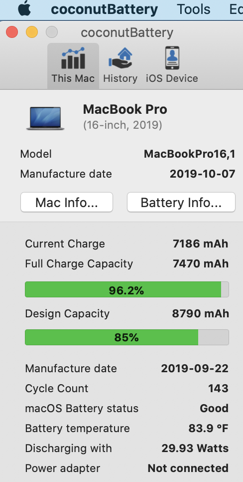

Mine was built in mid January. Shows 83.5% design capacity with 51 cycles on the battery in coconutbattery. Terrible.

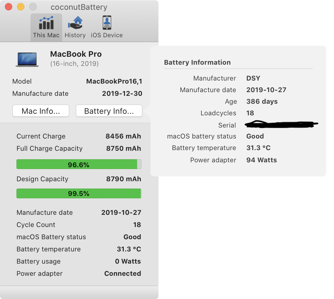

Is that because you have a DSY battery or because you’ve had battery health management turned off?
mine is simplo...
Btw mine still says 90.1 % with battery health turned off for a day. I don’t feel like it’s going to go back up. Either battery health management permanently degrades battery capacity, or they’re unrelated. I’d like to see more coconut battery screenshots to compare simplo vs dsy batteries.
