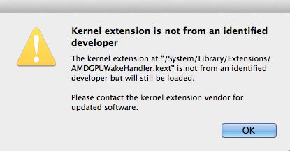

@tmanx The first time the kext is loaded on mavericks, a message is displayed because it's unsigned, but it loads nevertheless. With the kext loaded, the temperature of the GPU die shouldn't increase with respect to the values after booting (You can use iStat or Macs Fan Control to check the temperature), and the battery shouldn't drain faster.

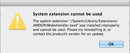

From what you said - that means it isn't loaded. To be sure I tried to unload it and got the following:
Phoebes-MacBook-Pro:~ phoebe$ sudo kextunload /System/Library/Extensions/AMDGPUWakeHandler.kext
Password:
(kernel) Kext io.github.blackgate.AMDGPUWakeHandler not found for unload request.
Failed to unload io.github.blackgate.AMDGPUWakeHandler - (libkern/kext) not found.

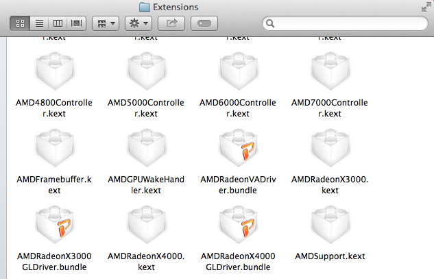

I checked and it is in the correct directory:
I then tried to load it and got the following:
Phoebes-MacBook-Pro:~ phoebe$ sudo kextload /System/Library/Extensions/AMDGPUWakeHandler.kext
/System/Library/Extensions/AMDGPUWakeHandler.kext failed to load - (libkern/kext) authentication failure (file ownership/permissions); check the system/kernel logs for errors or try kextutil(8).
I'm assuming that as I've run the following the permissions are OK? - But I'm unsure why it wasn't loaded in the first place? The
sudo chown -R root:wheel /System/Library/Extensions/AMDGPUWakeHandler.kext
sudo touch /System/Library/Extensions
thanks very much
OK, it must be the permissions. Did you try rerunning the chown and then doing the kextload?
