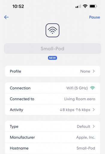

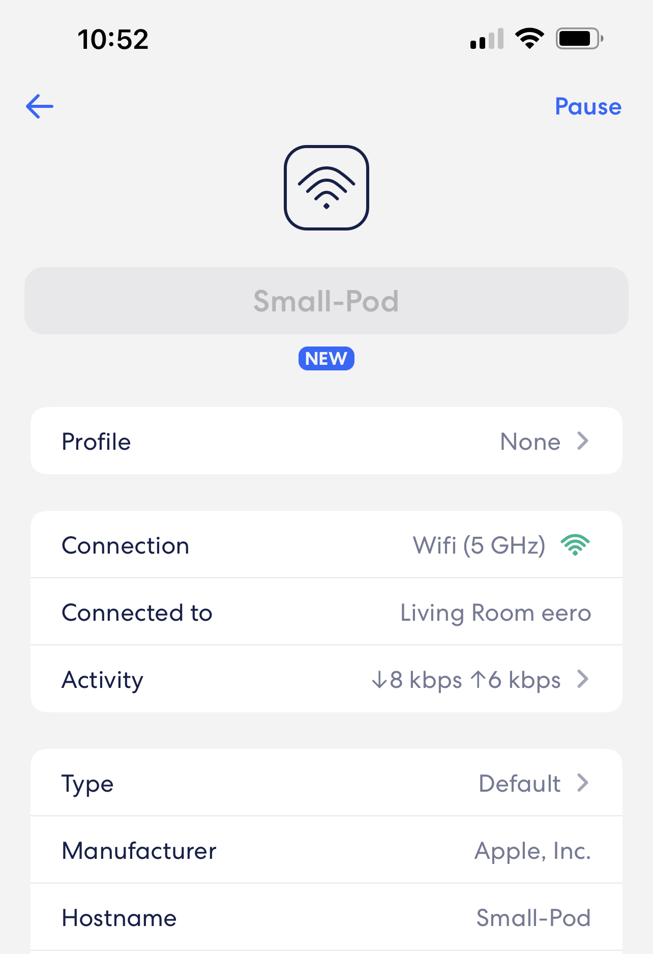

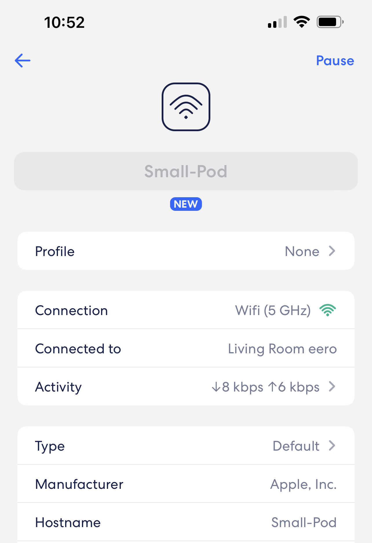

I’m sick of my HomePods messing with HomeKit so I stuck them on their own subnet and blocked them talking to the rest of the network. Now my wired appletv 4k is the hub and everything is great again.
Reactions: cutienoua
great ! I have an Eero 6, how do I do that? they have an app for settings.
