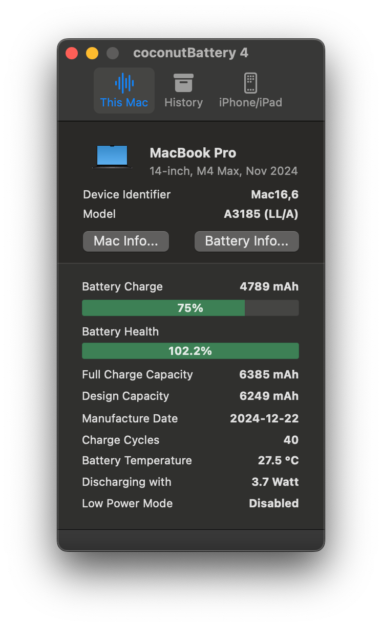

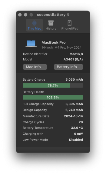

At the moment, I'm traveling and using the battery. Here is the battery status.

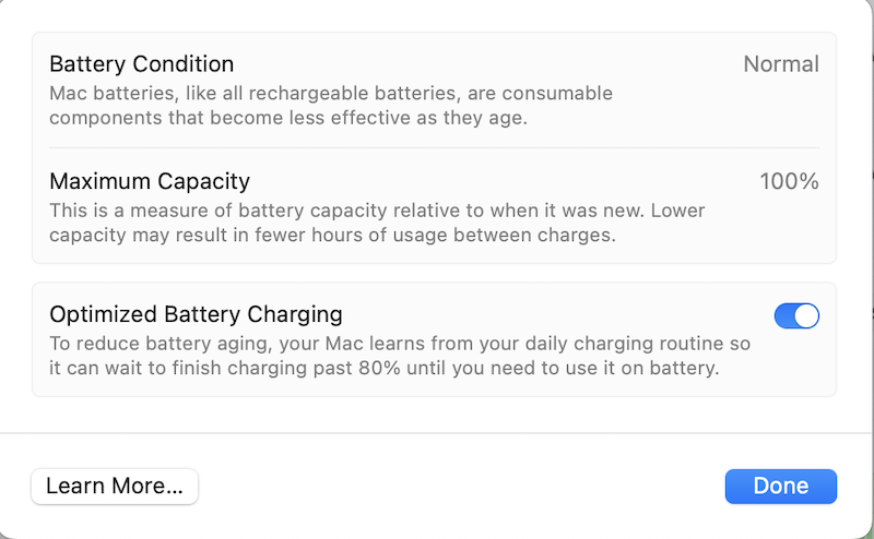

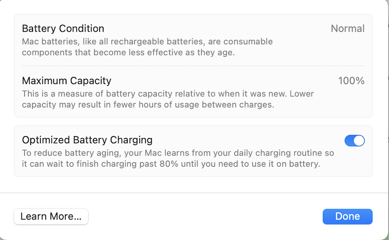

I have now re-set AlDente to zero control and then uninstalled it completely, rebooted and turned on OBC so will try and hold out for several weeks to see if things have improved since I last tried seriously on Big Sur.

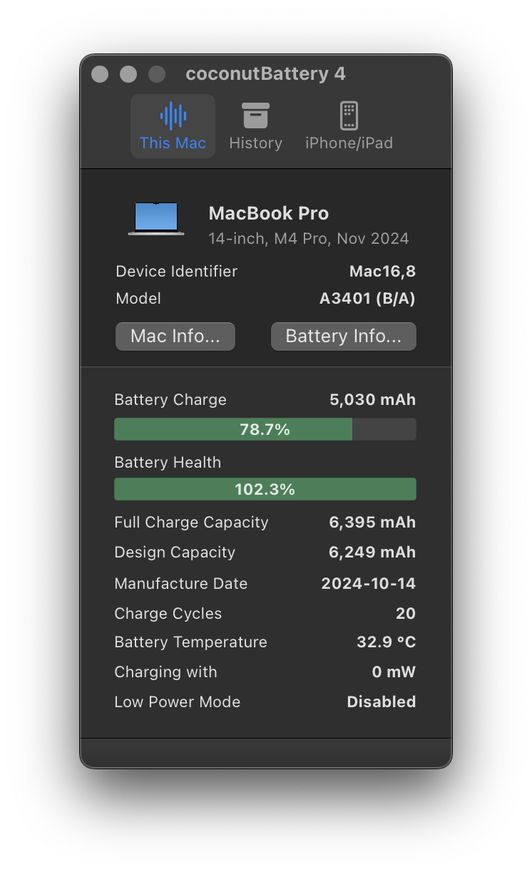

Just as another data point for you, I run my M4 14" MBP in clamshell fulltime, with the exception of three or four times a year taking it on trips. I notice when I get back from my trip and put it back in clamshell mode, it usually takes about two weeks to start limiting charging to 80% again.
I'm guessing if you are using yours on battery for short period in between trips, that may be resetting the clock, so to speak, on the 80% charging.

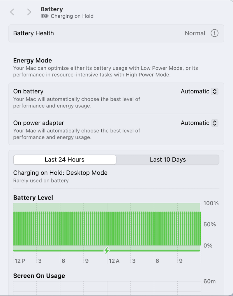

There's a theoretical guide on Apple Discussions on how the Power Management AI works.
It also appears OS updates can disrupt the AI.

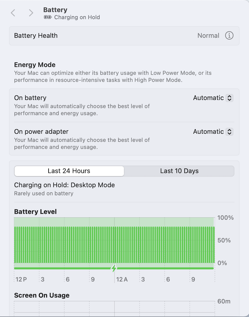

I noticed it charges to 100% initially after every OS update and then drops down again which would suggest that a bug in the OS could potentially mess up the algorithm forcing you to start over.
Screenshot 2025-07-31 at 9.39.12 pm.pngScreenshot 2025-07-31 at 10.38.42 pm.png Screenshot 2025-07-31 at 11.21.25 pm.png
Today, a month after removing AlDente, I noticed that OBC has started working. Hurrah! It might have started a few days ago without my noticing.
I will live with it and see how it goes. I haven't taken it away on any trips in the past month so I haven't seen how long it takes to start being controlled again after period of being disconnected from power.

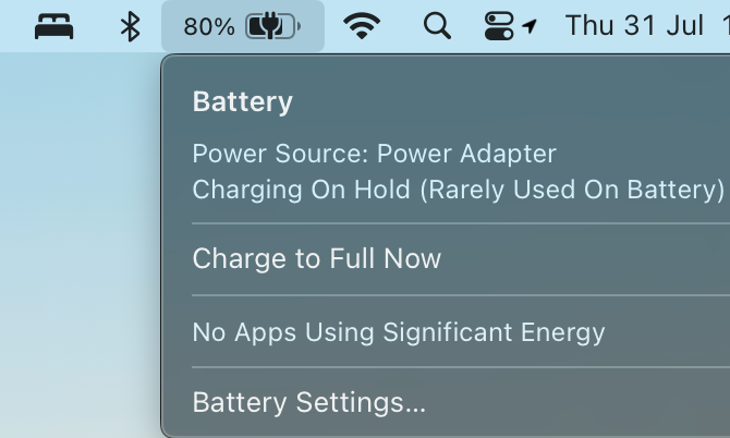

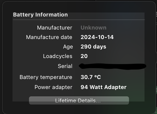

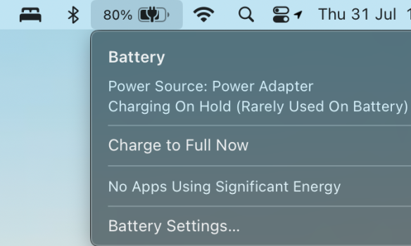

My MBP 16" M4 has been connected to power since the release date in clamshell mode.
It has only been on three long weekend trips.

AlDente software is not required. Default behavior ( leave everything to automatic ) charges to 80%.
It's enough for your MacBook to charge past 80% once, and then connect it to power and it will stay past 80% forever until you discharge the battery manually by disconnecting from power. Not good for those who use a single-cable charging + display.
