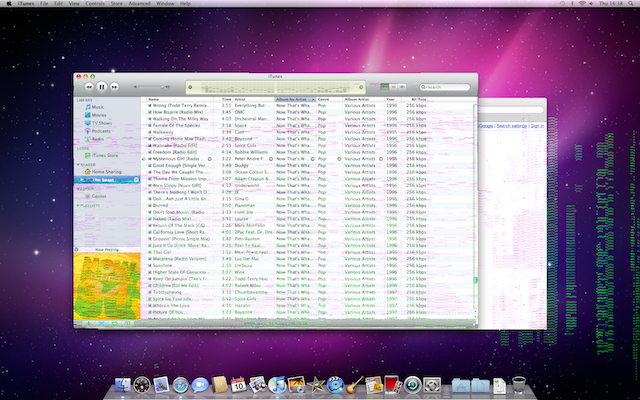

Hi everyone,
Sorry to bump up this thread from a week or so ago, but just lately I erased everything using Disk utility from my white iMac in Target disk mode.
It took some time to erase, and then once it was complete, my old mac started working again as though nothing had happened. I tested it out over a few days until I got the same graphical issue again before which I had installed all the latest software updates.
I have got a photo of the problem I have been trying to describe and would just like some input as to whether this is fixable by me, or if this computer just needs to be sold for spares and repair?
Thanks!

Hi everyone,
Thanks!
looks like the LCD is going bad
OP, if your iMac is 24" white (your sig tells little different 😉) you need this: http://www.mac-resource.com/1-888-MAC-RESOURCE/index.php?route=product/product&product_id=4926 and if you are "techhy", you can replace it yourself: http://www.techdc.com/imac-24-opened-and-upgraded
Yeah I know my computer is different - the one I use now is in my sig, and has just replaced the white 24 incher! Well observed though 🙂
I am techy but not to the extent where I can confidently take an iMac apart 😱 Thanks for the suggestion though!
