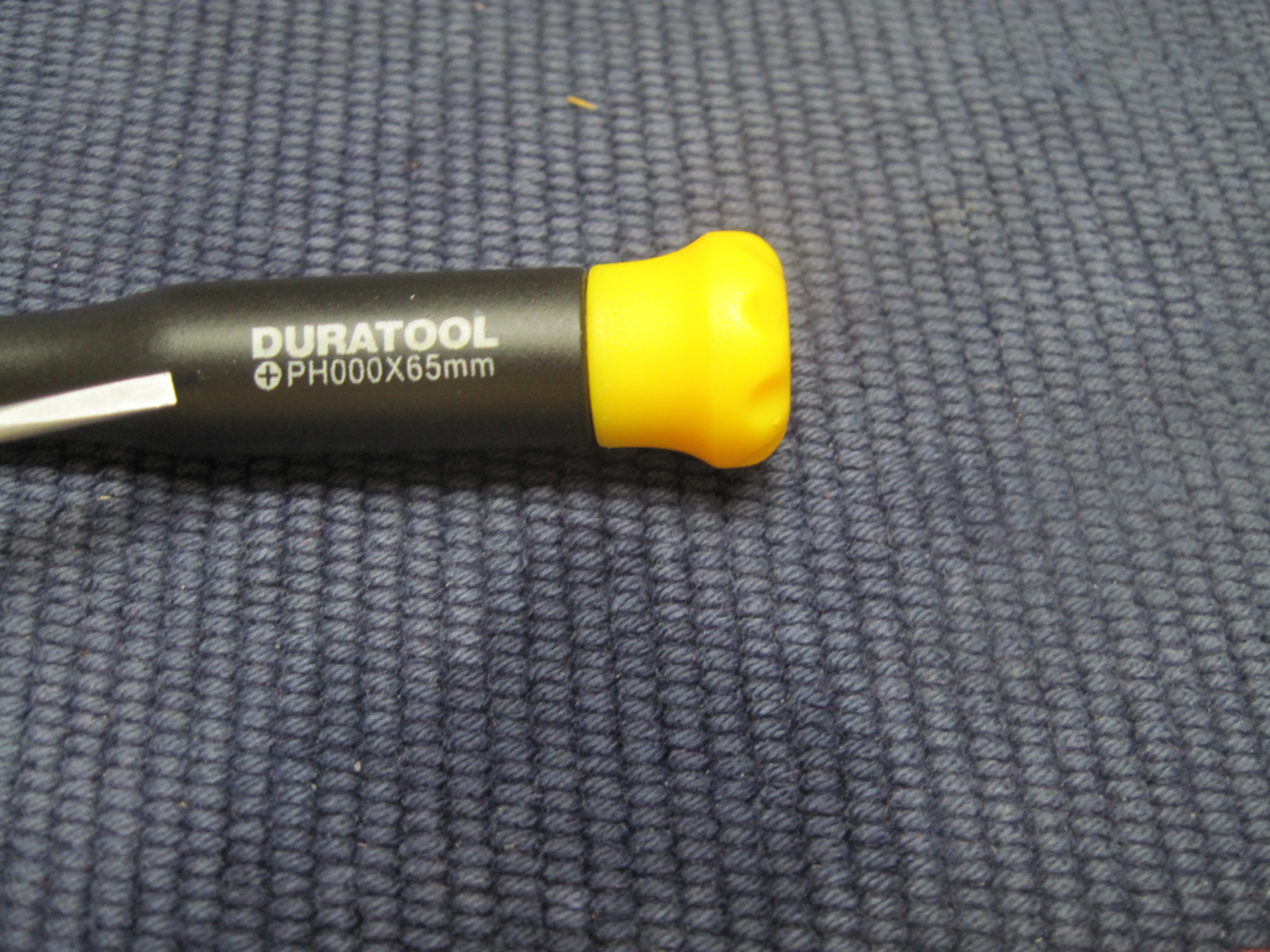

To remove the fan, you need to remove the four long screws (under stickers on the rear) using a PH01 screw driver. This will release the front panel and rear plate. Next unscrew the two screws holding the fan. Finally, remove the stamped steel shield and unplug the fan.

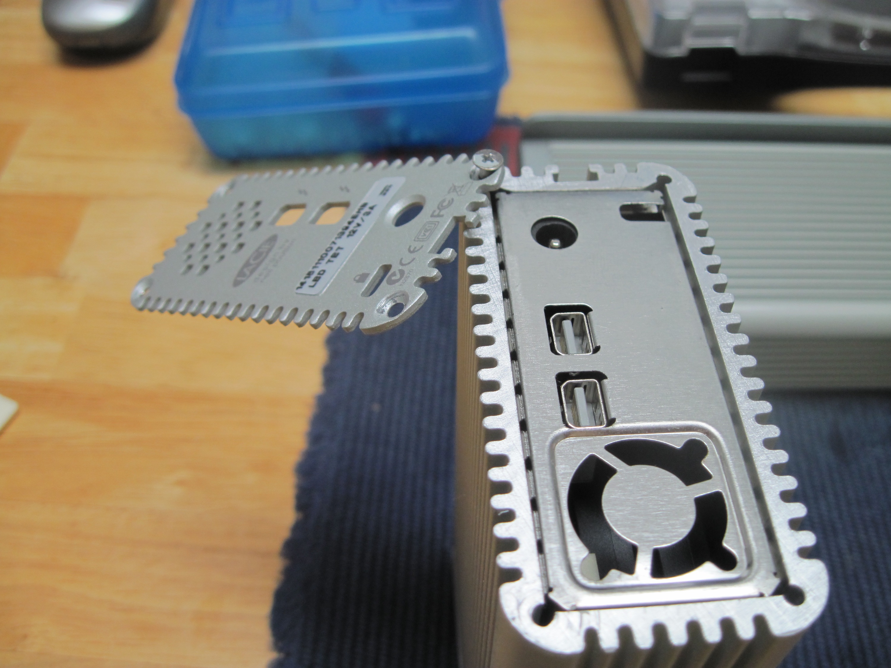

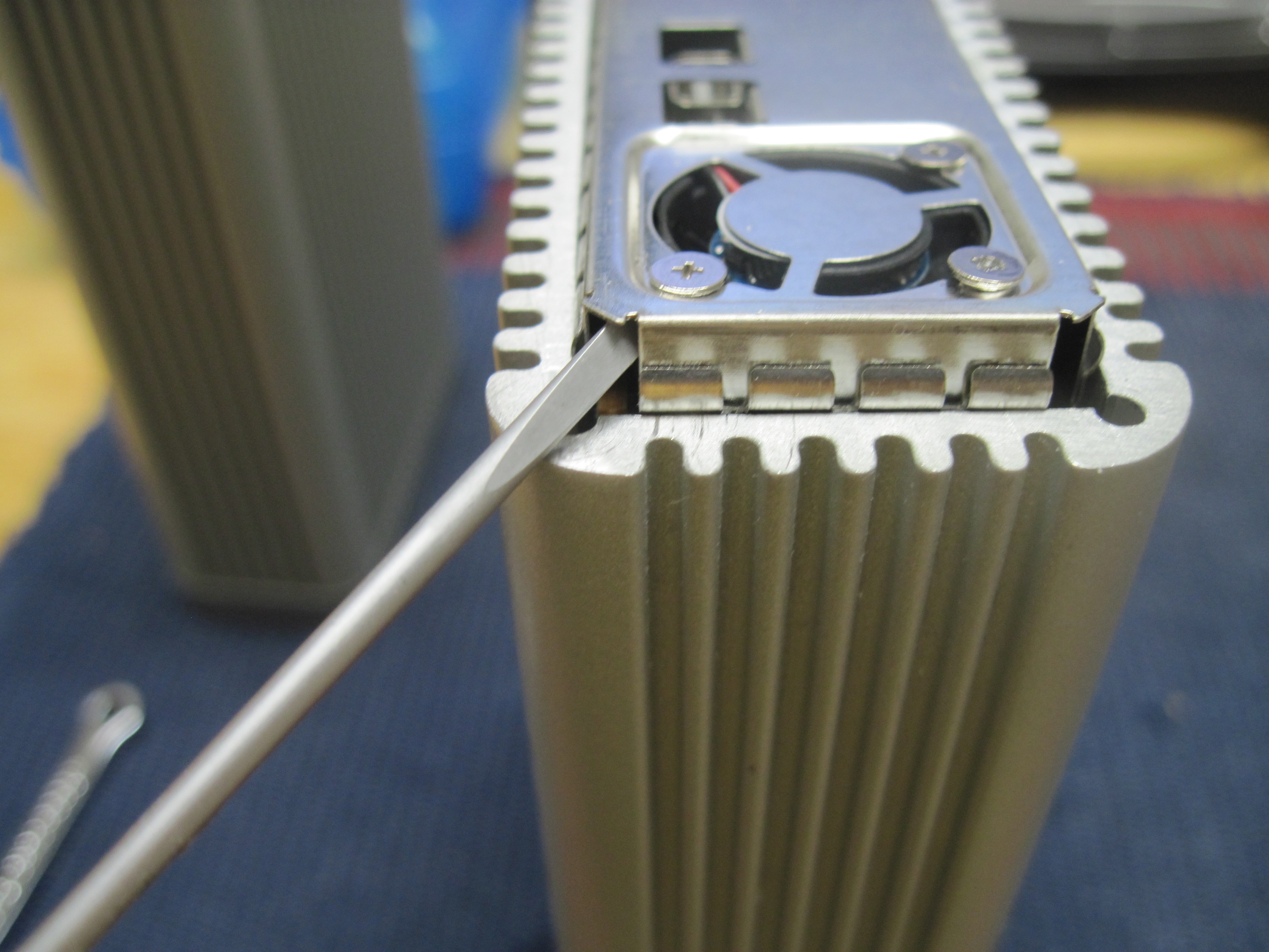

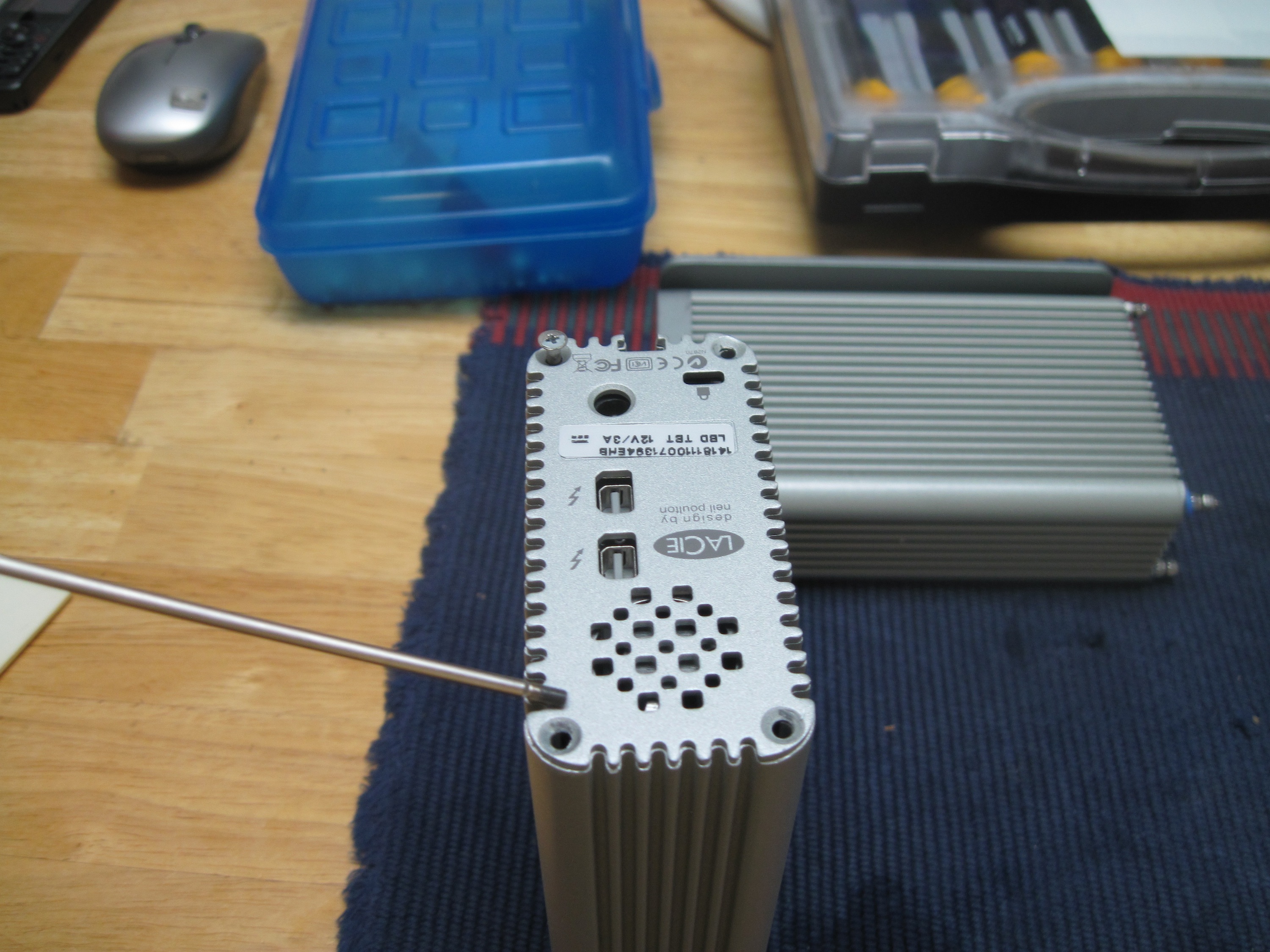

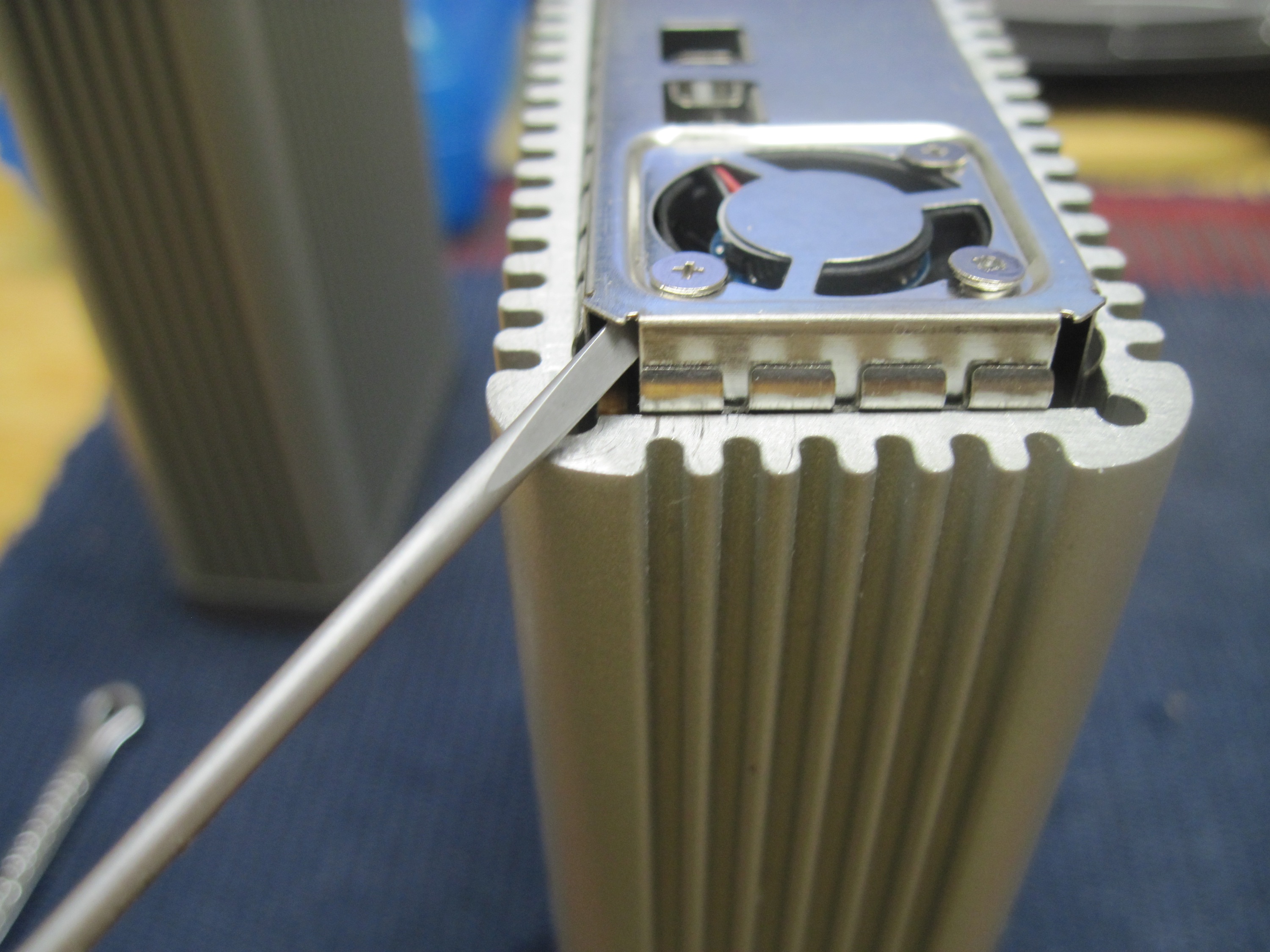

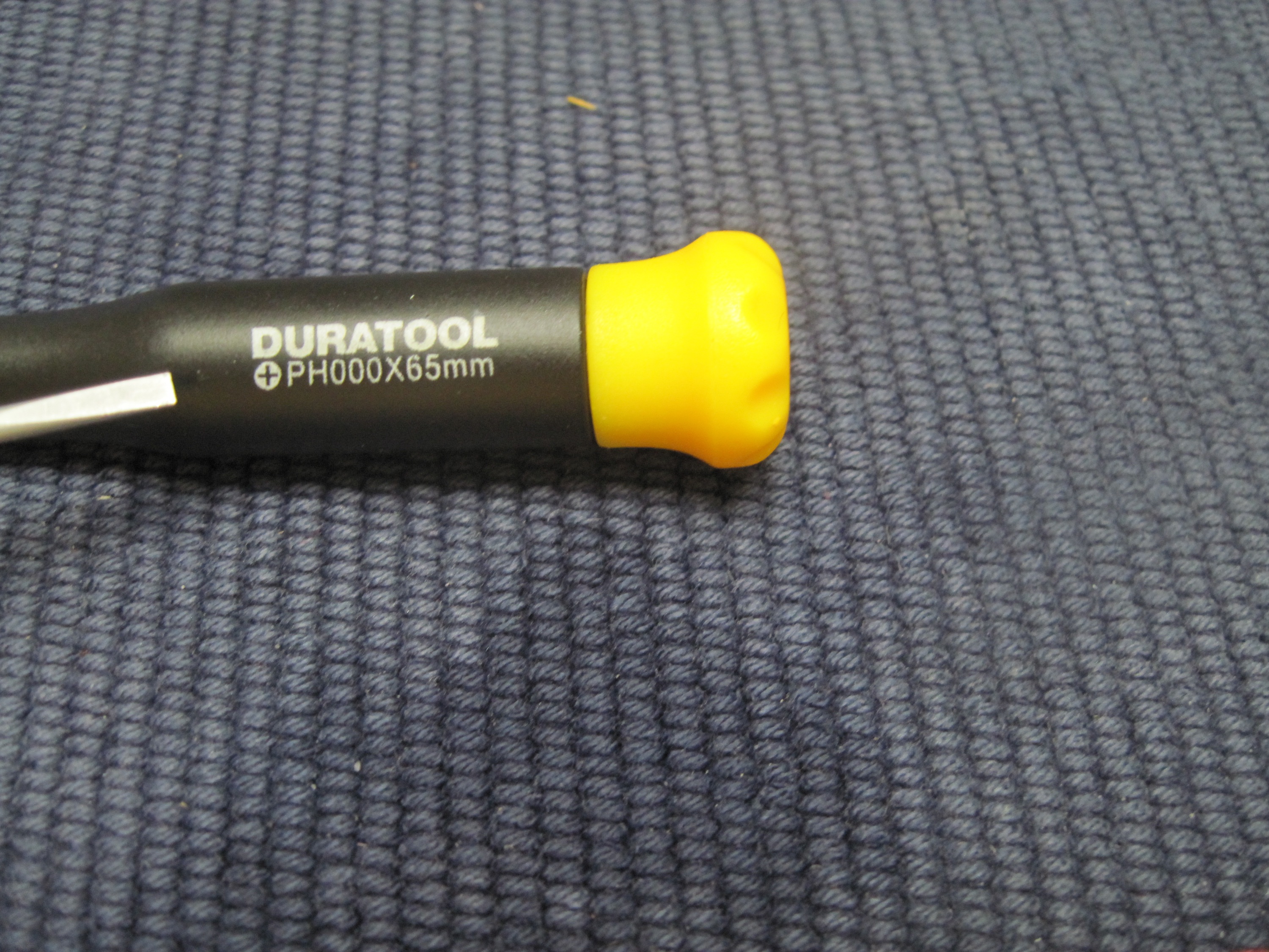

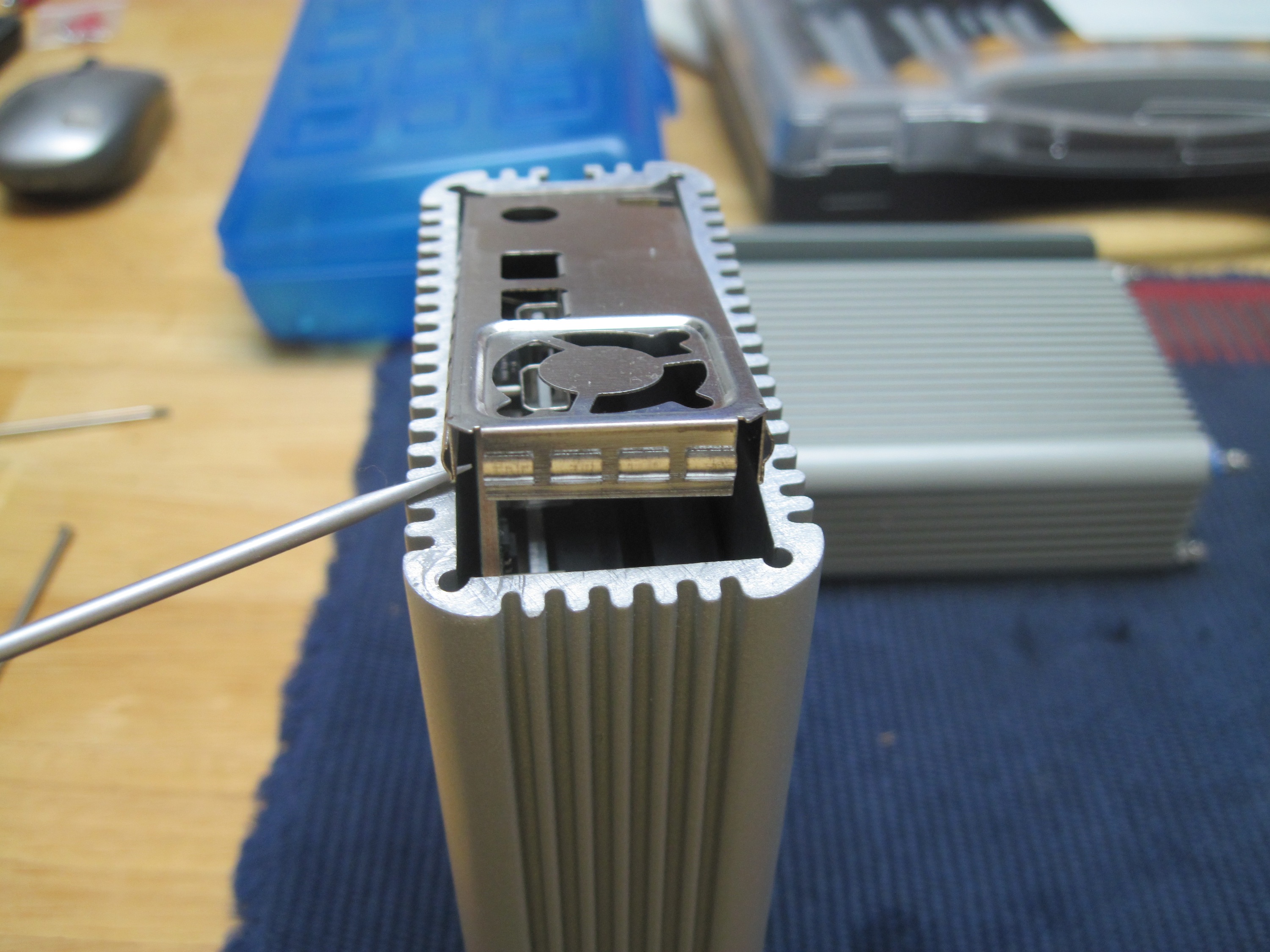

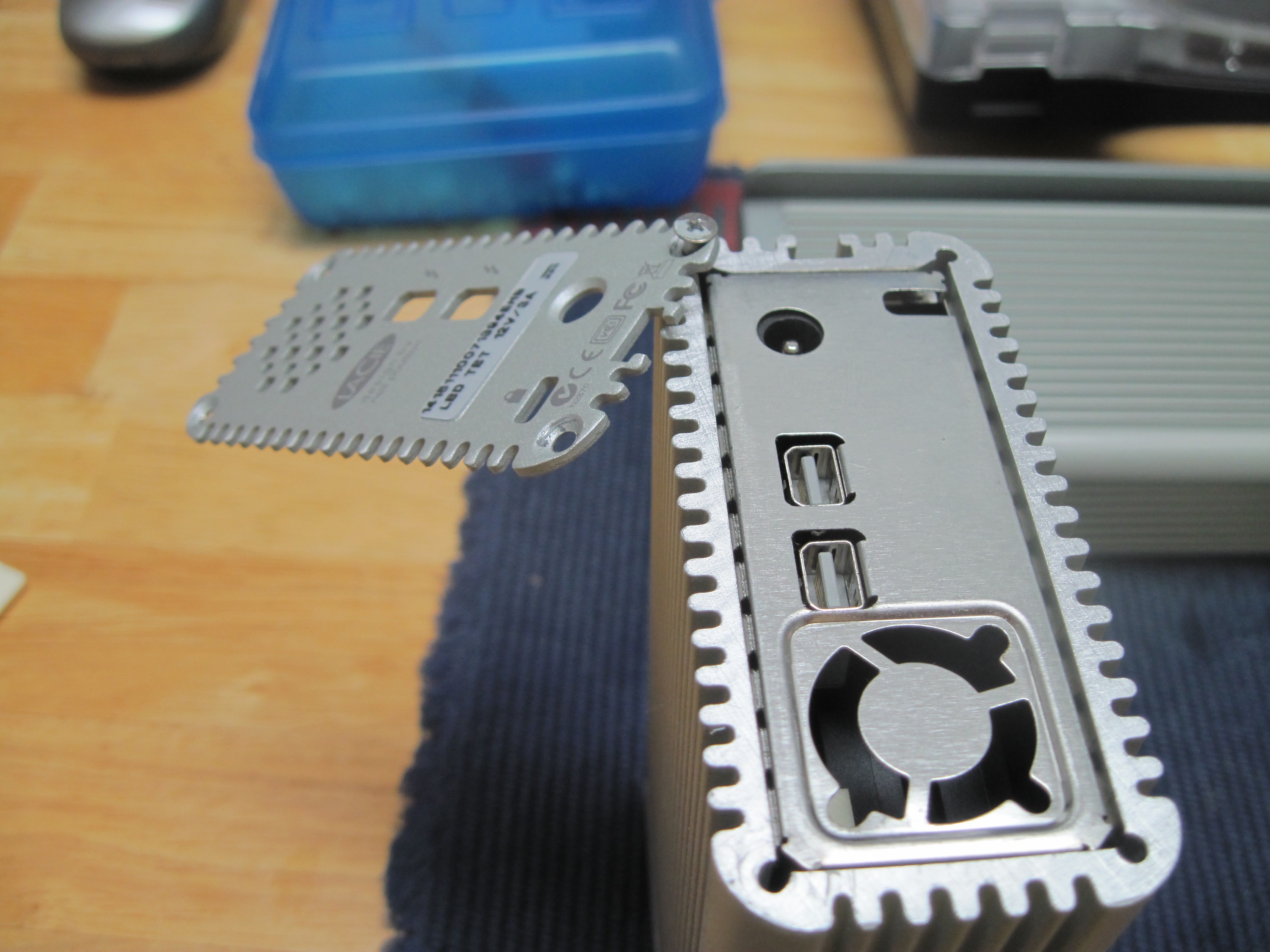

I will photo the tear down for you. bur frankly you will need to cool that drive off you have a daisy chain and that makes it warmer and you have hdds. I am a little busy but I will post it today. phil. first the right size screwdriver. second take the screws out. third remove outside
four pull second layer that holds fan don't pull hard it has the fan wired.

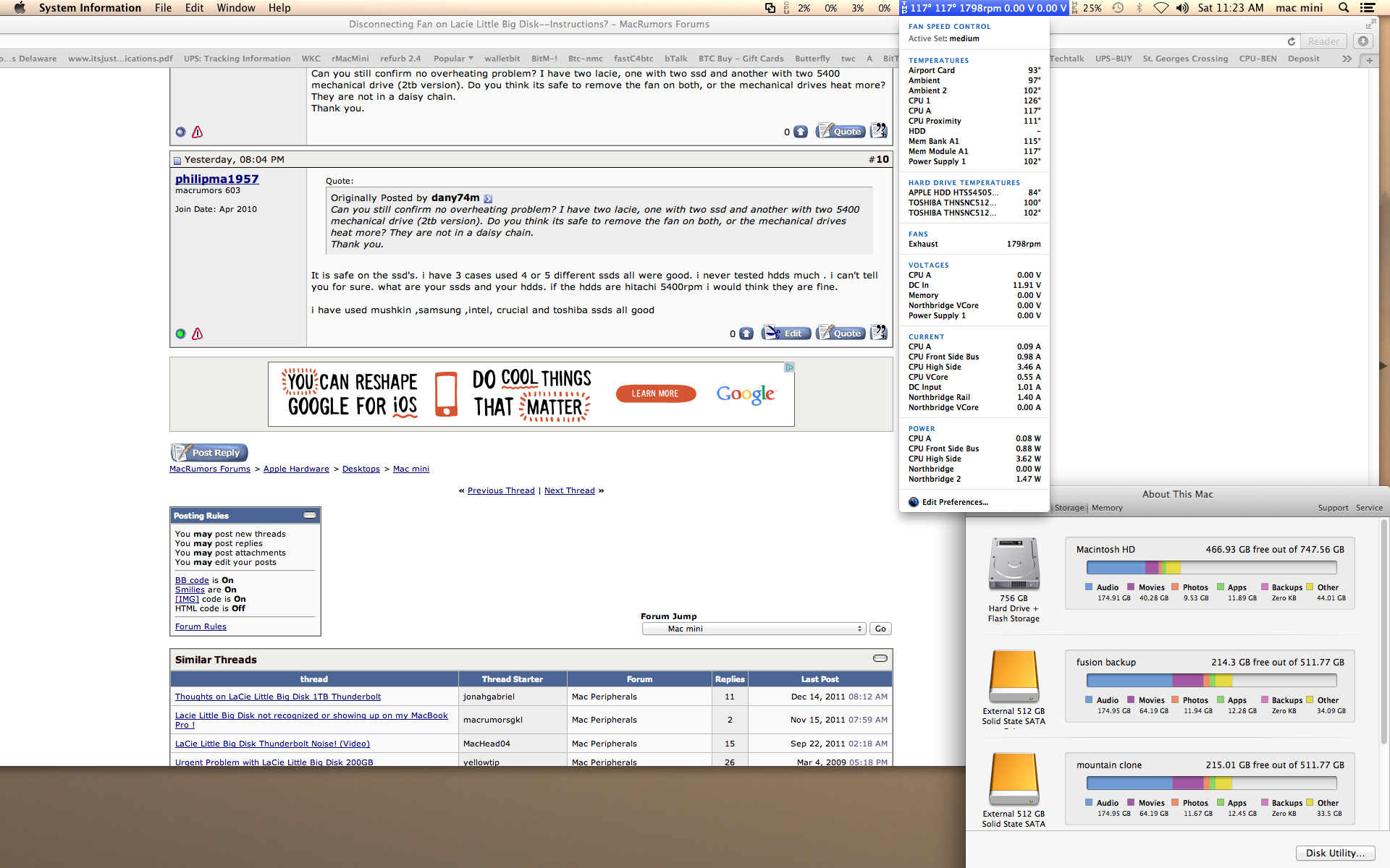

I posted a screen shot 2 512gb toshiba ssds in a fanless little big disk. house temp is 77 f
the 2 little big disk drives are at 100 and 102 f.

I purchased istat menu
http://bjango.com/mac/istatmenus/
the reason I have an ssd temp reading is that particular ssd has a sensor built into it. it is hit or miss as to each and every ssd if you will get temp info from the lacie case.
an ssd can run at 140f an hdd can also run at 140f or 60c ,
but to be safe 130f or 55c. some hdds and some ssds can do higher.
