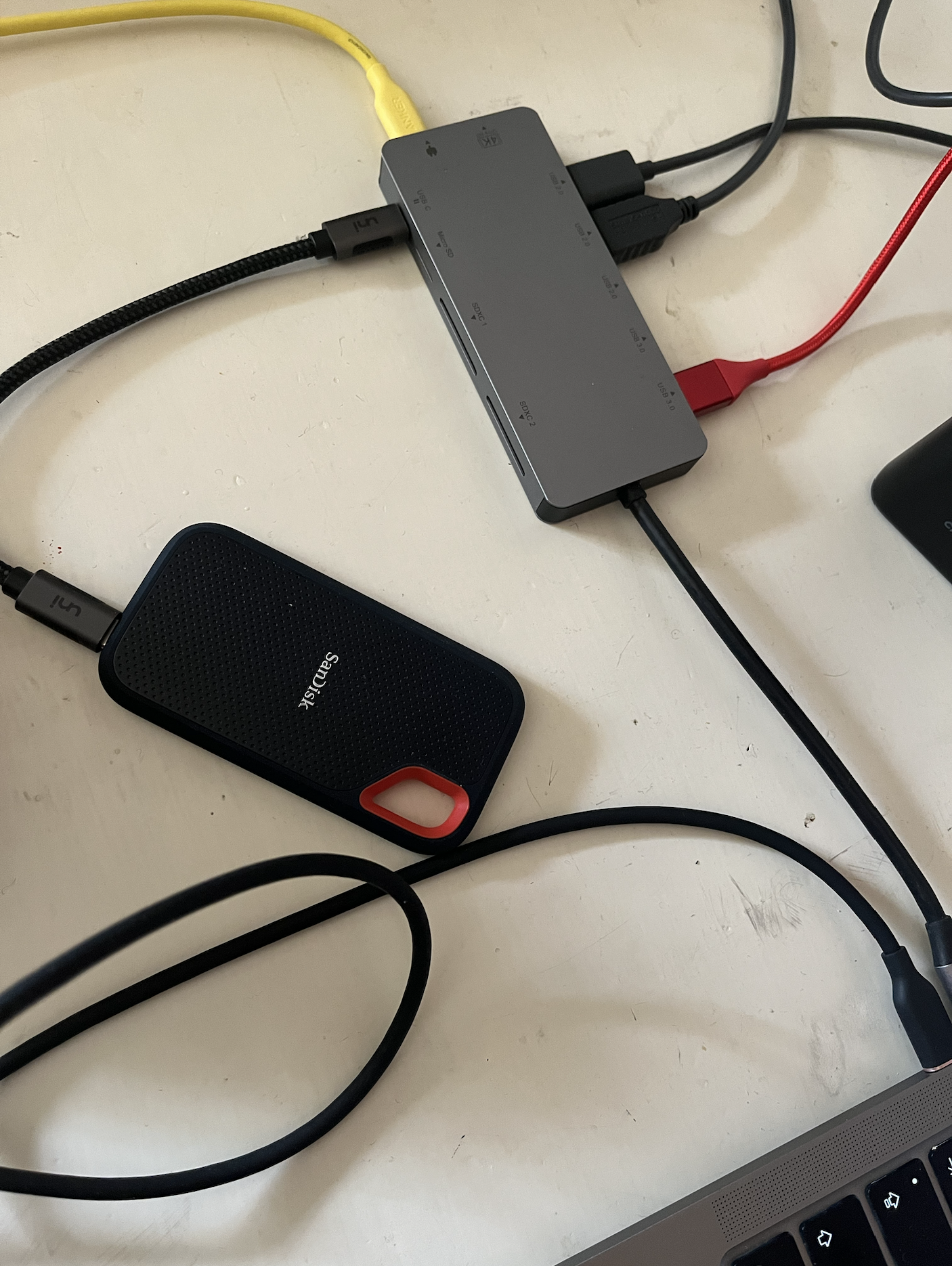

Ok, another update, I think the issue is with the Mac not providing enough power to the disk (Ventura-related issue?).
As explained in my post above, this is my setup currently (apologies for the dirty & messy desk, but I'm staying over with the family for xmas... 😛 ).
With this setup, I have no disconnection issues.
Yellow cable is the power from the Apple standard charger.
IF I disconnect the power (yellow) cable from the hub/dongle, the Mac starts giving disconnection errors for the drive again.
Computer is a 2020 13" M1 MacBook pro running Ventura.
I do use regularly the same drive connected to my Mac Studio as well, using the front USB socket, not an issue.
I also used this drive extensively this summer on this MacBook Pro (did some basic video editing while traveling) and had zero disconnection issues. Again, this was before upgrading to Ventura.
