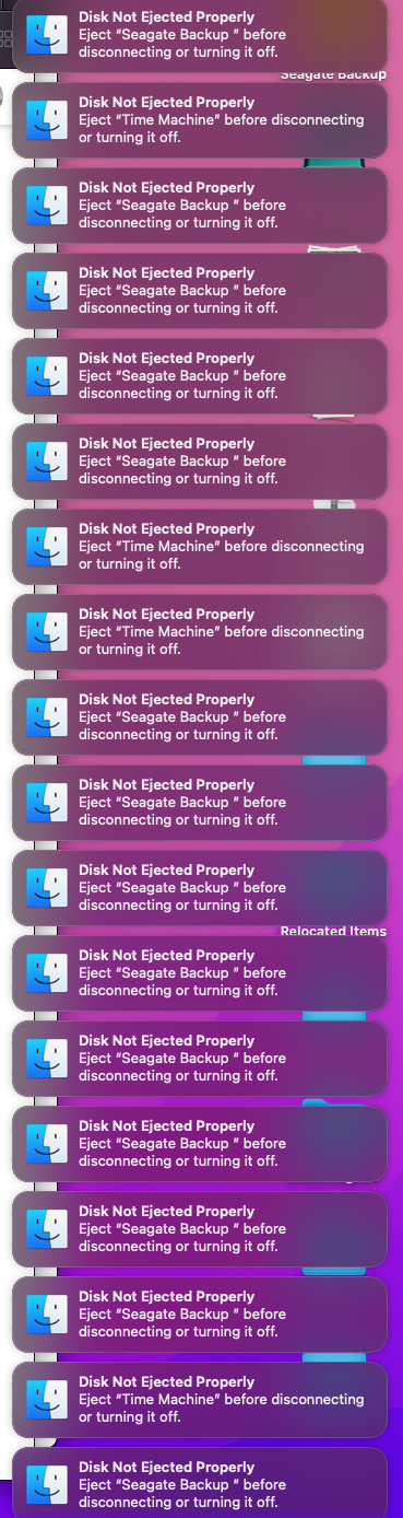

I have M2 Mac mini and I just upgraded to Monterey. I have a external Seagate 8TB hub attached via a Cal Digit Element. Ever since upgrading to Monterey, every time I wake the computer from sleep, I get a bunch of "Disk Not Ejected Properly."

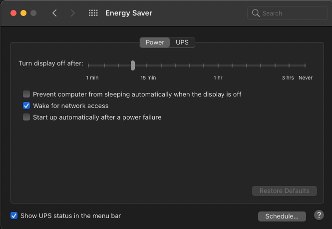

I've tried turning turning on "Prevent your Mac from automatically sleeping..." but no luck.

I have now set the energy saver settings to default which actually keeps the option to "put hard disk to sleep whenever possible" will update you if the default settings solve the problem or not.

After setting to default, the hard disk ejected again & strangely the option "put hard disk to sleep whenever possible" is not showing up anymore, it has disappeared from the options.

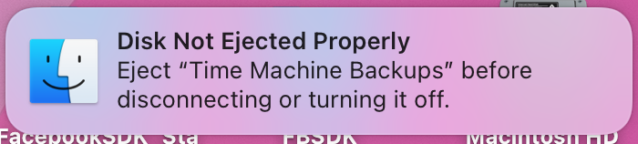

It isn't related to USB hubs. I've got a Time Machine server handling backups on my home network, and I get this every time my machine wakes from sleep. It started happening immediately after upgrading to Monterey.
