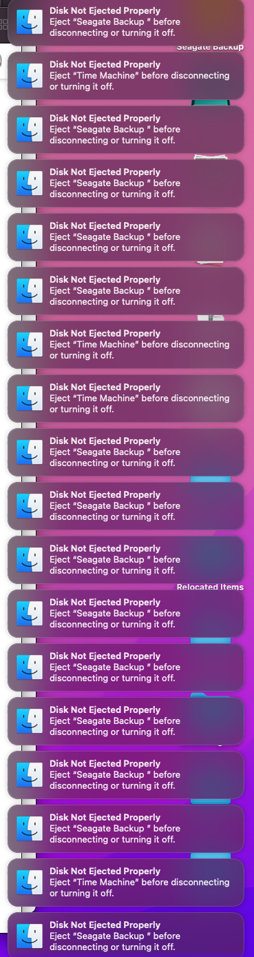

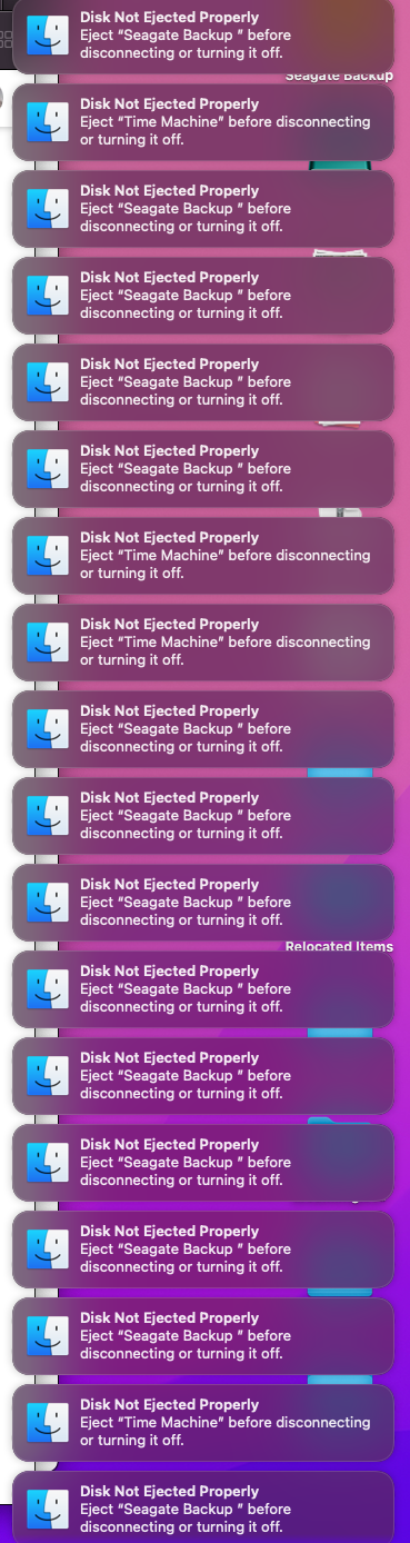

I have M2 Mac mini and I just upgraded to Monterey. I have a external Seagate 8TB hub attached via a Cal Digit Element. Ever since upgrading to Monterey, every time I wake the computer from sleep, I get a bunch of "Disk Not Ejected Properly."
I've tried turning turning on "Prevent your Mac from automatically sleeping..." but no luck.View attachment 1899604
