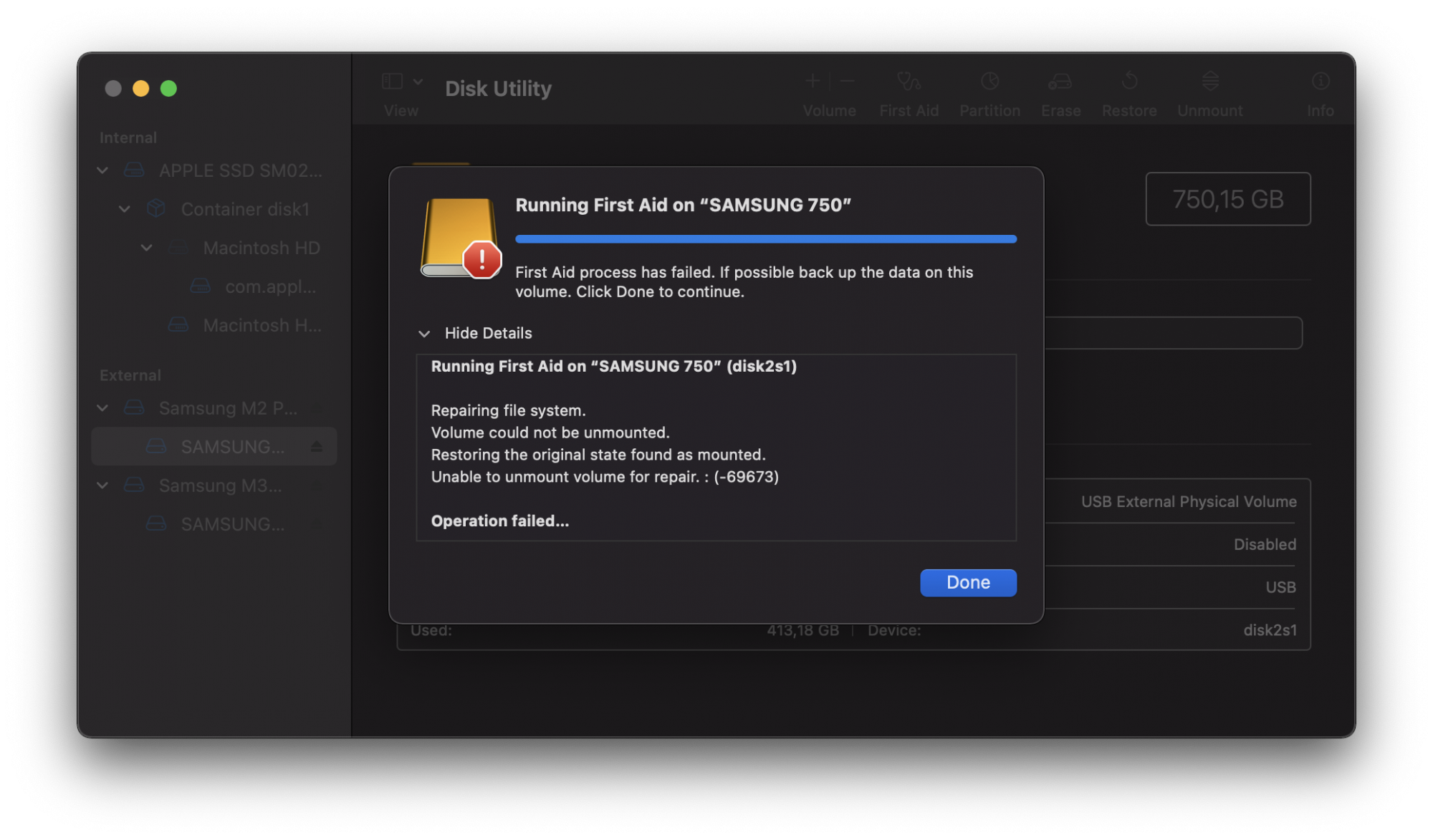

Hi,
Today I noticed my external Samsung HDD is very slow suddenly.
Itā€™s also impossible to eject it from my Mac (I have to turn off my Mac every time I want to eject it).
So I have run First Aid on it in Disk Utility. Hereā€™s the result:
What does it mean?
Is this disk unfixable? Is recycling it the only option?
Because it actually works, but painfully slow.
May formatting it fix it?
I have most important data from this HDD backed up elsewhere.
I appreciate any help!

How old is this drive? HDD do not last forever as you know I assumeā€¦
Sounds like the HDD is on its last legs. I would try to copy any data that is not backed up and then recycle as electronic waste.
What I'd do:
1. back up the drive
2. reformat the drive
3. run disk utility's "first aid" on the reformatted drive
4. do you get "a good report" now?
5. if so, I'd re-run first aid 5 times in a row
6. if I got a good report every time, I'd continue to use the drive, but keep it backed up!
