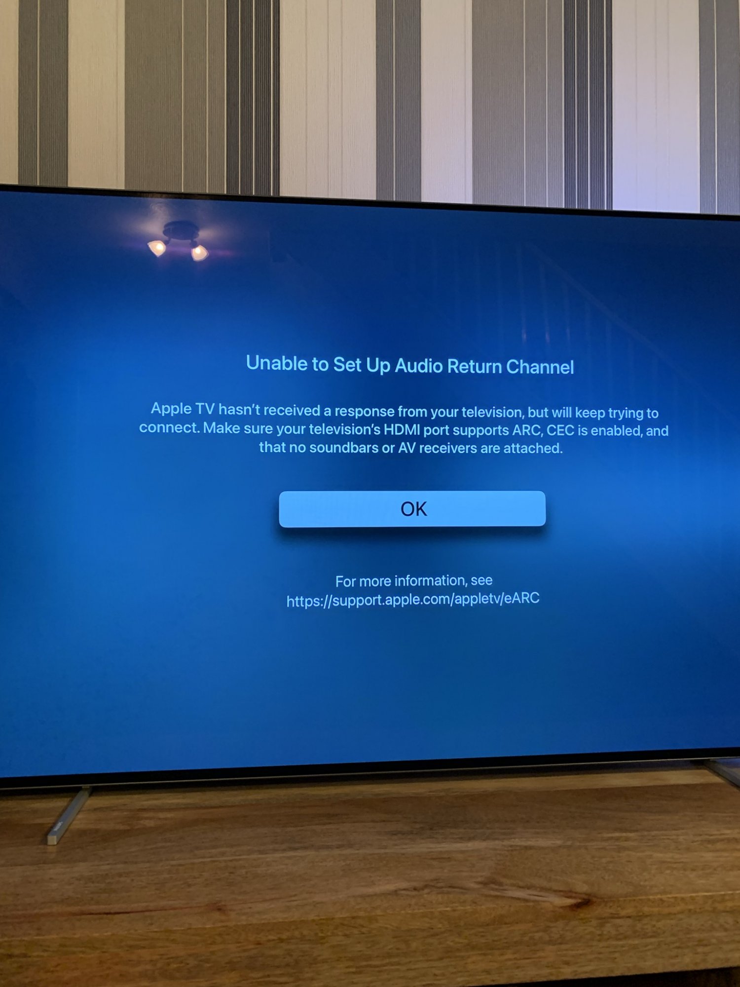

Done all that but still doesn't work. Here is how i connected it :
Any help?
I have selected Homepods as default speaker, have them connected to earc HDMI port, using Apples Belkin high speed cable. What do i need to enable for this to work and where?
I have a Sony Bluray player connected to Arc HDMI and I would like for sound to be played on Homepods.
TV is Philips OLED 806 if this helps.
Any help?
Can´t see your picture.

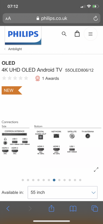

Connect the Blu Ray player to a non ARC HDMI, or disable ARC in that input. Enable earc only in the HDMI port of the apple tv. Go to your tv sound settings or HDMI settings, and try to find earc there.
Then, in the apple tv, go to default audio output, select the homepods, and enable earc below that.
I have attached the error picture i got and the connections i have.
ATV connected in earc HDMI 2
So where to connect Bluray player.
I will enable settings as you sad in diferent post.
