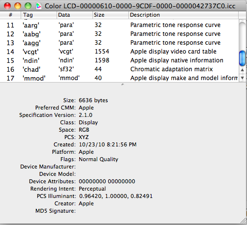

Look in System Preferences, Display - Color. Open the default profile, scroll down to bottom and look at make/model info.
I have a 9CDF on 13.3" MBA, manufacturer 0610.
Doing the ioreg shows LP133WP1-TPA1.
