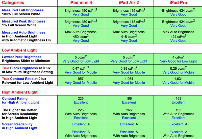

Each of the iPads has a similar max brightness, measuring in at 415 cd/m2 (nits) for the iPad Air 2, 424 nits for the iPad Pro, and 450 nits for the iPad mini 4. On maximum contrast ratio, the difference between peak white brightness and the darkest black, all of the iPads had high True Contrast Ratios, but the iPad Pro won at this test. The iPad mini 4 had a True Contrast Ratio of 967, while the iPad Air 2 ranked at 1,064 and the iPad Pro measured in at 1,631, the highest DisplayMate has measured for an LCD tablet display.

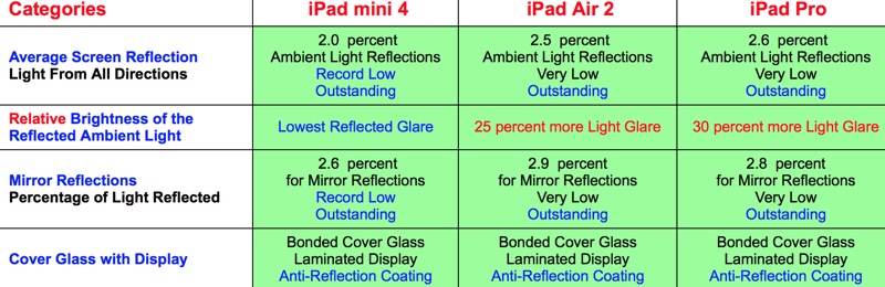

When it comes to screen reflectance, DisplayMate called all three iPads "unrivaled record holders" for performance in ambient light. The iPad mini had a 2.0 percent Reflectance, while the iPad Air 2 had 2.5 percent and the iPad Pro had 2.6 percent. A test measuring contrast in high ambient light saw the iPad mini perform best, with a Contrast Rating for High Ambient Light of 225. Comparatively, the iPad Air 2 scored 166 and the iPad Pro scored 163.

While the iPad mini 4 is the best iPad display based on DisplayMate's test, the site calls all of the iPads in Apple's current lineup "unrivaled" when it comes to screen Reflectance, giving them an edge over competing tablets. Due to their low Reflectance, the iPads have "by far" the highest image Contrast in ambient light and the highest Contrast Rating for High Ambient Light of all current tablets.
