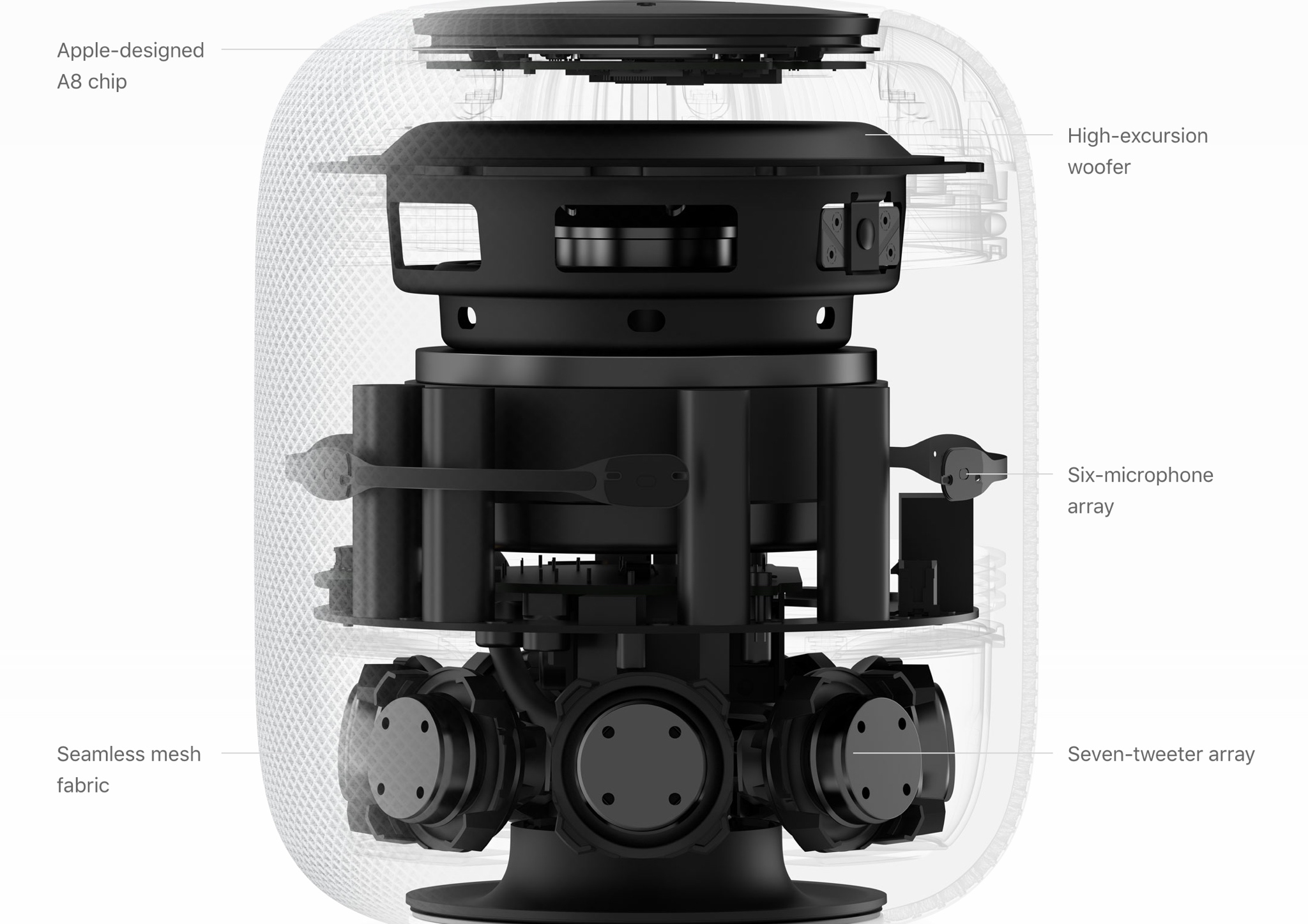

While the speaker is plugged in to power, pick it up and roll it around in your hands in all directions for a few seconds. Then set it back down.
HomePod has 6 microphones and the ability to hear and adjust the sound output if it senses furniture, curtains, carpet, or any other physical obstructions. Picking HomePod up and moving it around triggers the motion sensor to reset the microphones and recalibrate the output. Perhaps this corrects the low end rumble.
