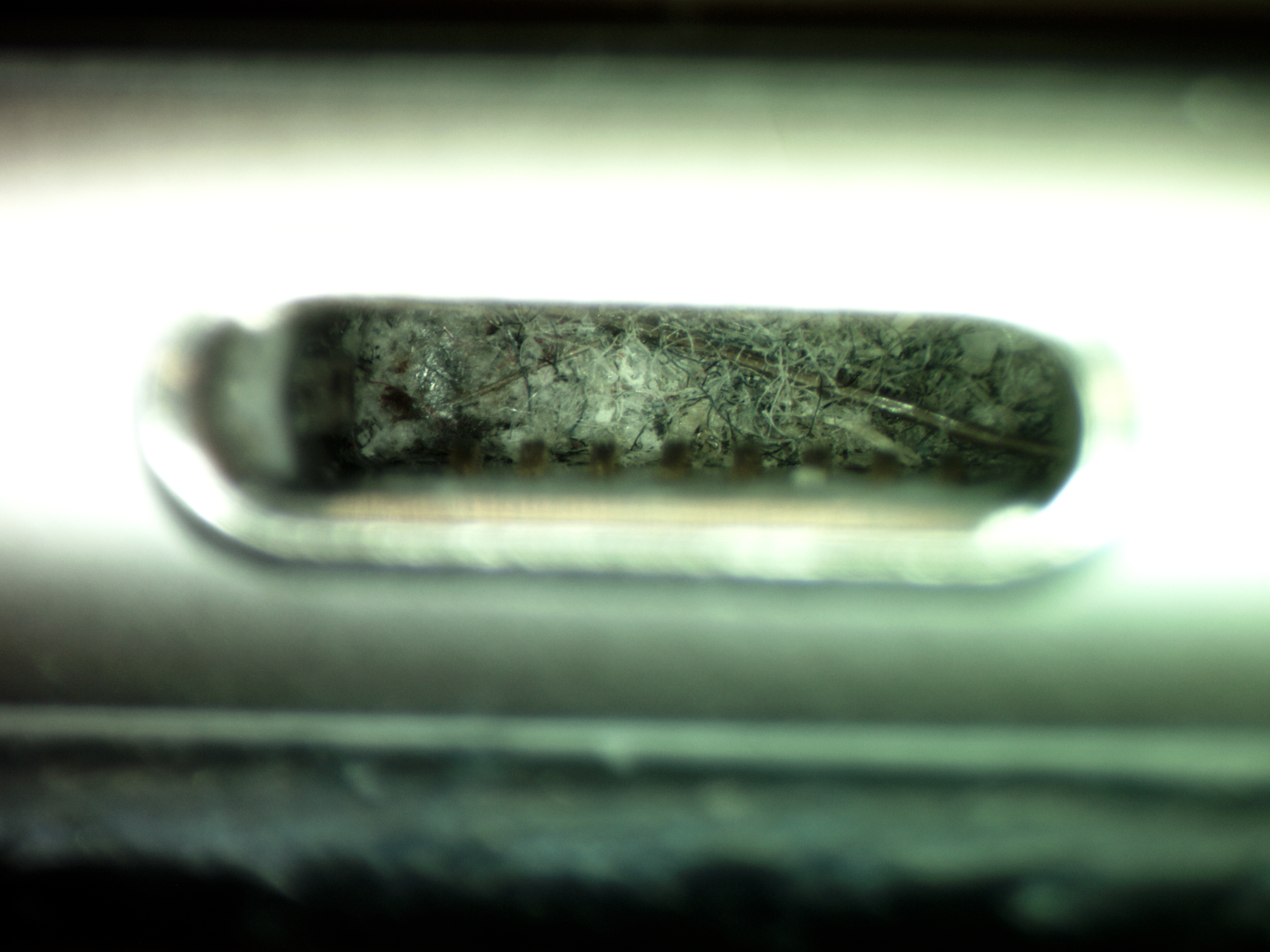

Yes thats normal. First time with iphone 6. the apple genius knew the problem and fixed it in seconds. Know i just do it every few months when it happens by myself
That's interesting. I wonder what kind of factors cause this, obviously clothing and possibly climate. I've never had to actually clean the port, the most I do is blow on it to get dust out.
How did they fix it?
They just cleaned out the dust from the connection port?
And with what tools?
A thin toothpick to get to the back of the port, a clean, thin paintbrush and a little bit of compressed air (like a camera lens duster) will make the port as good as new. Just don't scrape the contacts. The Lightning port is quite easy to clean and pretty robust.

A friend of mine has taken his to Geek Squad on two occasions to have his cleaned. He works in the building trades and also cuts grass and does landscaping so there’s a reason why his pockets and environments can be extra dusty and cause this.

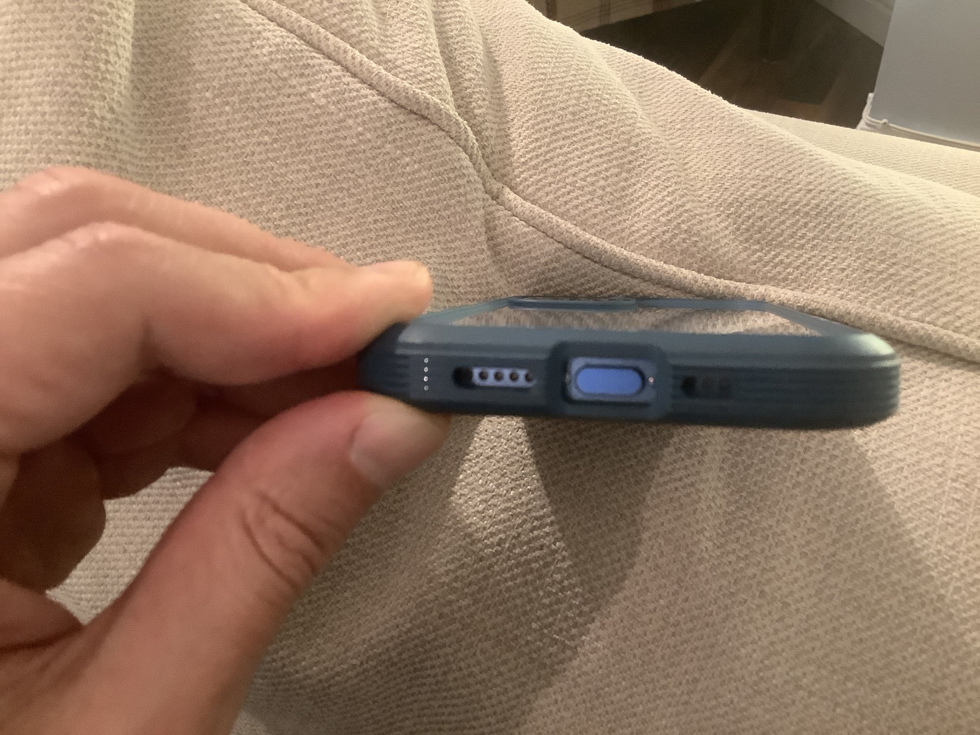

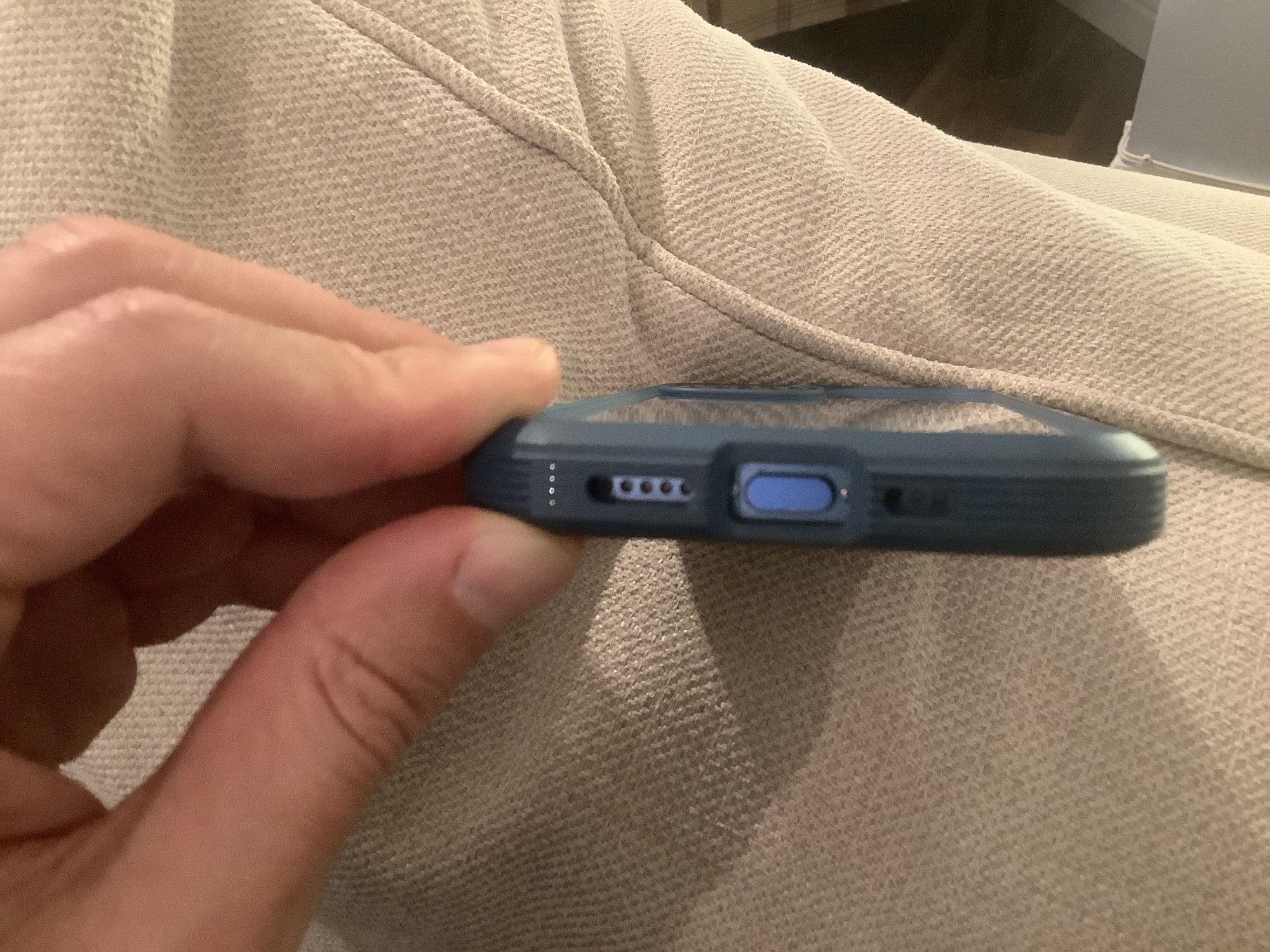

WOW, I love it when people do this. I did this on my Apple 14 Promax. I only use Megasafe charging. I don't like dust or lint etc. in the port.
Reactions: Andeddu
The toothpick cleaning seemed to work. I did this as gently as possible WITH THE PHONE BEING SHUTDOWN completely.
However, next time If I plan on cleaning the lint from the connection port with a toothpick again, how do I exactly position and move the toothpick so that I avoid scraping the contacts or to avoid damage to the connection port?
Is it going in a circular motion or just side to side motion once the toothpick is inside the connection port?
I did this as gently as possible but would like to know the exact method.
i would brush the toothpick along that bottom of the port and avoid scraping the long sides where the contacts are. You could lift the lint toward the short sides as there are no contacts there. Look at your lightning plug to see where the delicate contacts are vs the rest of the plug and use that as a guide.

The way I did it is by having the phone screen facing towards me. The phone should be facing the opposite direction?
Please someone post a picture on how the phone or the connection port should be facing when cleaning the port with a toothpick. I would appreciate it.

Can someone please post a picture on the correct way to position the phone when cleaning the connection port with a toothpick?
I did this with holding the phone with the display screen facing towards me.
From images I’ve seen it looks like the contacts for the lightning port are on the backside.
Still, I would use more of a side to side motion and stay away from the long sides of the port.
it really doesn't matter. I never ever worried about the port on any lightning iPhone when using wooden toothpicks, you can go haywire with them. just be cautious with metal or plastic picks
