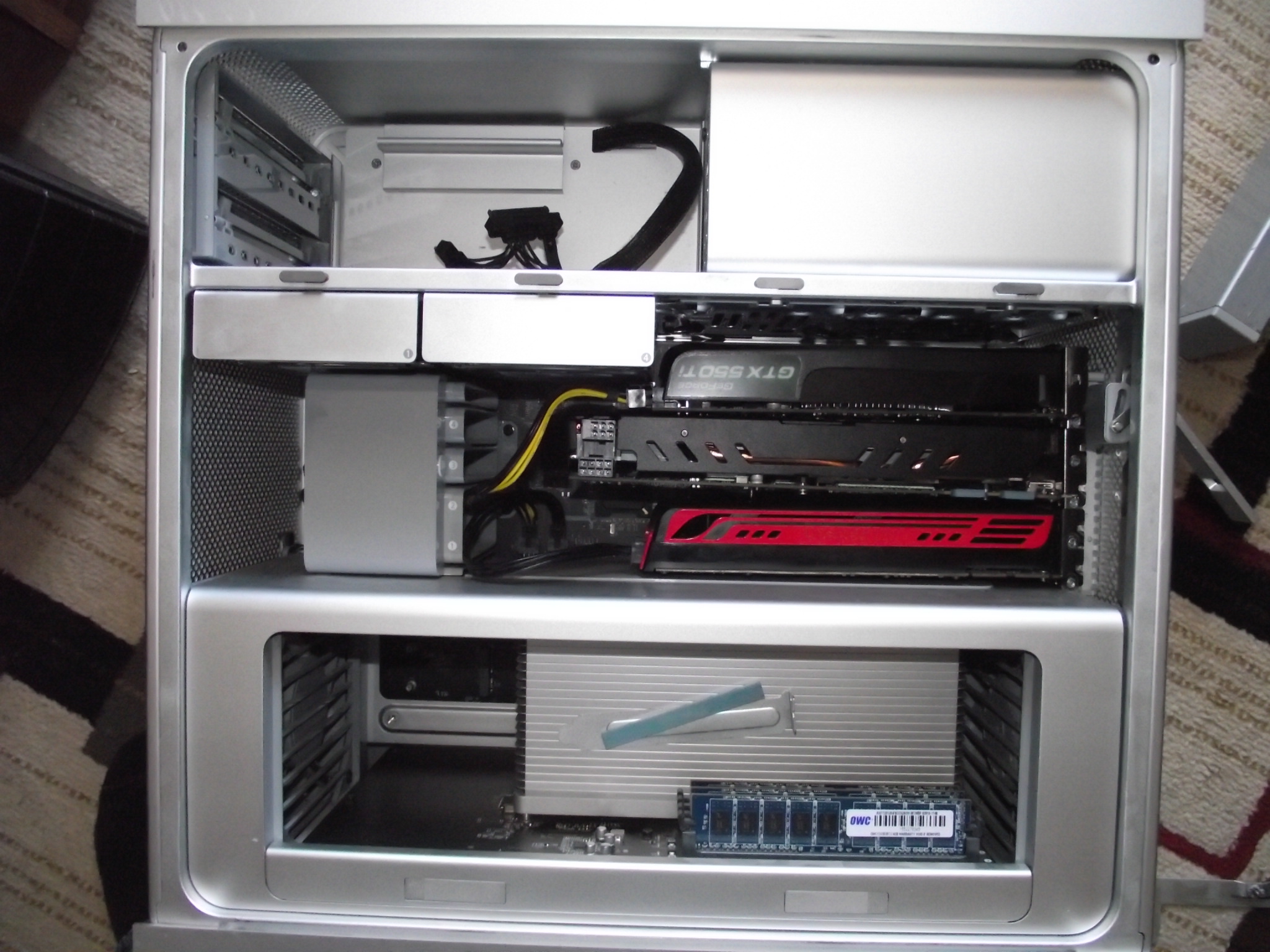

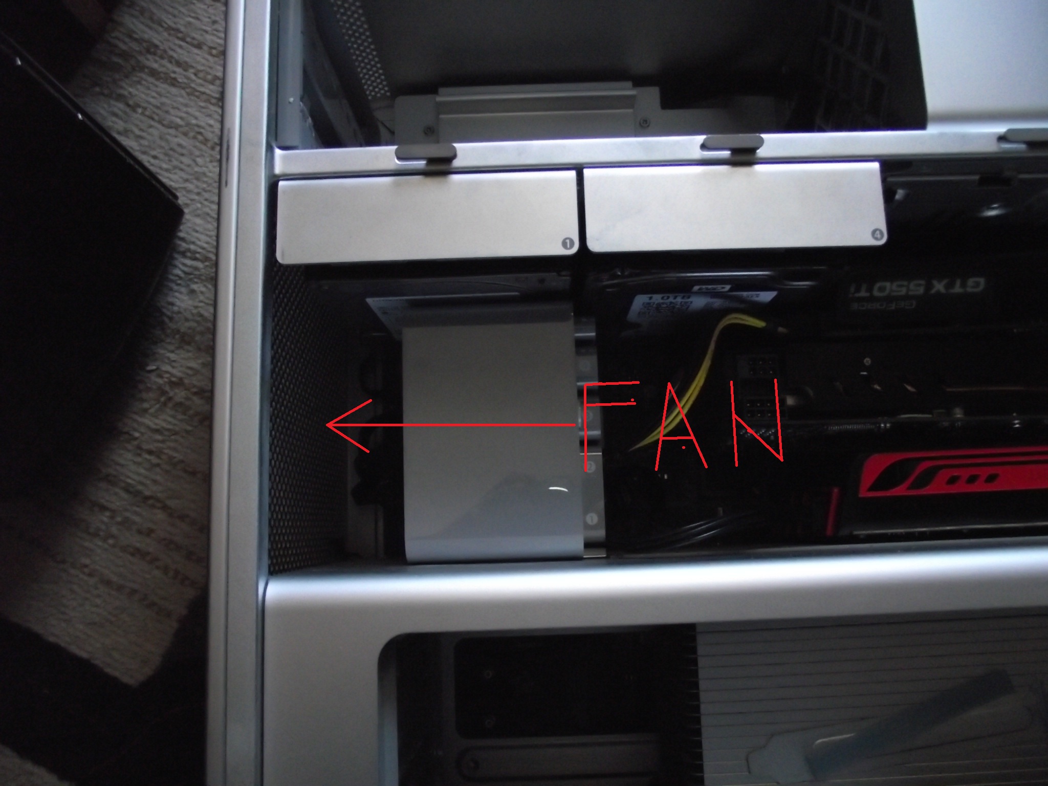

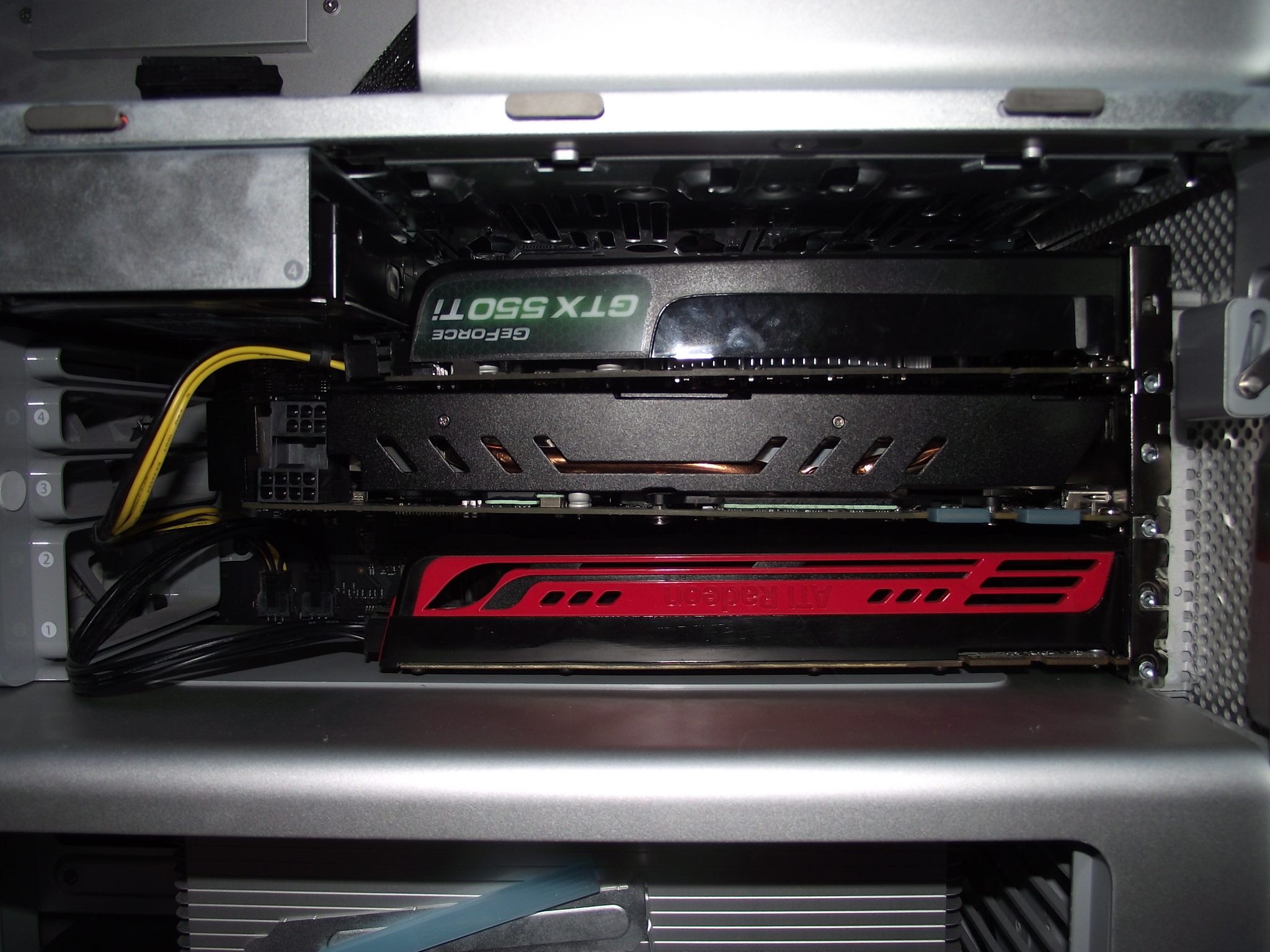

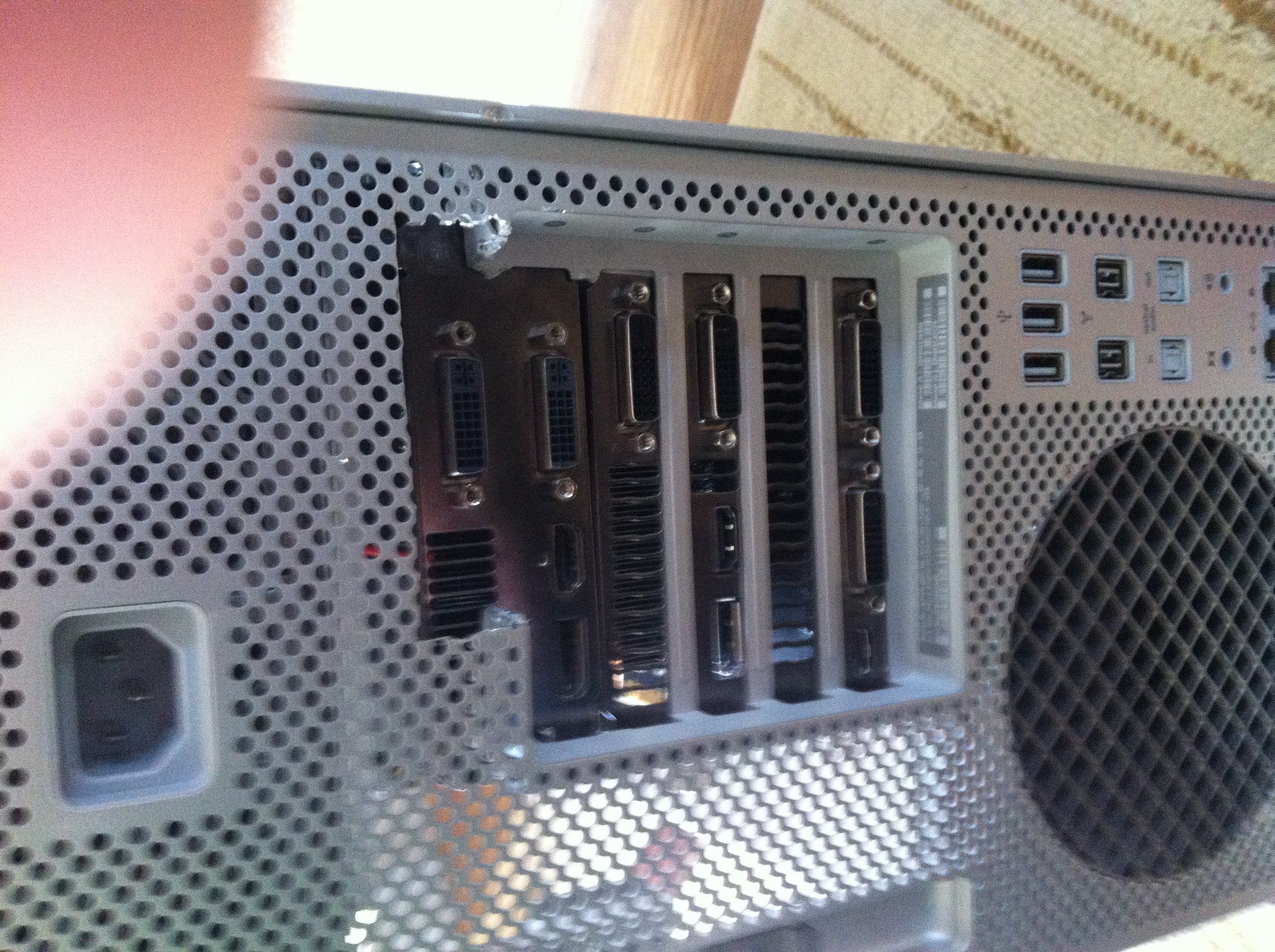

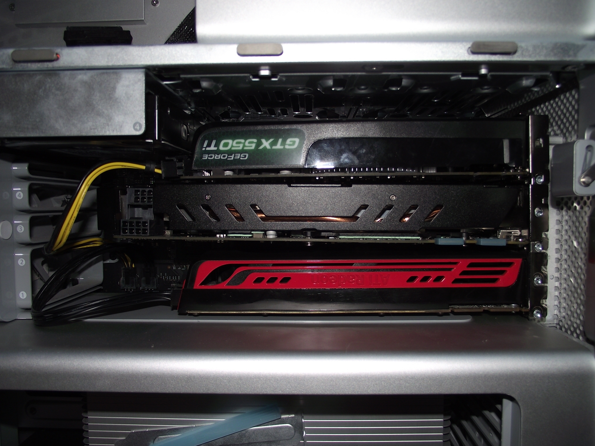

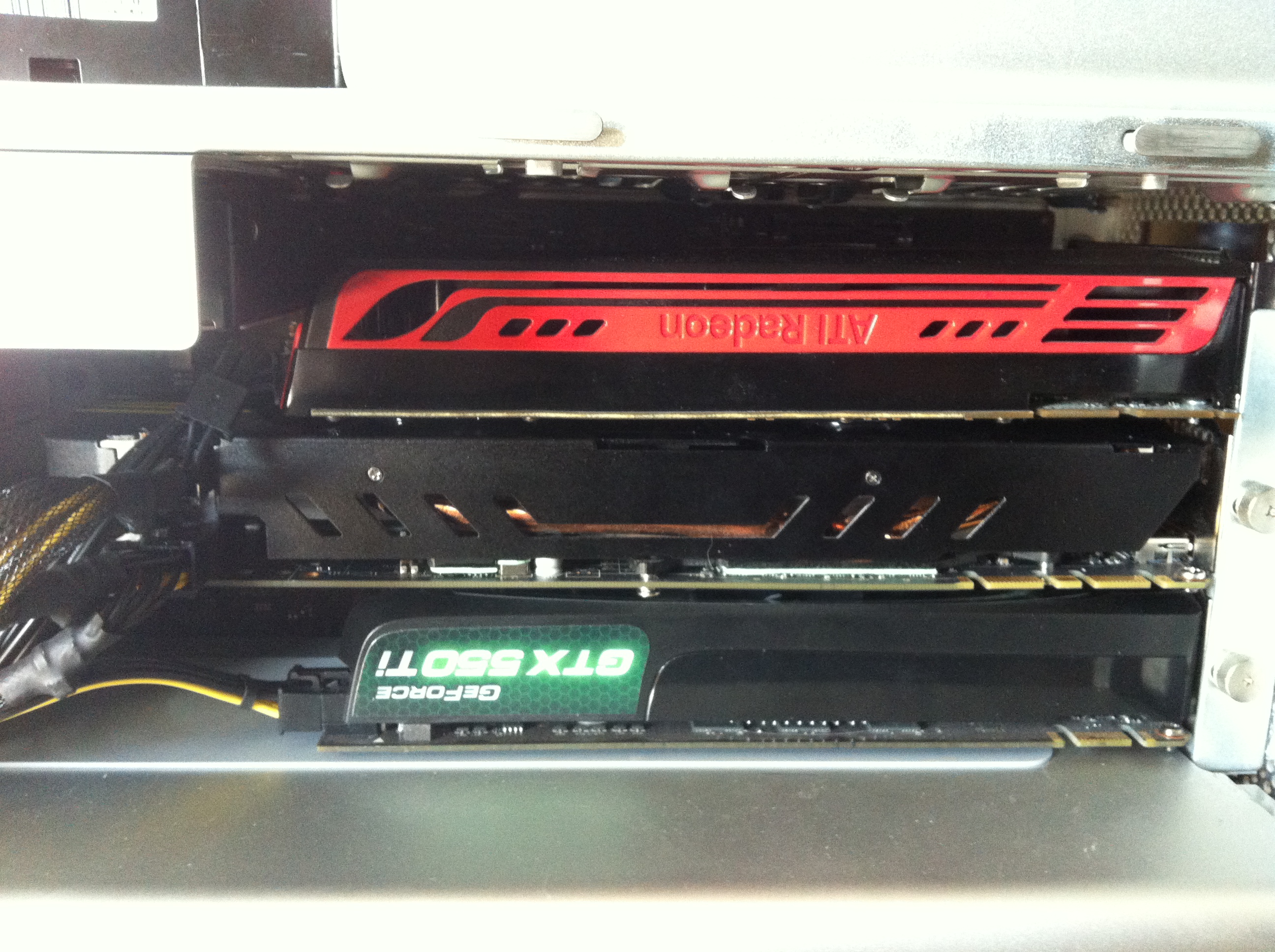

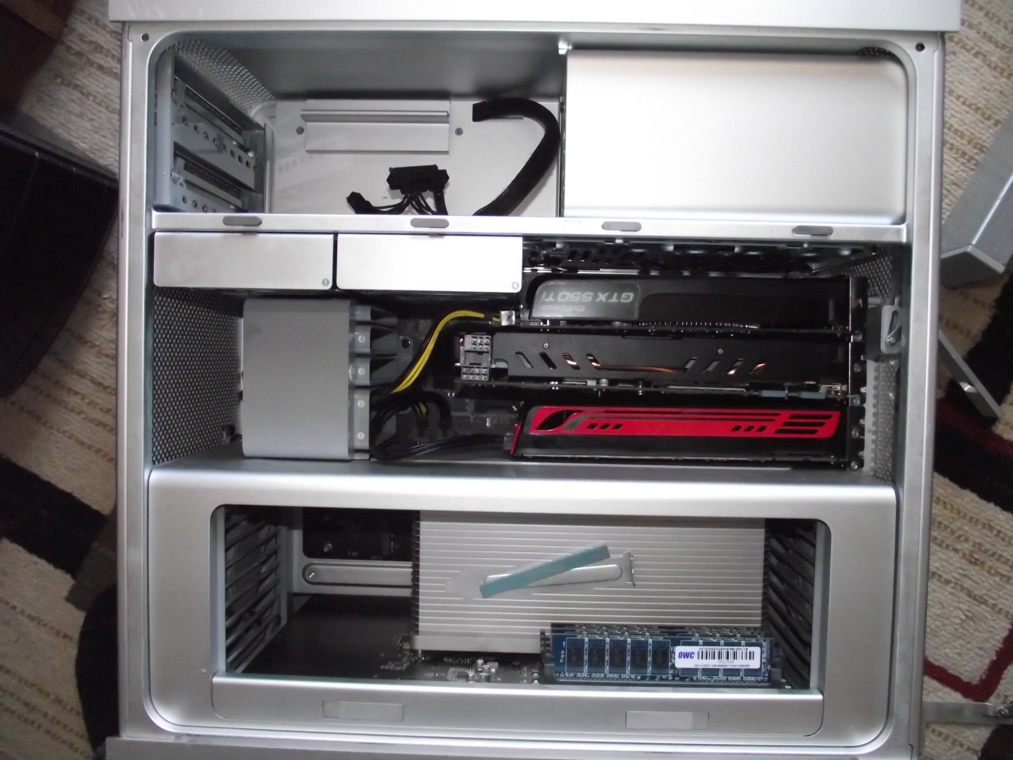

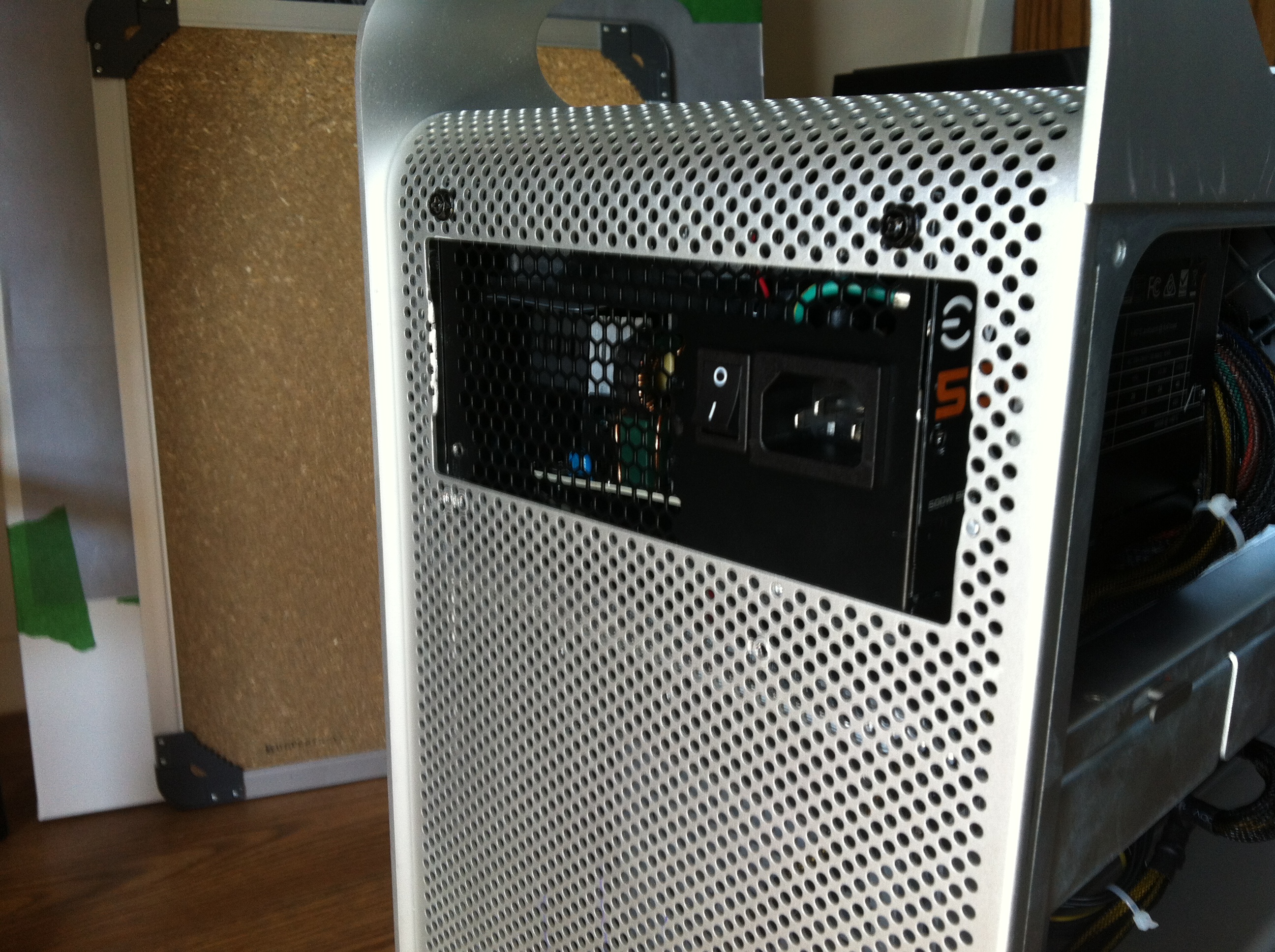

Hi guys ok i have i am graphic designer editor and colorist all rolled up in to one. I use Adobe products like premiere and davinchi resolve color grading program they both love cuda I have GTX550to on the top GTX770 4gb in the middle and Radeon 5770 at the bottom. I am going to instal power suply in the dvd space and 3th HD in the same space since i cant fit 3th hd in original space i have Sata Male to Female Data and Power Combo Extension Cable on the way for this. I have provided some images for you to see only issue i see here is heat i really don't have to keep my mac tray closed so heat wont be an issue i hope.

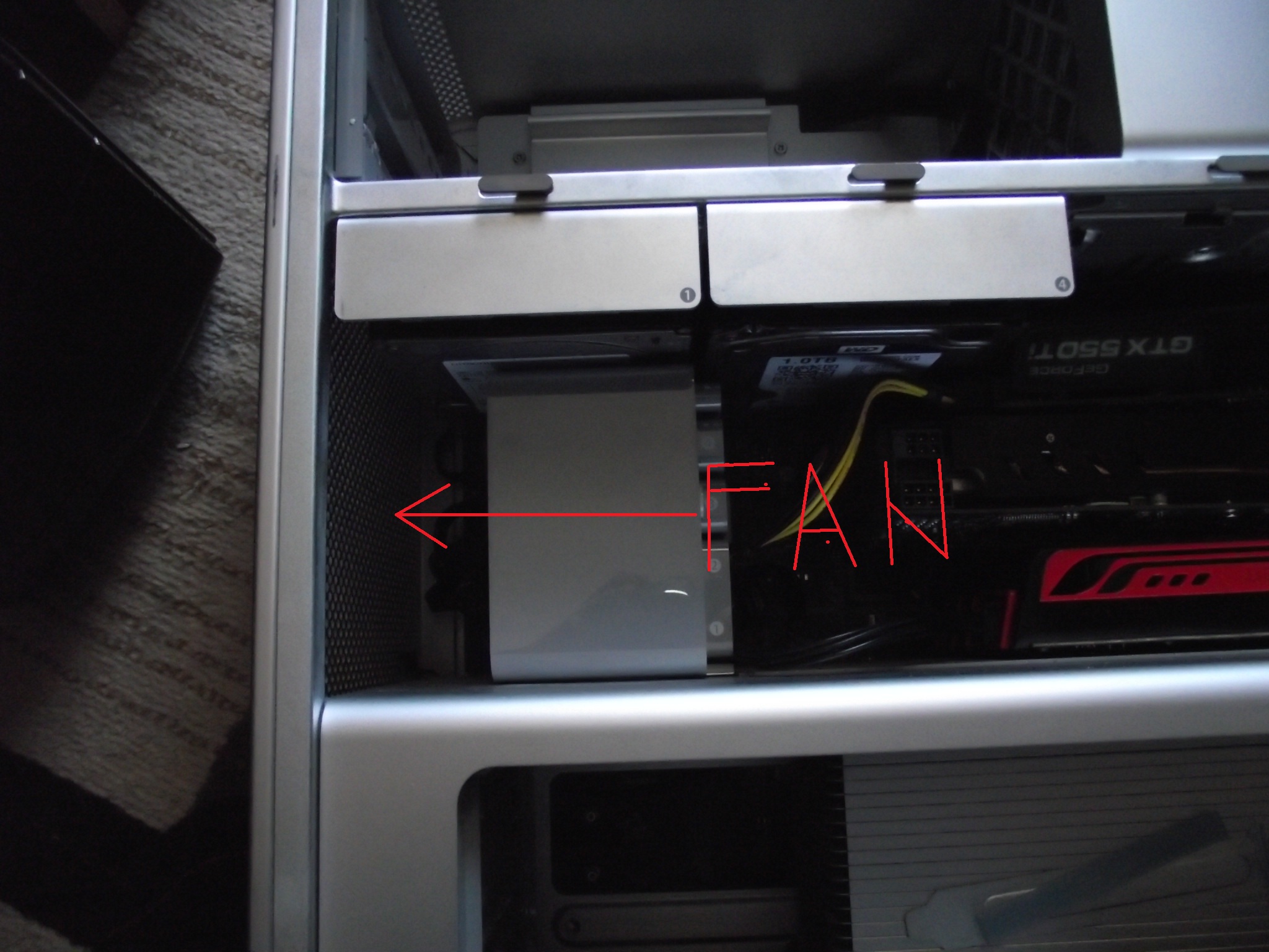

I am thinking of cutting a hole on a tray and adding a fan that will be connected to a second power supply blowing straight in to 3 graphic cards or a fan on the side blowing at the back of the cards
I am looking for some type if HD mini rack i just dont want to place my hd inside the tray just sting there
I been trying to find VisionTek 400372 450W Power Supply but its been discontinued i wonder if normal PW fill fit
Any info and suggestions will be appreciated thanks
PS i dont do any gaming just work on this mac

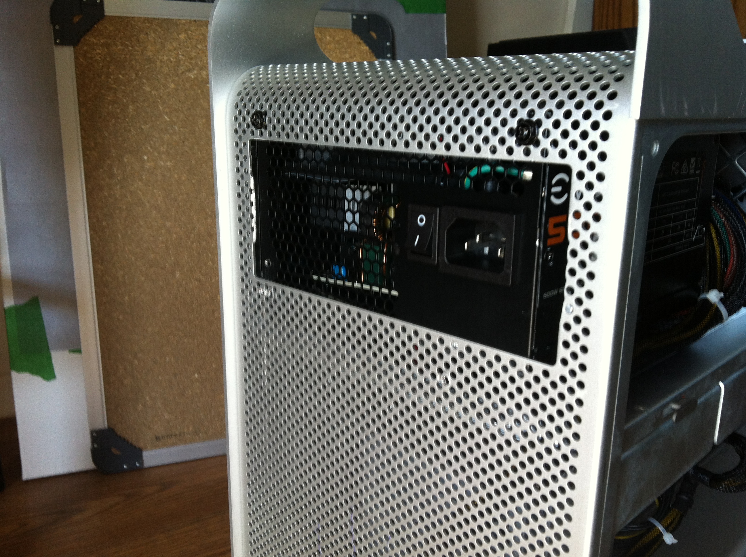

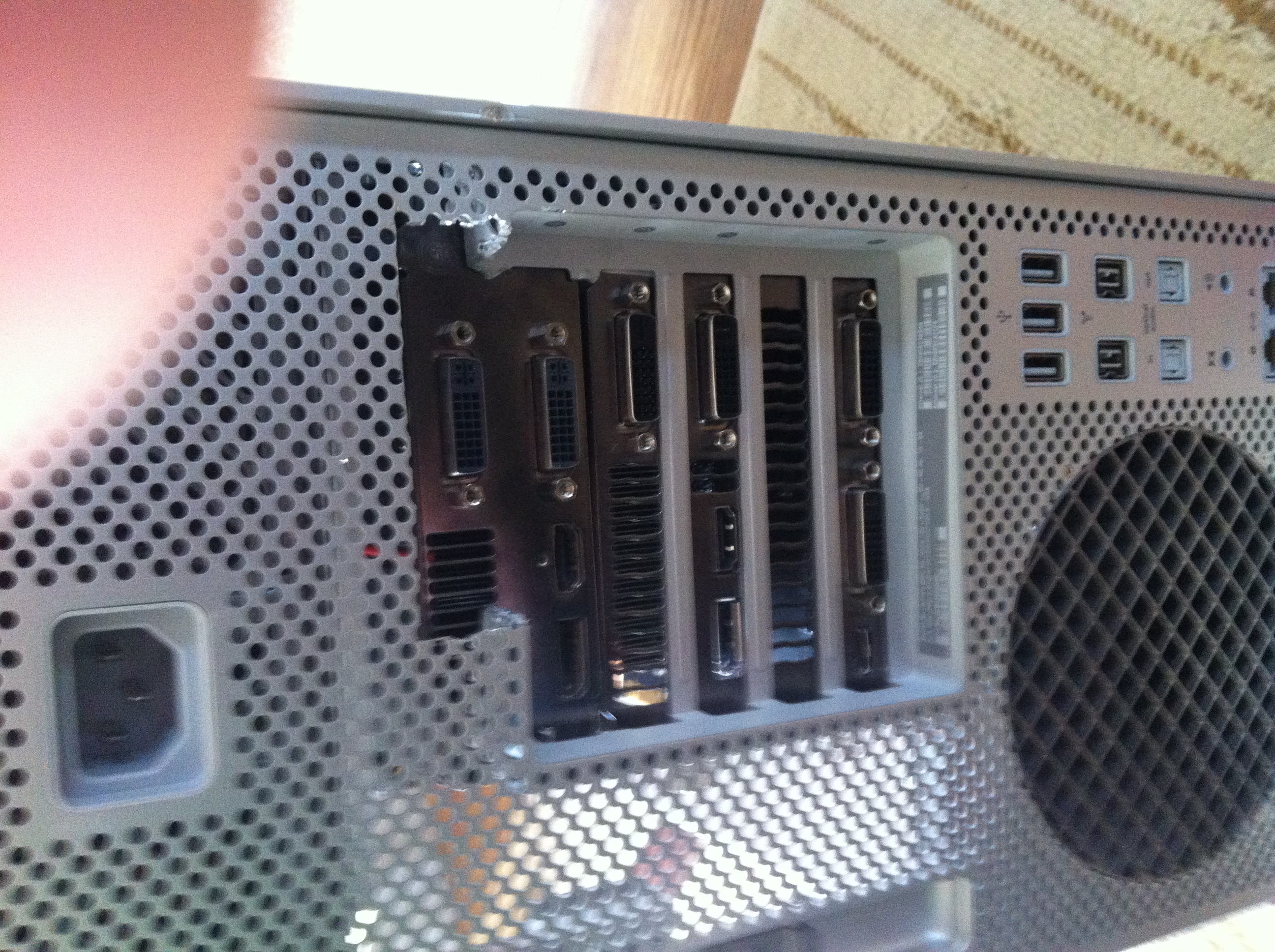

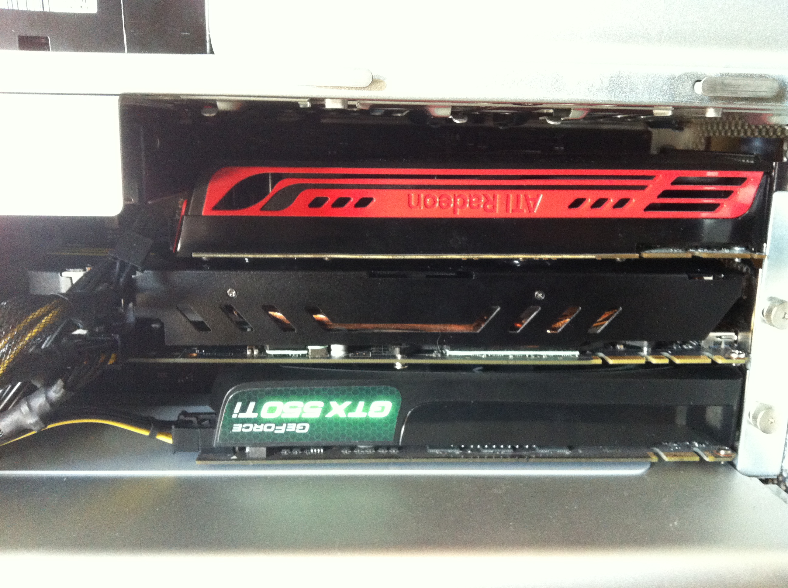

Its done so far so good no heat issues by cards stay around 41C even so close together.
