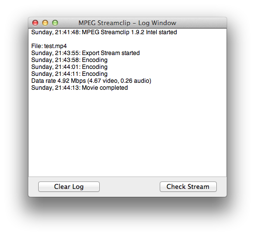

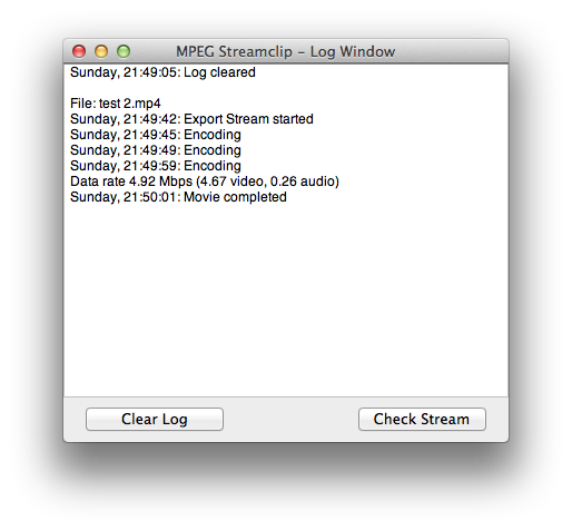

OK, here's one for you. Ran the original benchmark twice on my 2009 Mac mini 2GHz (RAM and storage upgraded).
Leopard - 3m 13s
Yosemite - 48s
Checked the log and Leopard is running 11 encode passes vs 3 on Yosemite. Wonder why?
I'm going to try the same handbrake test on the Mac mini just out of curiosity.
EDIT : 55m32s for the Mac mini. So 4.5 times slower which is in line with the GeekBench 2 (64) scores.

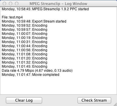

Here’s the dual 5675 Hackintosh on 10.9.5 so I’m looking a 2:25 but I also don’t see 11 passes.
Second run is much faster but I did it to see how much it would spike the processors and it never went above 10.83 percent.
...so I’m looking a 2:25 but I also don’t see 11 passes.

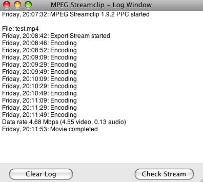

I've just bought a 1.67 15" DLSD Powerbook, its result is 10:07

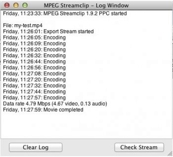

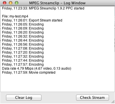

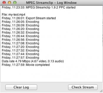

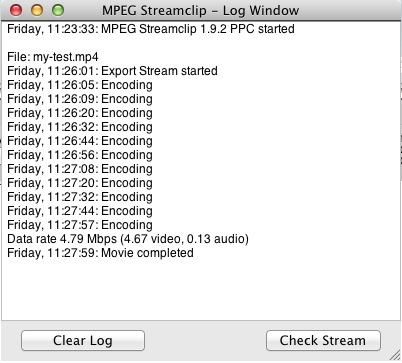

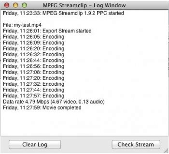

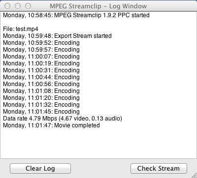

Just tried this benchmark test on my G5 quad, I've posted the log results hoping someone will interpret them for me.
Looks like 1:58 (27:59 - 26:01), which is what Dronecatcher got on his quad. Nice to see a repeatable test; thanks for trying it!

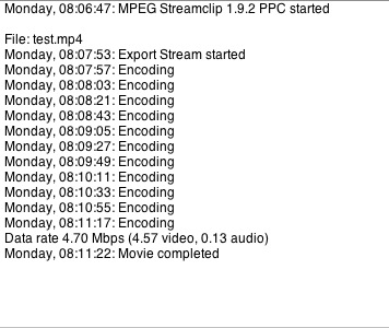

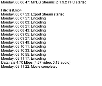

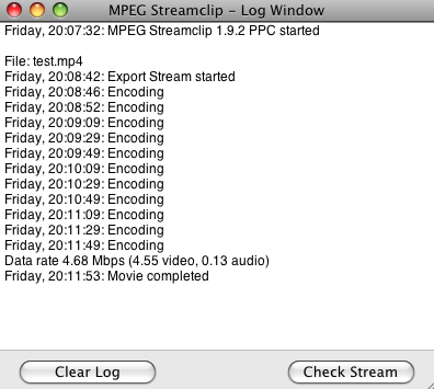

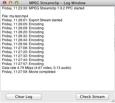

Something odd has happened and I have no idea as to what.
But last fall when I first ran your DIY benchmark I got a result of 1.58 min.
Now the best I can get is 4:09 min.
Same G5 quad with all the same settings.🙁

Now that is strange - exactly the same issue as me - mine went from 1.59 to 3.27. Apart from the possibility I might have had Quicktime 7.5.5 to begin with (though doubtful) the only other codec related app I've installed is Handbrake.
What version Quicktime are you running? Now that this test takes twice as long for me, a possible culprit might be Quicktime - I might have been at 7.5.5 when I tested originally.
It seems you were spot on about Quicktime.
I just downgraded back to QT 7.5 using Pacifist and the resulting improvement was instantaneous.
59 seconds, I can live with that.🙂
