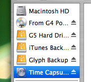

I believe that the software is installed. Am I looking for the Airport disk utility app?
Does this mean that I have the Time Capsule set up? If so, should I make a disk image and send it to the Time Capsule using Disk Utility?

That does mean that the Time Capsule is set up, yes. However, Disk Utility will almost certainly fail - you need to use dd, as ElectricSheep mentioned, to make a block-level clone image, and put that image on the Time Capsule directly, i.e. substitute /Path/to/recovery/point/ with the path to the Time Capsule.
