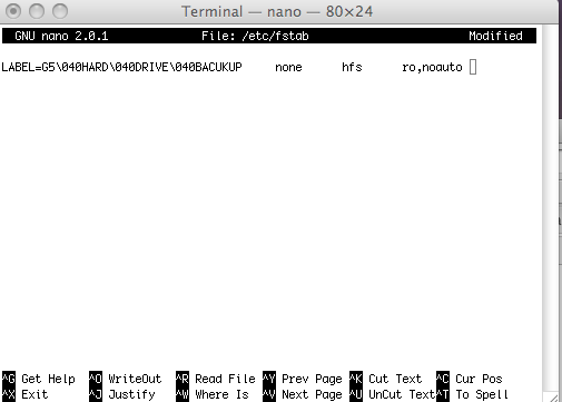

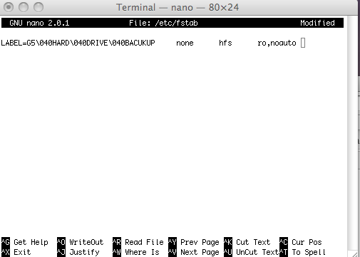

Ok. So I tried entered in the following
Code:
sudo -i
pico /etc/fstab
And then I got the GNU (?) screen in terminal. I typed in the script and hit enter. Nothing happens. What am I supposed to do here? Check out the screen shot... this is new ground for me.
Code:
sudo -i
pico /etc/fstab
CTRL+X
Y
[Enter]
Then it says
Code:
File name to write: /etc/fstab
and offers me some choices like ctrl+T to files and M-M Mac Format among others. What exactly should I do now?

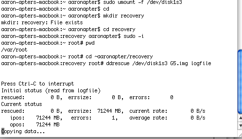

So I think I'm making some progress. I was getting frustrated with having to include TC in the whole equation so I attempted connecting my external HD straight to My MB. Luckily, this was one of the few times that the MB read the drive via USB, although it wouldn't show the contents of the three partitions. I entered a command in terminal to unmount the HD since DU wouldn't let me do it. Then I followed all of the commands from before and now I get this screen. Obviously it's doing something, although I don't know what. There is a "recovery" folder under my user name, and in 10 minutes the .img file is at 0kb, with the logfile being 18.2mb. My ipos, opos, and errsize are all at 4300 TB... what does this mean? Is it running slow?
Most importantly, will my G5.img be bootable or set up in a way that I can Migrate my apps? The most important thing for me is to be able to transfer my applications from this drive (the G5 clone that I am trying to save) onto my new MB.
The image will definitely NOT be bootable. However, assuming it opens, you should be able to transfer over everything you need by navigating it like any other disk.

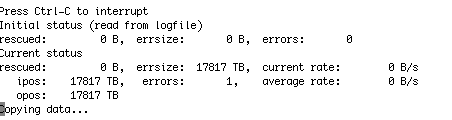

So will I be able to transfer over my apps? And geez, is this running painfully slow or what? All I have is 50mb of info (all in the text logfile, none on the .img) so far. Here's a screen shot of what has happened in the past hour and a half:
It looks like it's encountered a physical error on the disk - that's why it's not copying anything. All the bytes it's checked have failed with errors.
