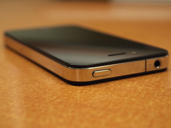

1) Tape up your Iphone 4 using blue painter tape. Wrap around the plastic edges as close as you can to the metal band
2) Wetsand with 2500 sandpaper until you get a slightly shiny finish, follow up with 3500 grit. You can also use a Green Brillo pad, or 0000 steel wool.
3) Using a microfiber apply the 3m rubbing compound, it will probably take four passes to get it good
4) Use Mother Power Metal to finish the mirror finish
And the money shots

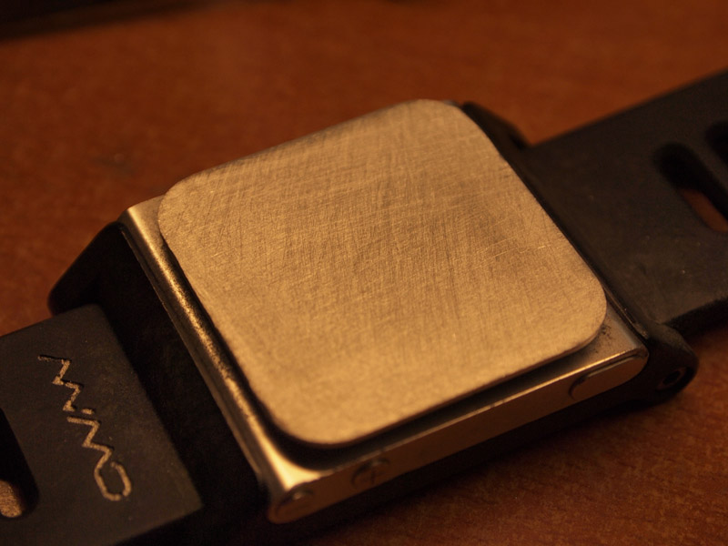

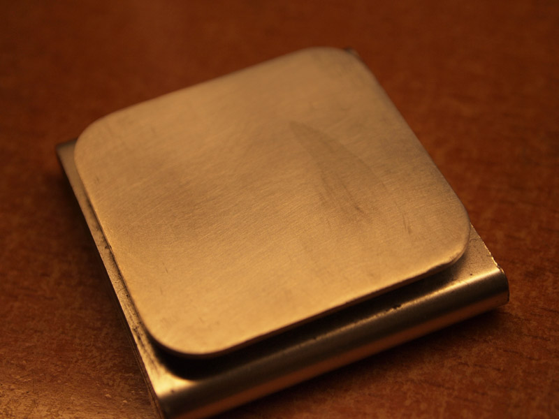

And that's pretty much it. But I decided to see if this would also work on Anodized Aluminum ( Ipod Nano 6th Generation)
Unlike the Stainless the Ipod Nano 6th gen is anodized = A B*#& to sand off. Only thing that worked was using a dremel + a sanding disk
Next 300 Grit Sandpaper

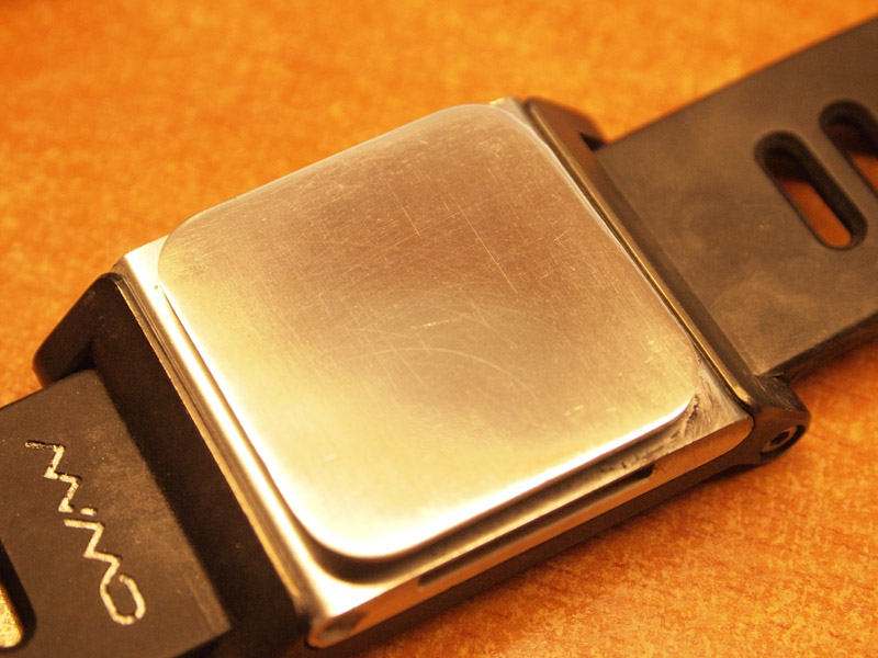

Then 800 Grit
Then the 3M rubbing compound
Finish with Power Metal
Unlike the iphone however, since I had to use a dremel to sand off the anodized coating, the finish is not perfectly flat vs the iPhone 4 finish that was already 100% flat and just needed to be brought up to a shiny finish.

how did you make sure you didnt get any compound/polish under the vol buttons and in the silent switch etc etc
very good work btw, whats it like for flying out your hand. i find the std iPhone pretty slippery myself
The 0000 steel wool is great stuff. I use it on my chrome wheels to polish them with soapy water. I want to do this since I'm planning on keeping the 4 until my contract runs out. Have you noticed any corrosion from hand prints or anything? Looks good, I like it.

All the wetsanding and polishing was done by hand, so it was easy to control how much water and polish was applied. I imagine using a buffer would be a bad idea since you would get compound in the buttons and holes.
The hardest part was wetsanding with the 2500 and 3000 since you have to fold the paper in weird shapes to get around the buttons
