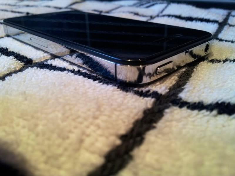

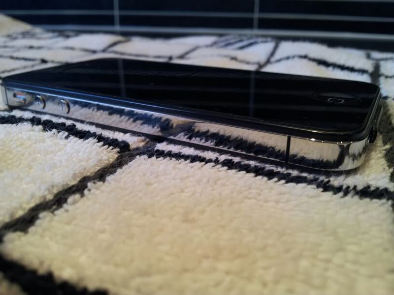

Got my 4s done today, been searching to see if it's possible and came across this excellent write up, there's something very wrong with sanding a 1 week 5 day old iPhone 4s 64gb but I'm very happy with the results :-

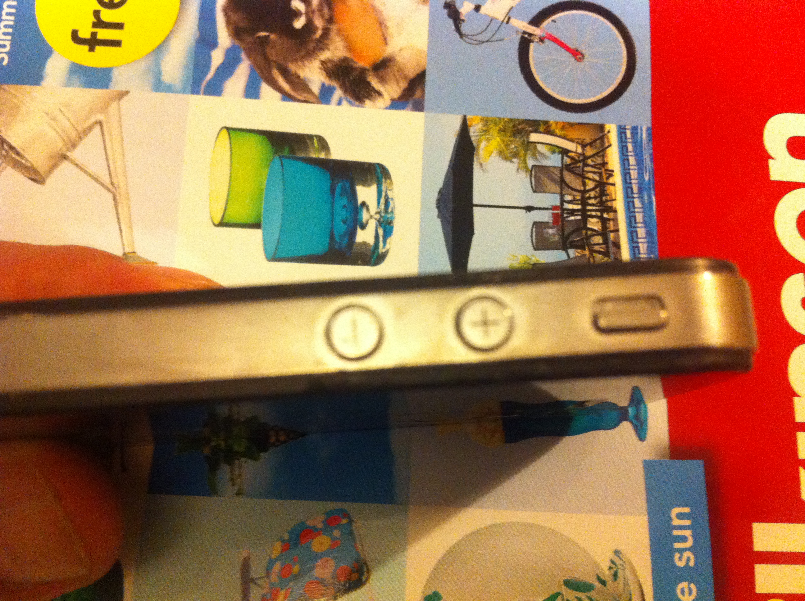

nice bit of work, i'm doing my at the moment and i seem to be having problems around the volume buttons. i can't get it to match it to the rest of the bezel. any idea's without taking it apart!!!!:)
here is photo as you can see about 2mm around the volume buttons.
please bear in mind i haven't apply compound or polish yet
Fold the wet/dry small and you can get round the buttons or a thin piece of flat wood to wrap the wet/dry round.
I used a sanding block to put the wet/dry round to do the majority of the work and you can also do the buttons this way as it won't round the edges off the buttons.
If put very minimal water on the wet/dry and pat it off on some kitchen roll to take the excess off so the papers just damp, you can get a near on mirror finish with the 3000 grade.
When it comes to the compound I used Autosol metal polish, put a small dot on your polishing cloth and then rub it with your finger so any excess polish rubs into the fibres of your cloth then start polishing your phone and you shouldn't get any excess polish in speakers / buttons, it takes time and aching fingers.
As for warranty it shouldn't affect it, you've only polished the edges up and as long as you don't get any water/polish into the phone you haven't damaged the phone, only thing is you may have to hand your phone over to get a new one so all the hard work would have to be done again.
have to say, that looks awesome.

Oh brave attacking your new 4s!
I've done a few 4's now, my original one which later failed (speaker failed) and my current one which is workin great.
Few comments to add..
1 - I had my polished 4 swapped at apple, no questions asked of its shiny band!
2 - the mirror finish shows finger prints real easy so it's worth every so often giving it a wipe over wit a micofiber cloth.
3 - I polished mine up less than carefully an it's given the buttons a rounded edge, I prefer this but if you like the square edges then use a small bit of sand paper to polish around them carefully.
Good luck :)

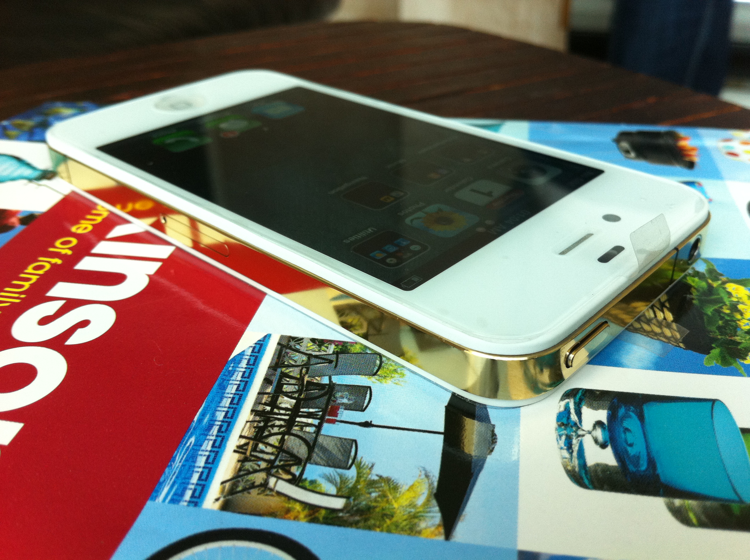

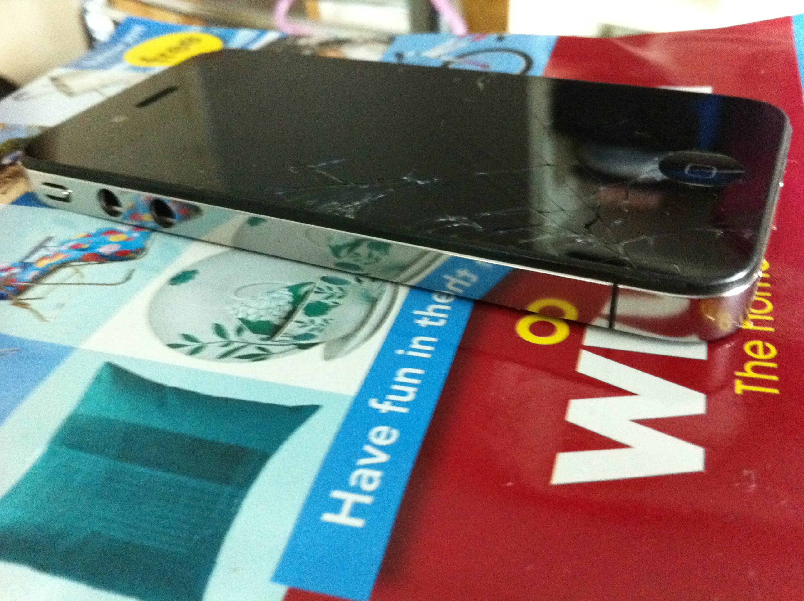

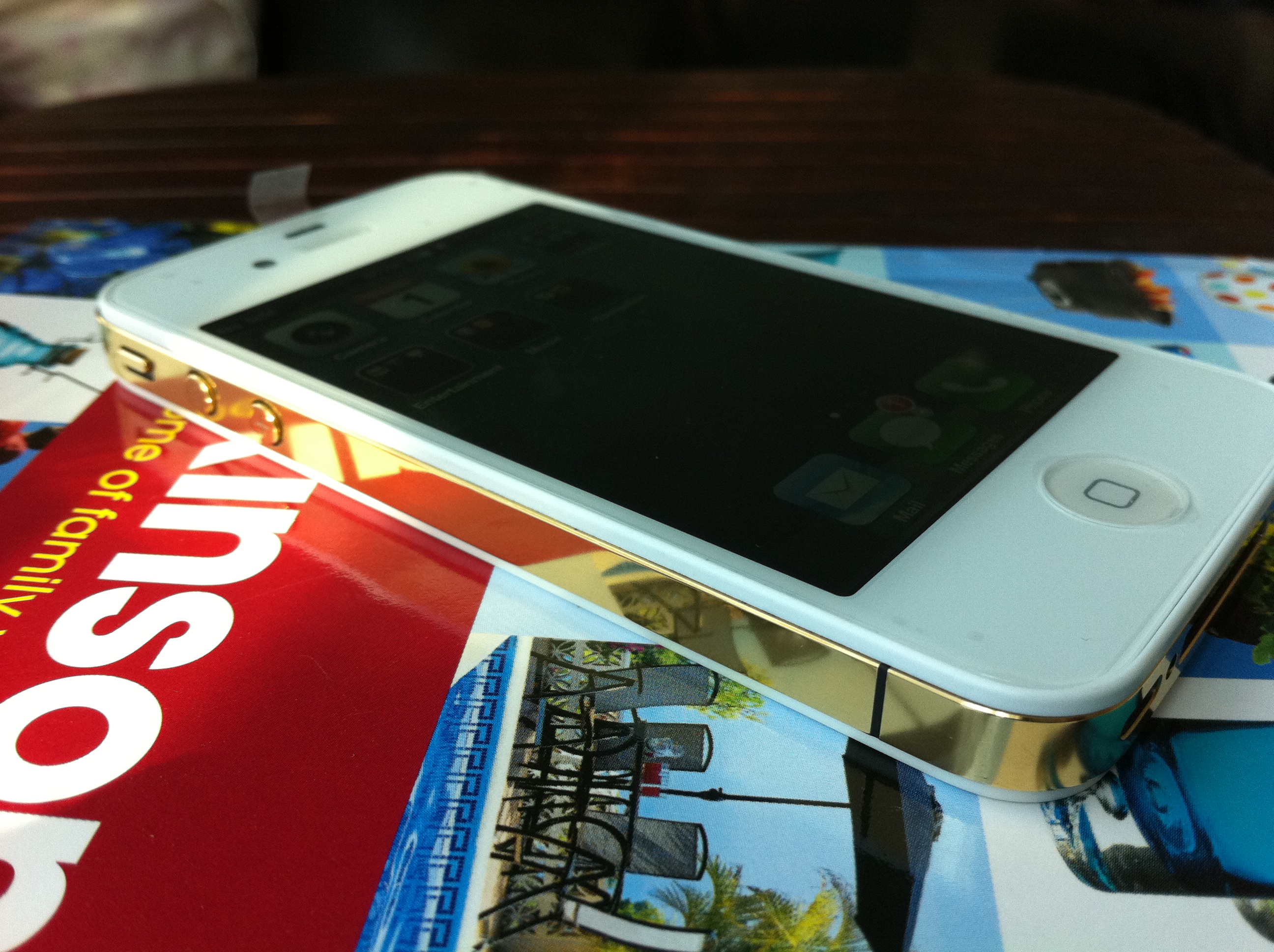

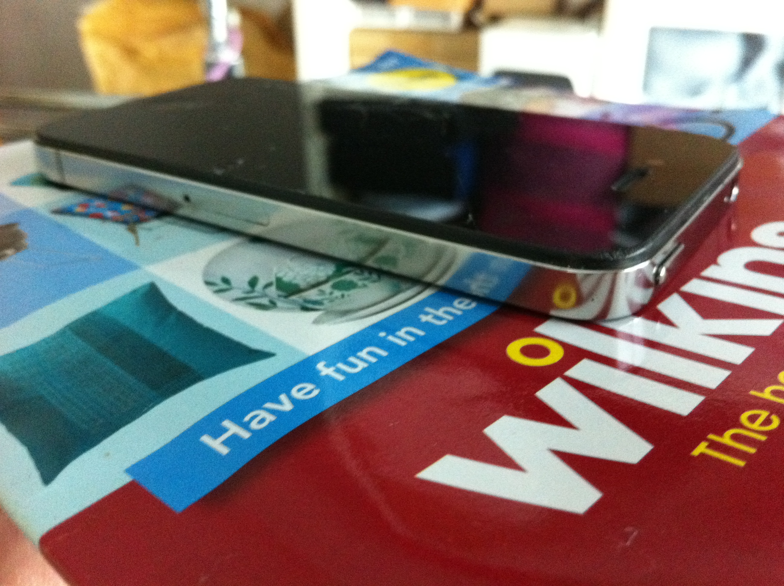

here a follow up on what i did
things i used.
3000 grit wet & dry
dremel tool with buff and polish wheel
and on this I've used auto glym metal polish.
(will try zeppelin polish next time)

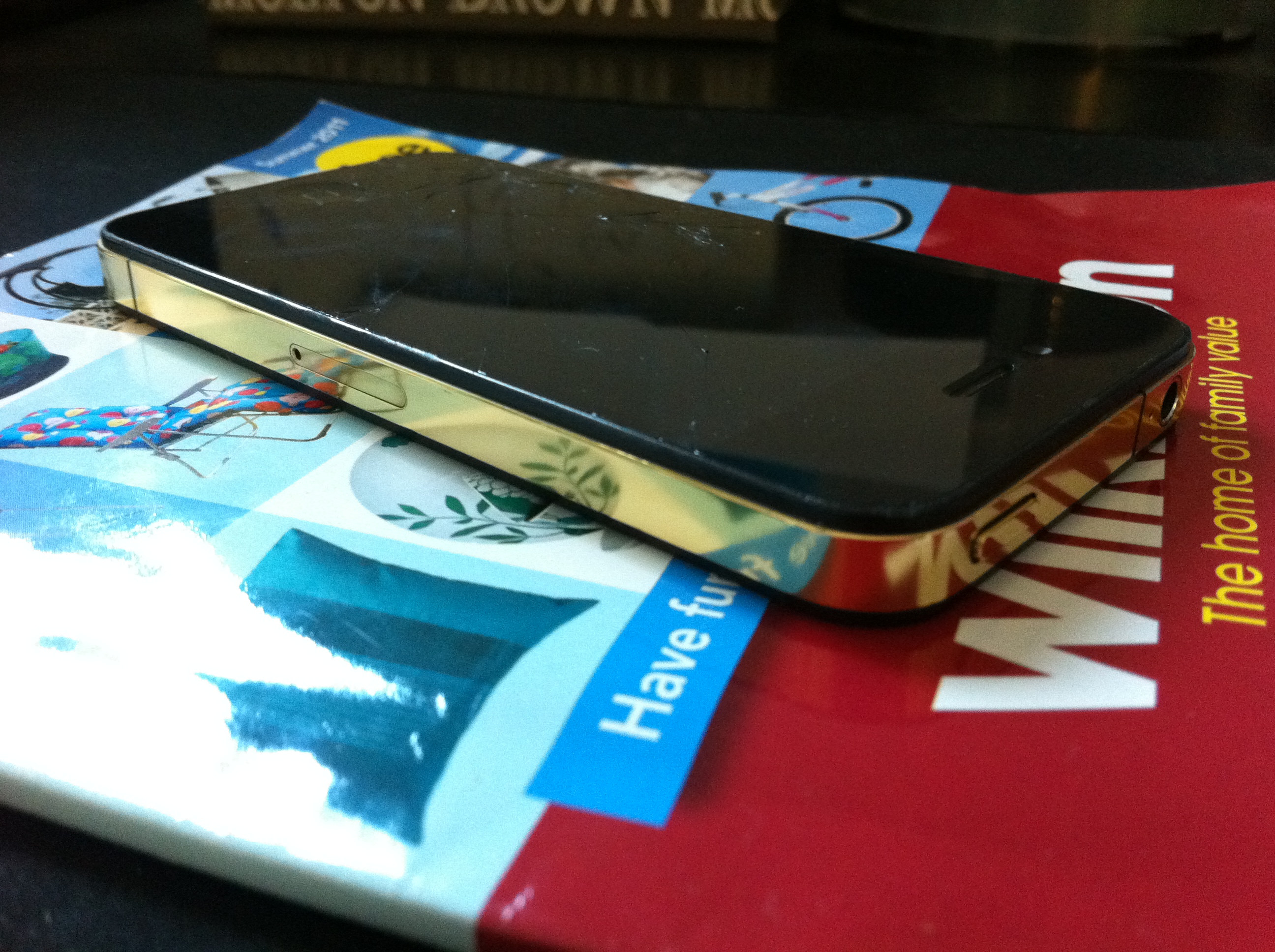

as i was going to change the screen, i took the volume buttons out and sanding and buff the bezel finally polish
then i gold plated and converter the phone from cracked black iPhone to white and 24ct gold bezel.
as this was my first attempt at polishing, i think i still need the some more testing with other compounds and polish to get a total mirror finish,
any advise would be much grateful :D
Reactions: Arkid77
Looking good, did you gold plate your original surround that you polished or did you replace the surround completely with an new gold plated one ?
