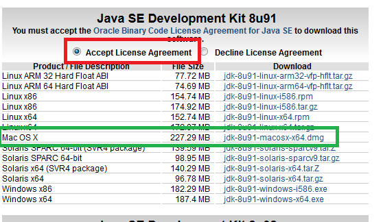

Secondly you can follow this link and then download the OS X SDK to see if this makes a positive difference. Just accept the licence agreement and install the Mac OS X version.
Once you have done that, please can you restart your Mac with the option 'reopen windows when logging back in' disabled (unticked), and advise if this makes a positive difference?
Thank you in advance for your patience.
