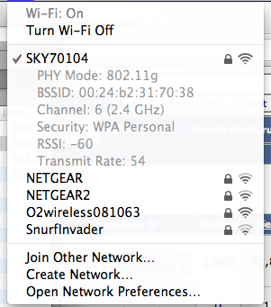

Hi,
To see your current wi-fi signal you need to alt click on the wifi icon in the top right corner. The figure that is important is RSSI. The closer to 0, the stronger the wifi signal. The only problem with this is that the figure does not update as you move around looking for the best signal - you need to move then alt click again to see the figure.

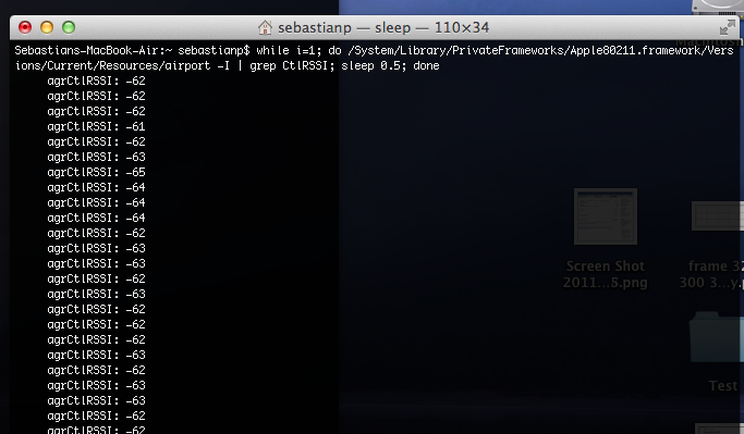

So I've written a script for you to do this.
Open terminal then type in this
Code:
while i=1; do /System/Library/PrivateFrameworks/Apple80211.framework/Versions/Current/Resources/airport -I | grep CtlRSSI; sleep 0.5; done
Then hit enter. You'll see output like in the screenshot below and it will change as you move around. Again, closer to 0 = strong signal. Once you're done hit Ctrl+C on the terminal to stop the script

Thanks - works just great.I see -62 in my bedroom, -82 at the armchair in question, and -72 when I shift o the adjacent armchair.
