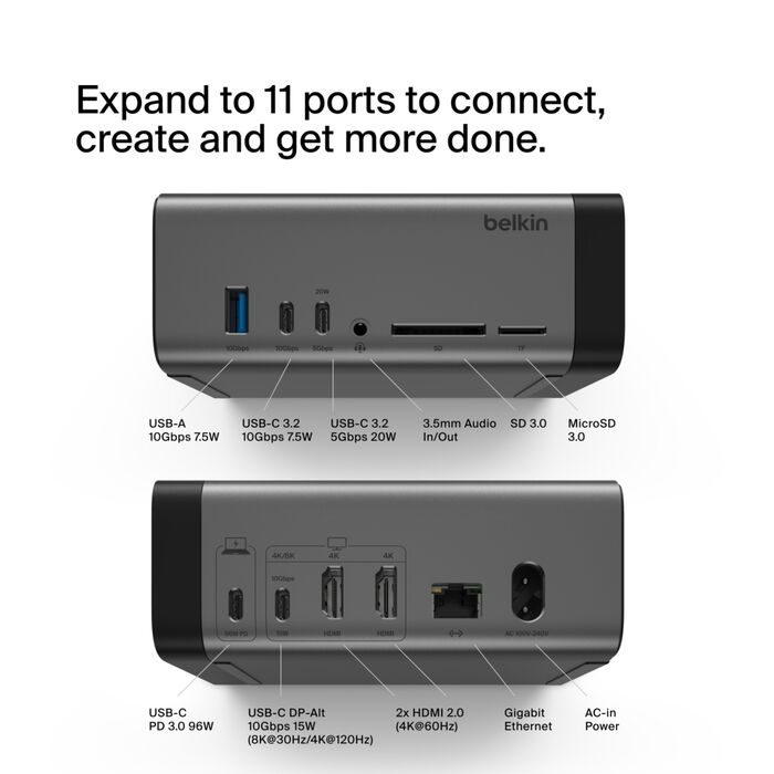

Does this mean I can still use the Belkin Hub with one monitor, and one Thunderbolt USB-C <-> DisplayPort Cable for the second display (that I attach to the second Thunderbolt port on the MBA)?
Slight nitpick - the missing tech isn't "Display Port Alt Mode" (Macs support that - it's how any display works off a USB-C 3.x dock, and how you can connect a non-TB display to a TB3/4 port). The problem is Display Port Daisy Chaining via MST (Multi Stream Transport) which MacOS doesn't support.Reason multiple external displays work with Belkin hub and Windows is support for Display Alt-Mode, which Macs do not support.
With any hub/dock offering multiple display connections you really need to check the specs from the manufacturers to be sure that multiple displays will work on Mac. Often these either rely on MST daisy chaining (which won't work on a Mac) or DisplayLink (which will work on a Mac with drivers, but involves compressing the image to transmit it over USB and can introduce lag or artefacts - avoid unless you've exceeded the number of DP/HDMI/TB displays your GPU supports).

I prefer Thunderbolt docks that have USB-C or DisplayPort so I can choose my own HDMI adapters (in case better HDMI adapters exist now or in the future).Edit: I found the Belkin Pro Thunderbolt Dock which seems to suite my needs; Thunderbolt connection and 2xHDMI.
It has some bad reviews on Amazon, though. Is there a better option?
What ports of a dock do you use?
I have also thoughts about connecting the Dell P2715Q – Is there any difference in performance between HDMI and DisplayPort?
And also – When deciding betwen Display Port Cables – Are there any differences between USB-C to DP and Thunderbolt to DP?
Most Thunderbolt 4 and 5 docks/hubs use a USB Ethernet adapter instead of PCIe. In that case, you could get an external USB Ethernet adapter.I need Ethernet and a bunch of USB-A connections also.
However, it may be good to have more Thunderbolt ports in the future (the Belkin is short of them)... Decisions, decisions. 🤪
