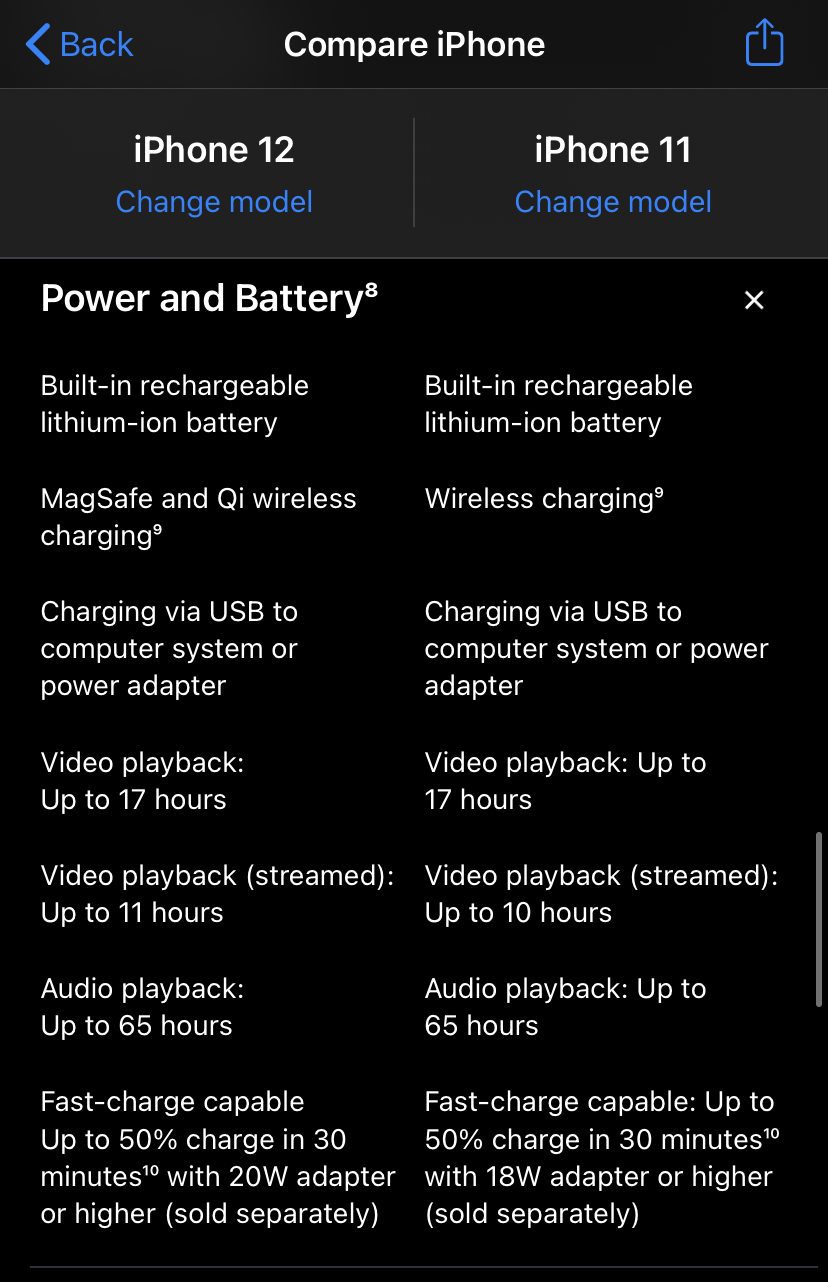

In the specs of the iPhone 12, it says “fast charge to 50% with a 20W or higher” yet says “..an 18W or higher” for the 11.
So I also know the MagSafe charger states 20W as well but will this also work with 18W charger?
It’s a little confusing to say 20W only now, I know Apple has stopped selling the 18W now, but I still have the 18W.
Do I really have to buy the 20W charger now as well?
Thanks

Fast charging "up to 50% in 30 minutes" is rated for the 20W charger brick but it will definitely work with the 18W as well (albeit a little slower)
The MagSafe charger only charges at 15W regardless so the 18W or 20W would both be more than enough.

Thanks. So that is poor info from Apple really. That screenshot shows a difference, why can’t they add “...18W or higher charger “ ?
On the 11 with a 18W used to get 50% in 30mins, why can’t the 12 do that with a smaller battery?

It's probably that they've only rated/tested it for the 20W charger, 18W will still work just fine but might be slightly slower.

No.
The 18W adapter has been discontinued, and no longer offered for sale, so Apple's packaging is going to specify the new 20W adapter to be current (there's a pun in there for the initiated), and prevent confusion.
Technically, there is little difference between 18W and 20W. In the past, Apple has vacillated between bundling 10W and 12W adapters with the iPads. They juiced it up a bit from 10W to 12W with the iPad 4 and Air 1, but actually went back to bundling the 10W with the Air 1 before it was discontinued, then going back to 12W again. For all intents and purposes, they were treated as interchangable equivalents.
It should also be noted that these are all nominal figures. None of them are going to produce 20.0W or 18.0W exactly, for various reasons, including what the power company is supplying to the house, and how it is distributed throughout it.
So "20W" really only means it will be around 20W; it could be more, it could be less, depending on the supply, and the load being drawn (particularly for multi-port adapters). So that 2W theoretical difference is going to be further diluted by variances in actual output.
As practical matter, there is unlikely to prevent the use of the 18W adapter with the MagSafe; it will still work, but perhaps just a little slower. So, unless you're the kind to sit there with a timer, any difference will be not be noticeable anyway.
