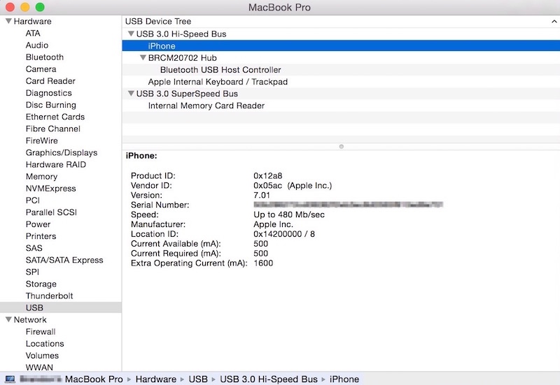

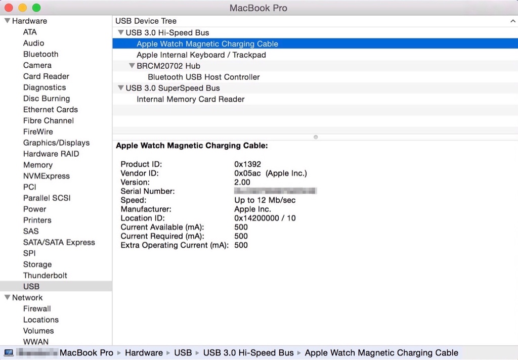

Charging on my 2013 13" rMBP
iPhone 6 Plus
