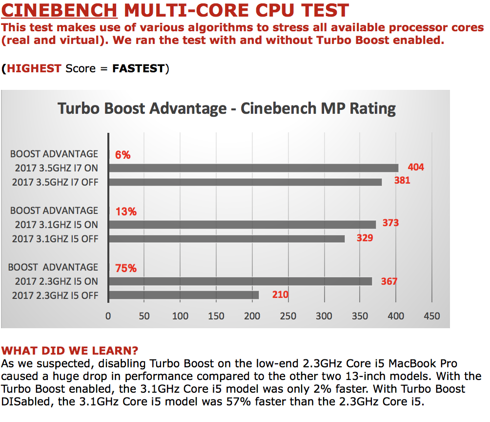

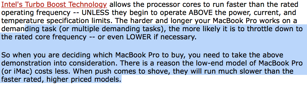

So compare -
1) 2018 Mac mini 3.0 base block i5, with turbo boost to 4.1
2) 2017 iMac 3.8 base clock i5 with turbo boost to 4.2
Both have almost the same SINGLE CORE Geekbench score, and I assume that's because in the time it takes to run the Geekbench tests, both machines can remain running at full turbo boost.
However, lets say I've got a video render or export that takes 30+ minutes ... would the iMac then come out ahead since neither machine could maintain turbo boost that long, and the iMac actually has a higher base clock speed?
According to the expert at Bare Feats, a lower base clock with a high turbo boost will eventually lag behind, but he doesn't actually test it.
So ... does anyone know where there are extrended stress tests to determine what, if any, disadvantage there is to having a lower base clock, but a super high turbo boost speed? Thanks!

The answer is: It depends. IMO Geekbench is a lousy measure of a computers performance for anything other than running Geekbench. Specifically for the reason you state: It doesn't sufficiently stress the system and therefore its scores don't represent what one would see with real world applications that do. I have a 2010 Mac Pro and a 2012 rMBP and transcoding on the Mac Pro is considerably faster than the rMBP despite the latters higher GB score.
It's my educated guess, and that's all this is since I have no real world experiences with either of these systems, is the iMac will outperform the Mini under such tasks which force the processor to operate near its base frequency (which is 26% faster on the iMac, but take a little off for IPC improvements in the Mini processor). What tasks would those be? Anything which causes the processor to operate near full utilization. Doing so increases heat which will have to be offset reduced clock speed.
I've engaged in a number of discussions with new Mini owners attempting to get some Handbrake benchmark data to see what frequency the Mini tends to operate at under full CPU utilization. Unfortunately there's just not enough data to draw any conclusions. What I have seen is the Mini, even when utilizing all cores for lengthy periods of times, operates a little bit above the base frequency.
Short answer : yes.
Long answer: yes, but Mac Mini is relatively cool and can maintain higher turbo for a significant amount of time compared to i.e. MacBook Pro i9.
Thats why desktops are usually better, because they have better cooling and higher base frequencies and can maintain higher CPU speed for longer.
I see iMac and Mac Mini as a “cross” between mobile and desktop and performance reflects that.
imac pro, mac pro have higher sustained values, because of better cooling and workstation chips.

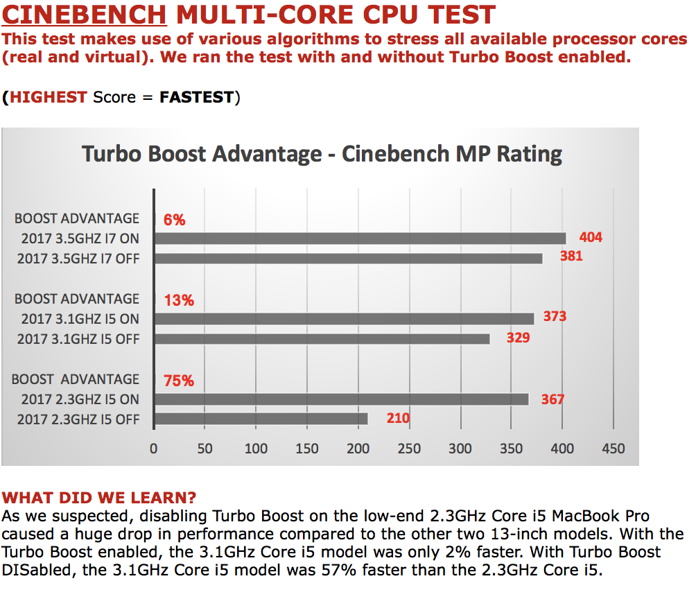

So compare -
Turbo boost doesn't meant sustained max ghz. It's a metric most useful in single threaded tasks. The cpu is limited by both thermal throttles, as well as power consumption. If the CPU is using all it's cores, it won't be running at max ghz on every core (and it wasn't designed to).
Your mileage will vary on each cpu, but typically turbo boost CPUs under load will hover only slightly above base clock with laptop configs, moderately above base clock on apple desktop configs (this includes the 2018 mac mini, but not earlier), or halfway+ between turbo/base on a super cooled PC.
