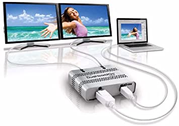

Matrox dualhead...used to use these over ten years ago...
Yep, these will work just fine but present the two/three monitors connected to them as one ultrawide monitor, so it's best to have the monitors positioned right next to each other.
