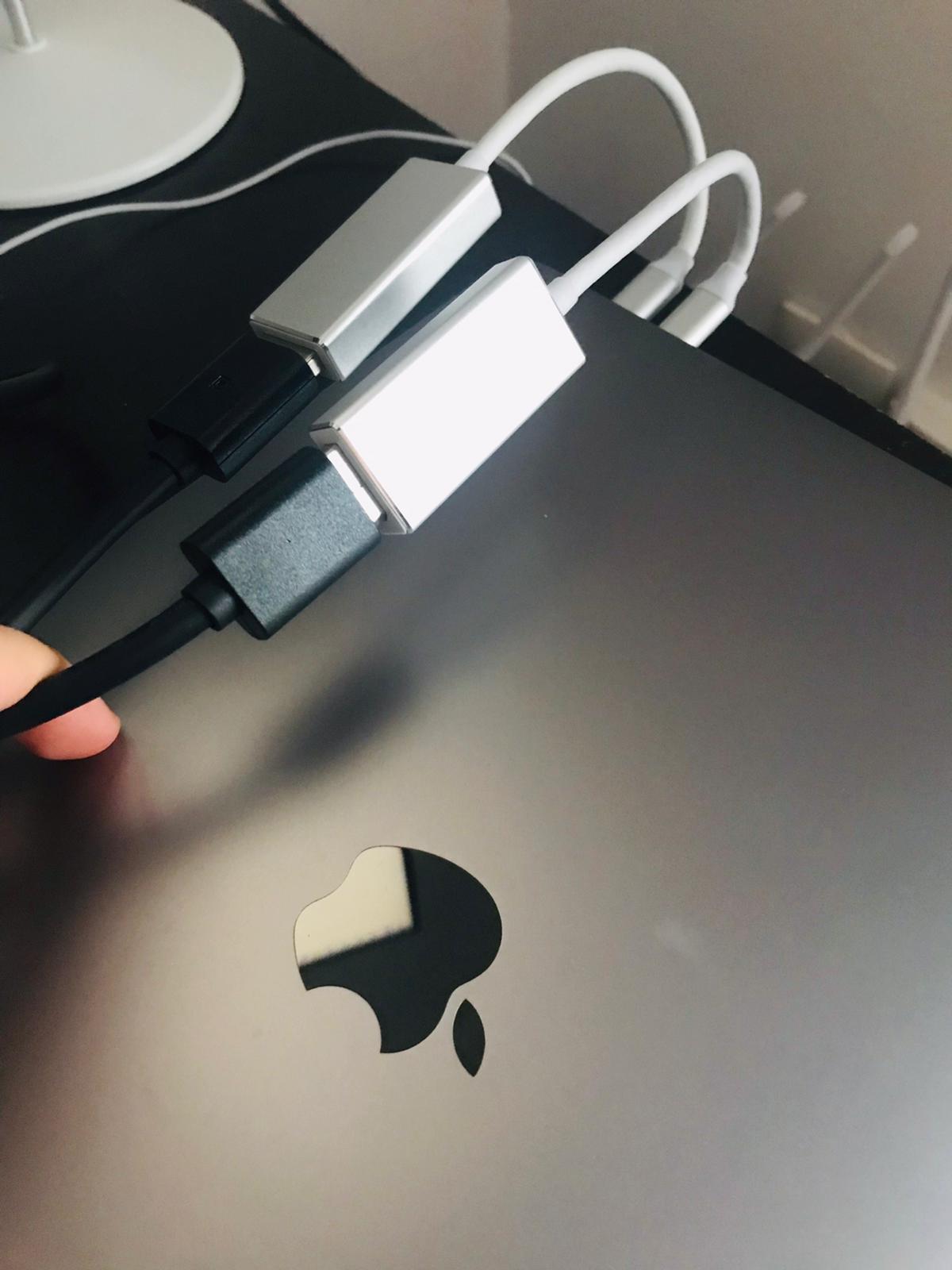

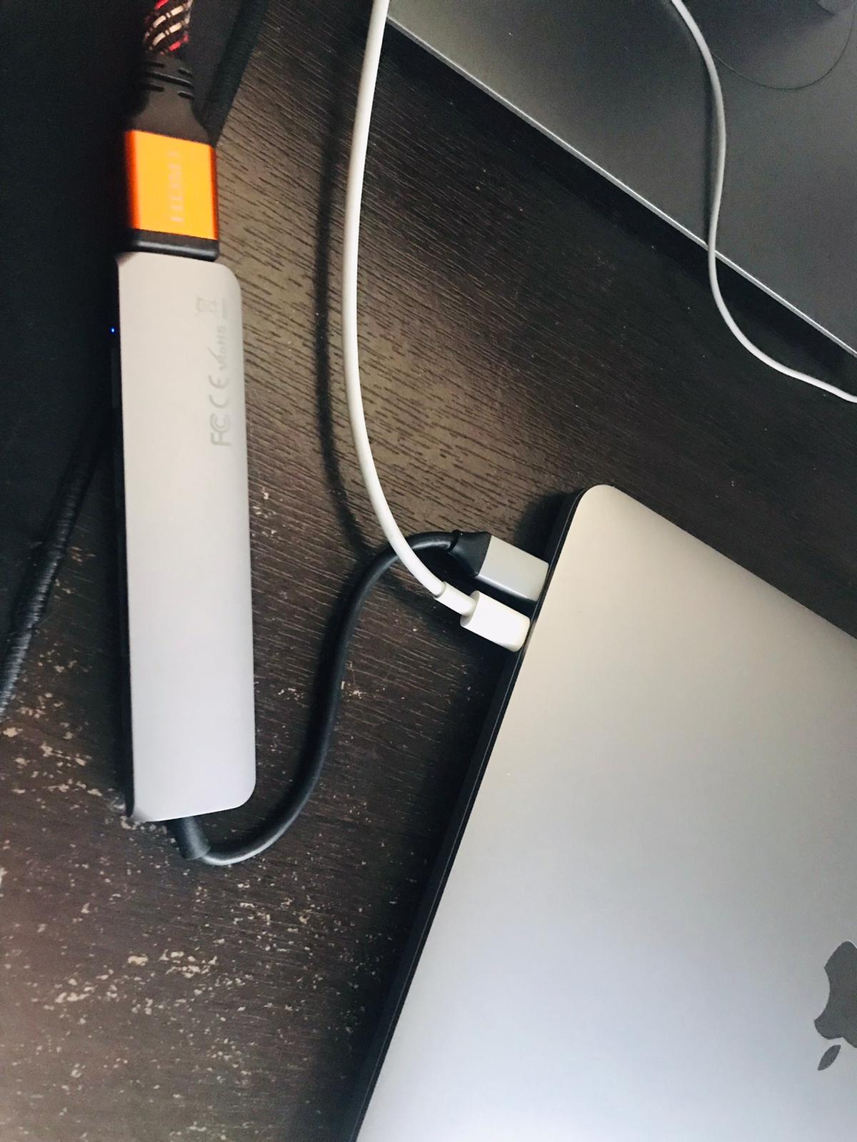

Hello,
I have a MacBook Pro 13", 2020.
I read this thread and I understood that with:
- 2x DisplayPort -> USB-C
- 1x HDMI -> USB-C
I would be able to connect three monitors Full HD (1920 x 1080).
But I'm having trouble 🙁
I've attached two pictures of the connections I have (first one 2 DisplayPort, second one 1 HDMI via Satechi)
am I missing something?
Thanks!
