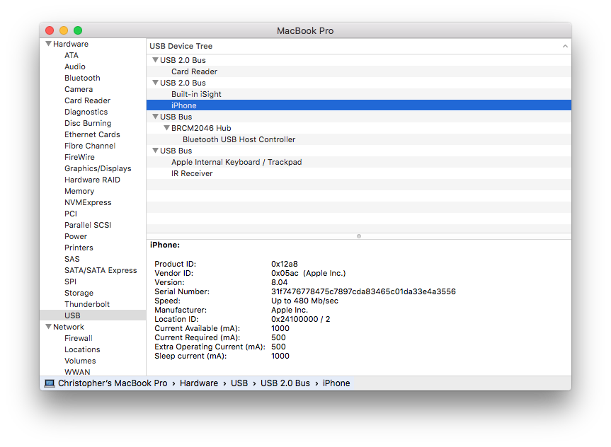

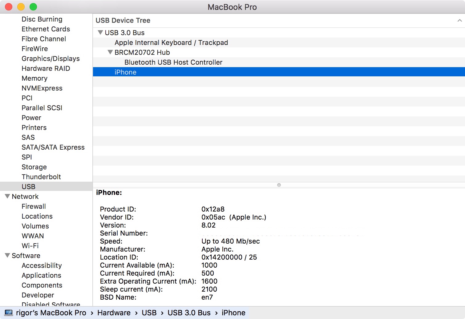

The iPhone 4S charges at 1500mA, which is equal to 1.5 A, or 165W.
The iPhone 6 charges at 2600mA, which is equal to 2.6 A, or 286W.
According to System Information, the iPhone SE charges at the same rate as the 4S.

Thanks for the info.
when looking at system info, i think but i am not sure, that it is
Current required + Extra, so its 1000 ma
