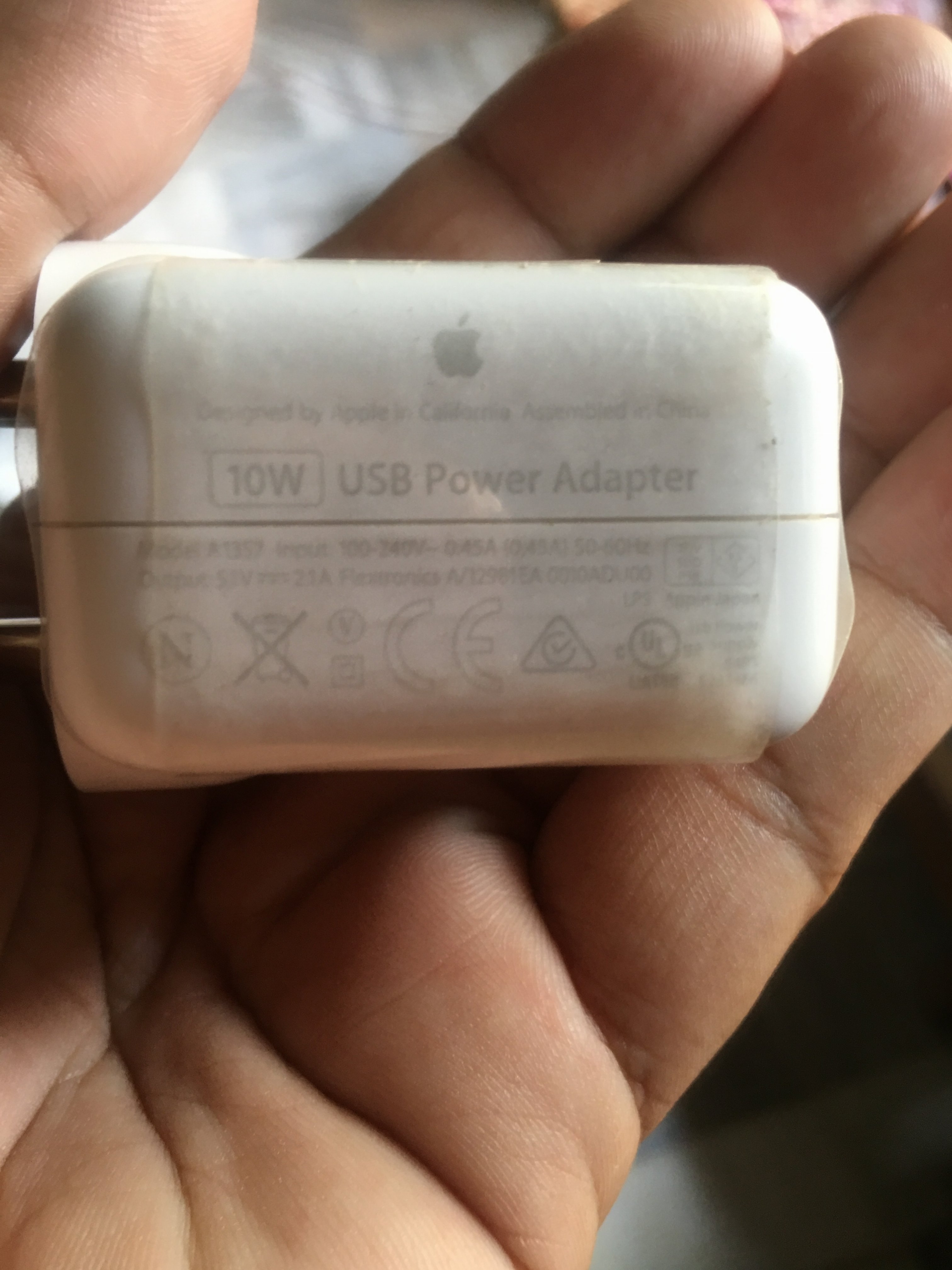

I use a 10w charger for my iPhone 6s plus and it takes 2 Hours 45 minutes to charge from zero to 100%
Reactions: IronH4WK
