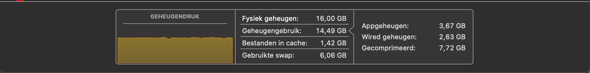

I have been using an M2 -> 16GB / 512GB ssd for a few days now and notice while using Lightroom that quite a bit of memory is used.
The Swap here is currently +6GB?!
On my old iMac 5K (late 2015) with 512GB SSD and 24GB memory. I never had any issues with swaps, does this mean I'm running out of memory?
If I want to replace this M2 for an upgrade, is increasing the memory to 24GB sufficient or should I push the setup to a higher level?
Can the experts here please give me some good advice so that I can enjoy the mac min for a few more years?

I'm not a professional.
Since my old iMac never had to use the swap memory, I notice with the M2 that a swap of +6GB is strongly used. I wonder if this has a negative effect on overall performance?
According to Apple about swap click
The 'Memory Pressure' graph shows whether your computer is using memory efficiently.
- Green memory pressure: Your computer uses all the RAM in an efficient way.
- Yellow memory pressure: Your computer may eventually need more RAM.
- Red memory pressure: Your computer needs more RAM.
With my swap I am therefore in the yellow area.
No it just means your Mac is memory managing, like it's designed to.
Good advice: Stop looking at these figures. Close Activity Monitor. Just use your computer. If it truly runs out of memory, you'll know because a dialog box will appear and your computer will slow.

I upgraded from M1/16GB mini to M2 pro 32GB, memory pressure/swap stays about the same in Lightroom (+/- 50% yellow maybe a little less swap a few GB), so it seems more memory available = more used. Feels about the same speedwise. Panotest with 33 18Mpix raws went from 1 minute to 45 seconds. So it is faster but in practice doesn’t feel much different.
Yes, it has, if you use a benchmark side to side and compare, but if you don't experience lack of performance, then it isn't important. The SSD may be somewhat degraded with time, but it will most likely last longer than the computer itself is relevant for daily use.

Yeah, that's...not great, not terrible. If this is the heaviest workload that you usually have, you will be fine for some time I guess. You are not running out of memory, but you do not have too much to spare either. It should be ok.
If I understand your post correctly, upgrading the memory to eg 24GB will not make sense for Lightroom, especially since swap will still happen.
Strange that my old iMac 5K late 2015 with 24GB memory never showed any swap?
How can I prevent that there is less swap with a better performance as a result?

Are you actually suffering from a degradation in performance?
Since I upgraded from an iMac late 2015 to an M2, I unfortunately have no reference how the performance of an M2 without swap compares.
I would think it a shame not to use the full performance of the system.
It'd also be a shame to unnecessarily spend hundreds of dollars to chase graphs in Activity Monitor rather than because your system is actually suffering from reduced performance during your workflow.
That you can't tell if performance is affected really tells you everything you need to know. It's obvious when a computer is being pushed beyond it's limits. If you can't confidently detect any degradation in performance, you don't have any.

You are all good! Just use your computer and ignore the arcane details of Activity Monitor. I ran the crap out of an 8GB 13" M1 MBP on Capture One Pro with a ton of other stuff running in the background (including Windows 11).
In the time I had that 8GB M1 MBP, my memory pressure was lava red the entire time and it was still working mostly without any incident. Of the few performance issues I had, they were primarily software related ones that hardware upgrades would address only marginally.
Granted, Capture One Pro and Lightroom aren't the same program, but they're pretty equivalent and I'd expect that Adobe would be able to design better software than Phase One (maker of Capture One Pro).
Yes, as per apple's support documents, you are running out of memory. However, if you don't do this often, it won't be an issue. I had a friend who was constantly overloading their RAM and while the computer itself ran OK even in the red, the SSD took a massive beating from all the swap usage and health dropped to 10% or so in just 2 years. Even then, it won't be an issue if a few years is all you're expecting out of the machine and SSDs can continue to work even at 0% health.

On the basis of this Youtube it has become clear to me that more ram memory does not result in a higher performance gain.
Basically, this means that I will adjust my current setup to the following configuration.
Processor: M2
Memory: 16GB
SSD: 512GB upgrade to 1TB for higher performance in swap and longevity.

Yes and no. You don’t want to wait for the “You’ve run out of app memory” pop up to appear.
Knowing when you’re near that is a good way to know you need to start closing tabs or other applications. When we start seeing something’s not quite right and feel degradation creeping in, it almost always is already too late.
Using swap is the OS’s way of a fail safe to prevent us from getting that out of app memory while we close other things. We shouldn’t rely on it on a regular basis.
You said you upgraded from a 2015 iMac … any chance you're still running the Intel/x86 version of Lightroom as opposed to the native version? Check in Activity Monitor, the CPU page, the "kind" column, and make sure Lightroom is listed as Apple, not Intel.
I just discovered I'm still running the Intel version of Webex despite the Apple Silicon native version having come out almost a year ago. Plus a few other Intel lurkers...
