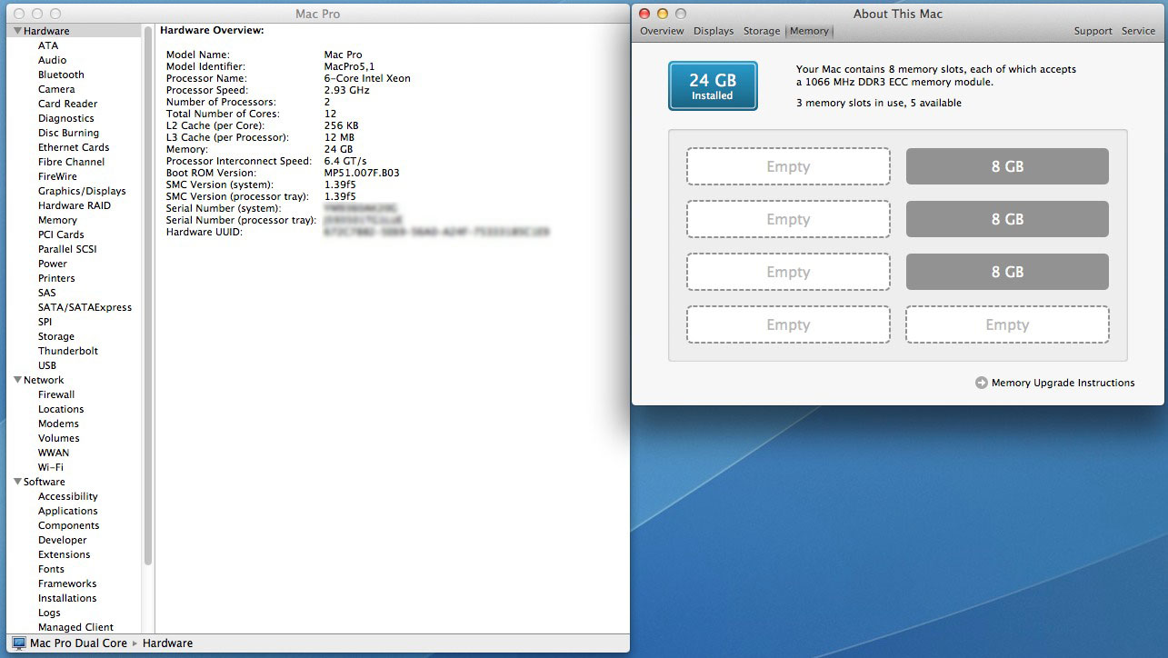

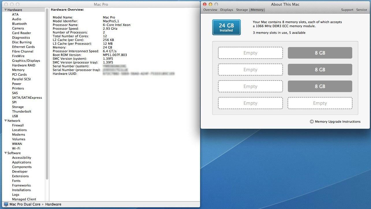

I upgraded the processors in my 2009 Mac Pro 4,1 - ( 2 x Four Core 2.26 ) to ( 2 x Six Core 2.93 ) Xeon X5670 processors and then flashed to to 5,1 firmware version to make it a 2010 model. I then recently purchased 3 - 8 GB DR3 -1333MHz memory modules from Ramjet, since their memory is supposed to be the most Mac friendly of all the vendors. Unfortunately, after installing the memory modules, the system profiler is still only showing the memory speed at 1066MHz.
I have a support request into Ramjet and hope to hear back from them shortly. However, I'm guessing either their memory was mislabeled, or there is some other issue with the system not recognizing the new memory modules to run at their full speed potential, even with the new firmware and 2 new 6 core processors.
I'll follow up after some more research.
